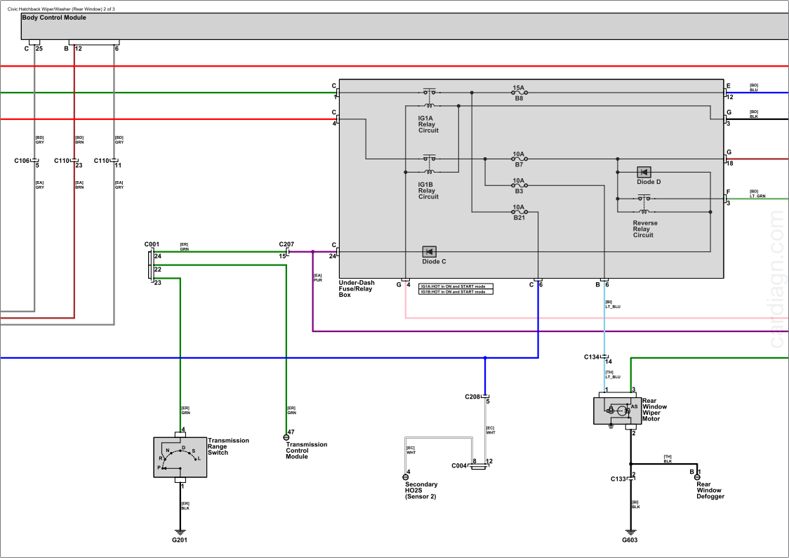

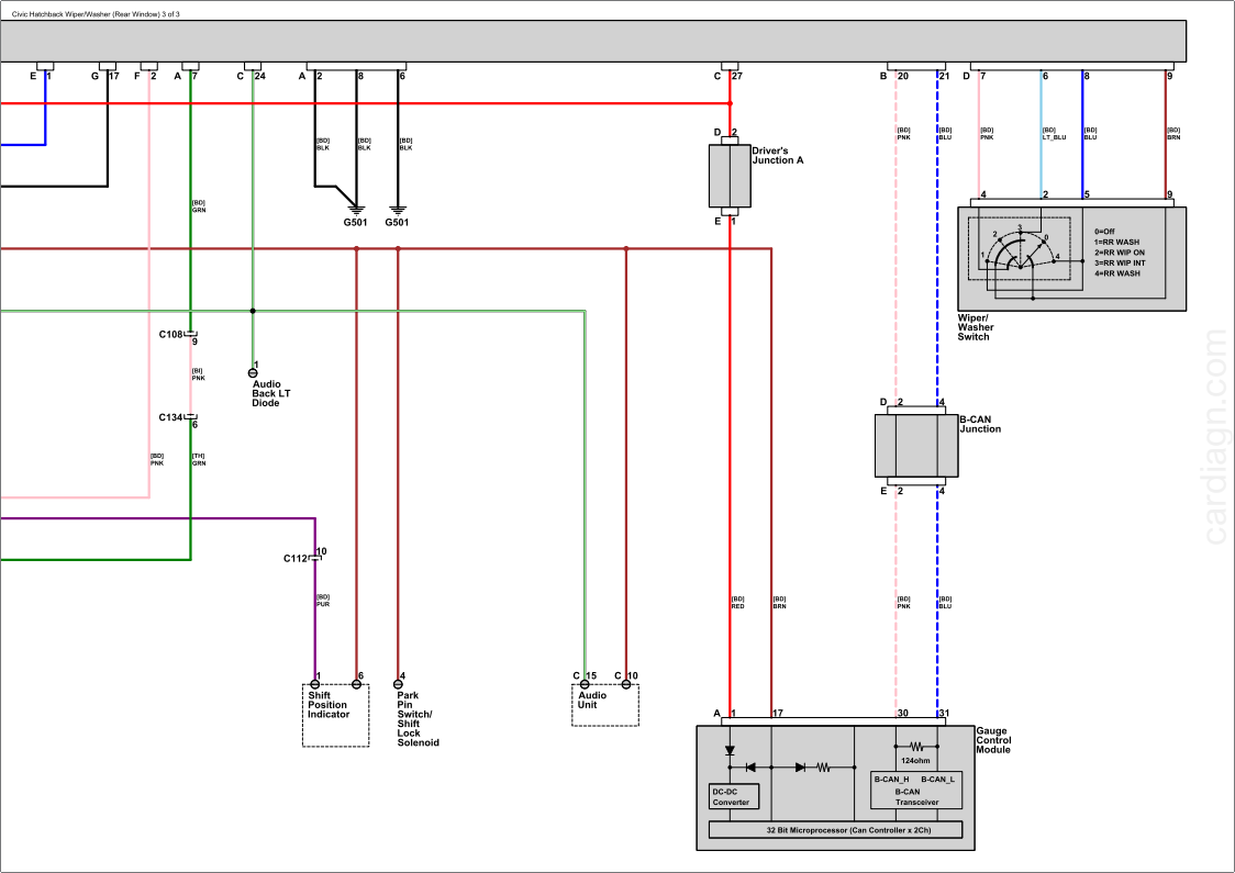

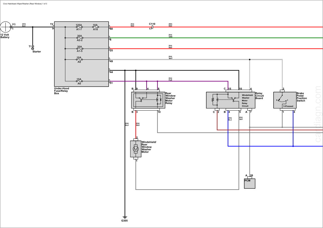

Here are the wiring diagrams that have the rear wiper control in them. Hope it helps.
Check this thread out, too. I uploaded a link to the service manual there. Should be of some use if you're a DIYer
https://www.civicforums.com/forums/2...c-manuals.html
That's where I pulled the wiring diagrams from (69. Electrical Diagrams > Pages 168-170)
