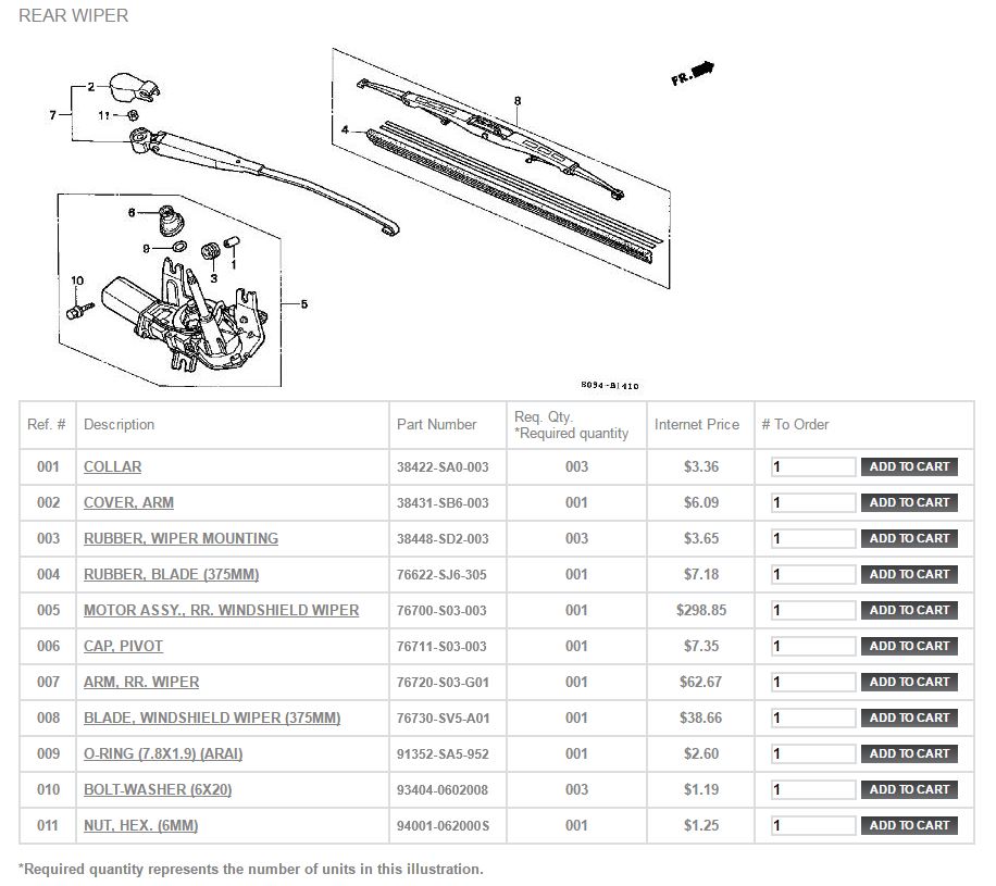

this is from a Canadian oem Honda parts supplier

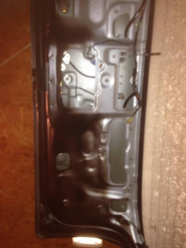

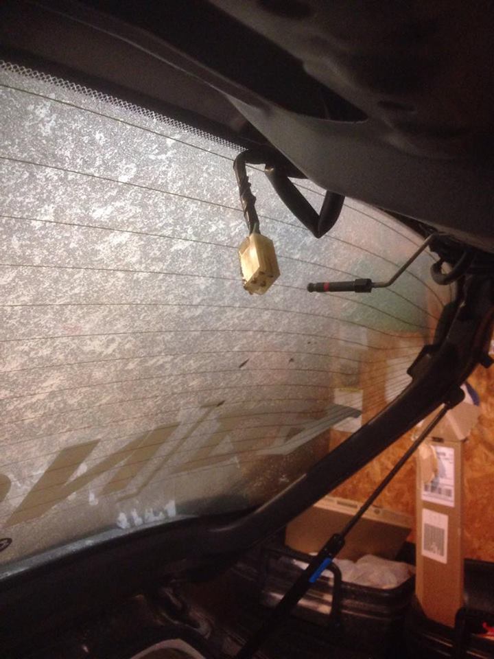

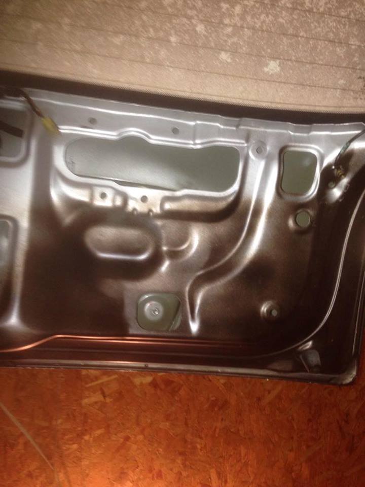

okay am i thinking this through right? here is where i figure the motor goes
(see image "car3") there is a connector right there already for what i assume is the wiring from stock (see "car2connect") then i took a closer picture ("Car1") there are what i see three holes at an slight outward angle. assuming outward is to the back. all the motors i saw and the one pictured above looks like its at a way steeper angle then this but maybe i'm wrong? thanks for your help. im tired of not seeing out the back in the rain or snow.
if someone could show me how it goes in there and what it should look like that would be great thanks!

looks like it goes there, you're going to have to be very careful when you drill your hole though. It's been like 3 years since I've ripped one of those apart. Is there any junkyards near you where you can get parts and maybe take some measurements so you know where to drill?
