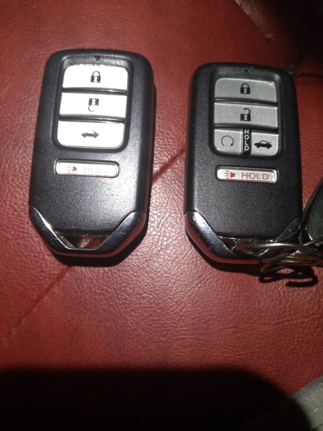

My 2018 Si got totaled last fall (thanks, 16 year old driver who hit me from behind). I still have the spare key fob for it. I have since replaced the car with a 2021 Civic Sport that only came with one key fob.
Do the two fobs interchange? Is there a way to reprogram the elder key fob to work on the 2021, other than paying a locksmith a tidy sum, or springing for a key code device of my own?
I tried a couple of YouTube videos which claimed to work, but they did not work for me. I replaced batteries in both fobs to make sure that wasn't the reason. The 2021 fob has a button for remote start, which my new Civic doesn't have.
Photo: 2018 fob is at left.

I checked with a locksmith and he said, Honda changed the radio frequency the key fobs uses in 2019, so my 2018 fob can't be used on my 2021 Civic...but also he said he could get me one that will work.
I guess the dealership is my next stop.

radio frequency different... that's basically a no. Did not know that, good info

Dealership confirmed, the fobs have different part numbers and DO NOT interchange. For a fob that will work on my 2021 Civic, and programming it, it would cost about $250. Dammit.

The manufacturer part number for the 2018 fob is, A2C92005000.
The manufacturer part number for the 2021 fob is, A2C92005700.
To see which part number your OEM key fob is, remove the emergency key, gently crack open the fob using a coin, and inside you will find (in a tiny font) Continental then the part number. There will also be an FCC ID number but on the 2018 fob and the 2021 fob, the FCC ID number on the fob is the same.
I found and bought a used OEM fob with the right part number for $19. I am going to try reprogramming it using the YouTube video I mentioned before. I think it will work this time.
