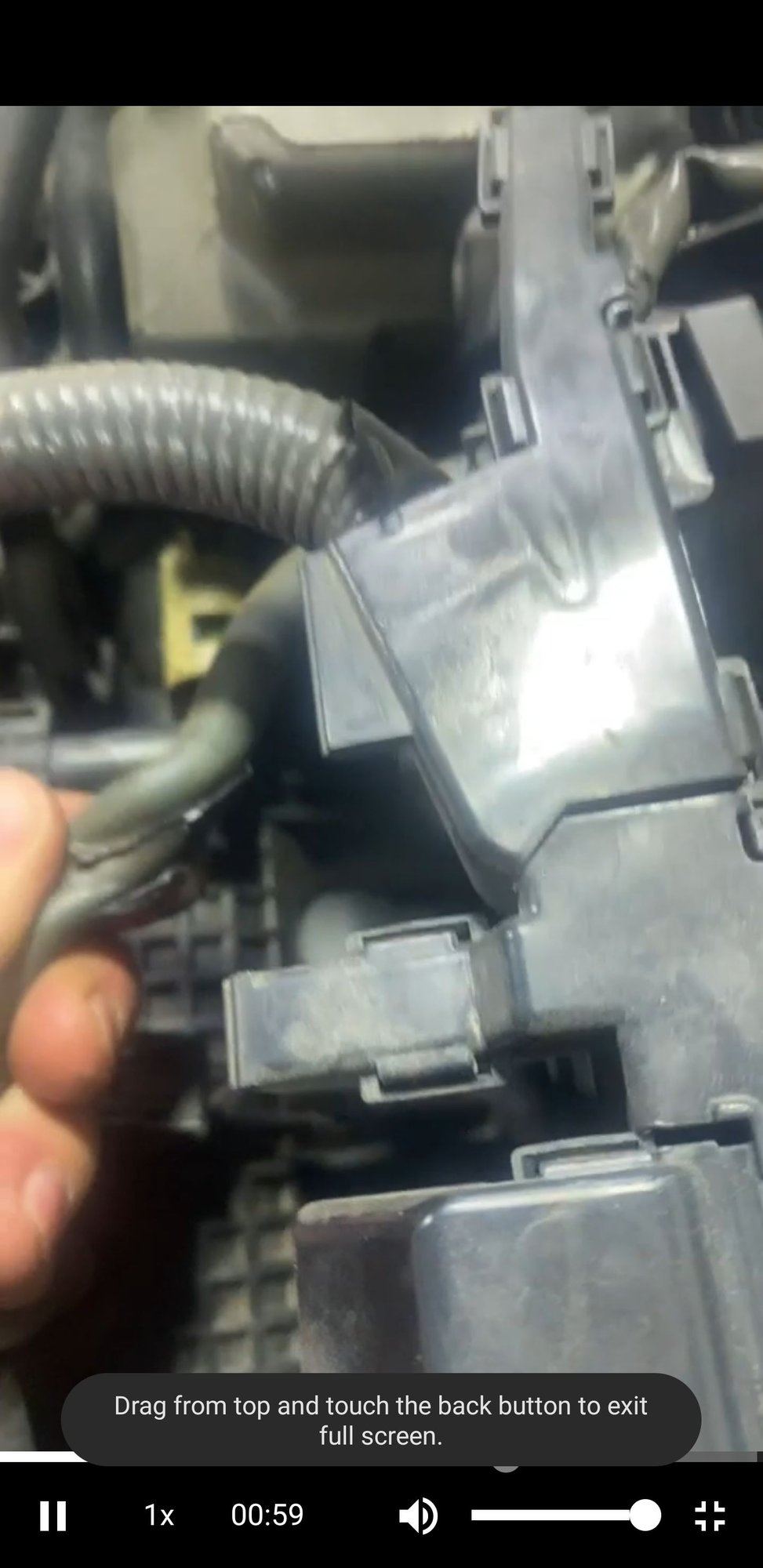

I know this is an old thread, but figured I'd share recent experience in case it can help anyone. Had "Emission System Problem" light come on last month and stick around for a few days and then disappear. About 2 weeks later it came back. I was due for an oil change and had one scheduled, but of course it went away a few days before that appointment. Honda had much easier things they could do to empty my wallet, so the guy told me to just watch for the light. Of course it returned the very next morning, so I called and got another appointment. In the meantime I got a free scan at a parts store and it said change air filter. I replaced engine and cabin filters, despite having changed them 2 months prior and still looking clean. Another scan said possibly MAF sensor, so I bought spray and cleaned it. Light remained lit after several drives and my appointment arrived. $200 later, I found out a hose at the back of the engine is splitting in several spots. New one on order and hoping to never see that light again. *fingers crossed* So yeah? If anyone still has issues or has one in the future, check air hoses for any tears.
These are taken from a video, so sorry for the bad quality and poor centering.

No idea what hose that is but it could certainly cause evap issues
