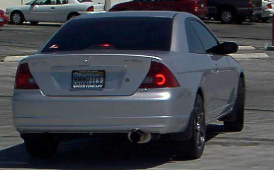

I have had my LX a year now and the best milage I have ever been able to pull out of it was on a road trip to the grand canyon.... 35mpg hgw ... so I have to ask you. Do you drive like my grand father or what ?
LOL! Yeah, maybe I do drive like your grandfather. I do have an auto LX, and I rarely stand on the accelerator from a light. I figure what's the point of showing people just how slow my car is. As for the highway, it's a pretty flat road, not many hills, so it doesn't drop into a lower gear much, and I was doing 120km/h with cruise control on. I filled up, and drove 382 km, and still had about 1/2 a tank left in the car.
