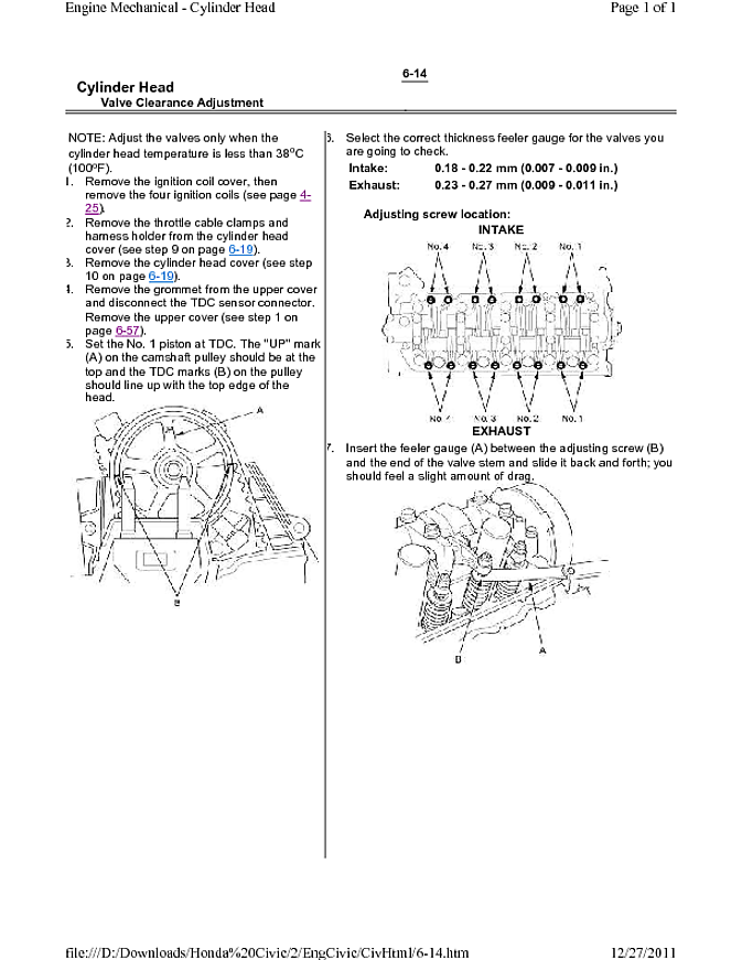

.005 and .008 is too tight, just fyi.
Make sure you check them after you tighten the locking nut to 14 lb-ft.

http://www.hondasuv.com/members/showthread.php?t=37551
JR, I based the clearance on the above thread, not sure if civics and CR-V'S differ much
