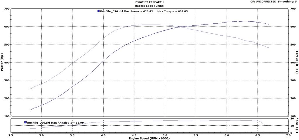

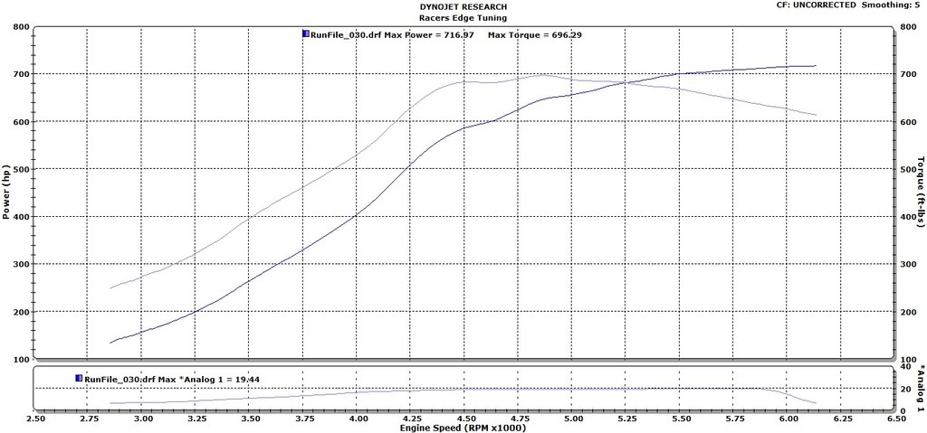

So RET tuned the car today! One hiccup, we ran out of pump on the race gas tuned sadly....I have dual walbros with the return system...so looks like I'm gonna grab another pump and get a triple fuel hat within the next month or so, just so we can check out the peak numbers it will make.
Pump gas at 17lbs and 13* timing the car made 628whp/609wtq
Race gas at only 19lbs and 15* timing it made 716whp/696wtq
So as you can see if I was able to throw 24lbs of boost at it like we wanted to it would easily make over 800whp!
Oh well though....we will see what happens when I get the new pump and hat!
Also....one issue that is robbing me of more power is the fact that my DR's aren't getting traction on the dyno very well...as you can see in the picture down below. The boost was coming on so fast and so hard that multiple times it would just spin on the dyno...so the pump and race numbers would be higher. Even with two guys in the trunk the car was still spinning and shooting rubber. So once I have the new fuel hat and pump in I'm gonna throw on my other tires and have another go at it We could have gone back and had the guys sit in the trunk for a re-do of the pump gas tune...but we were over it....I'm happy with the numbers haha.
Here's the graphs:
Pump

Race

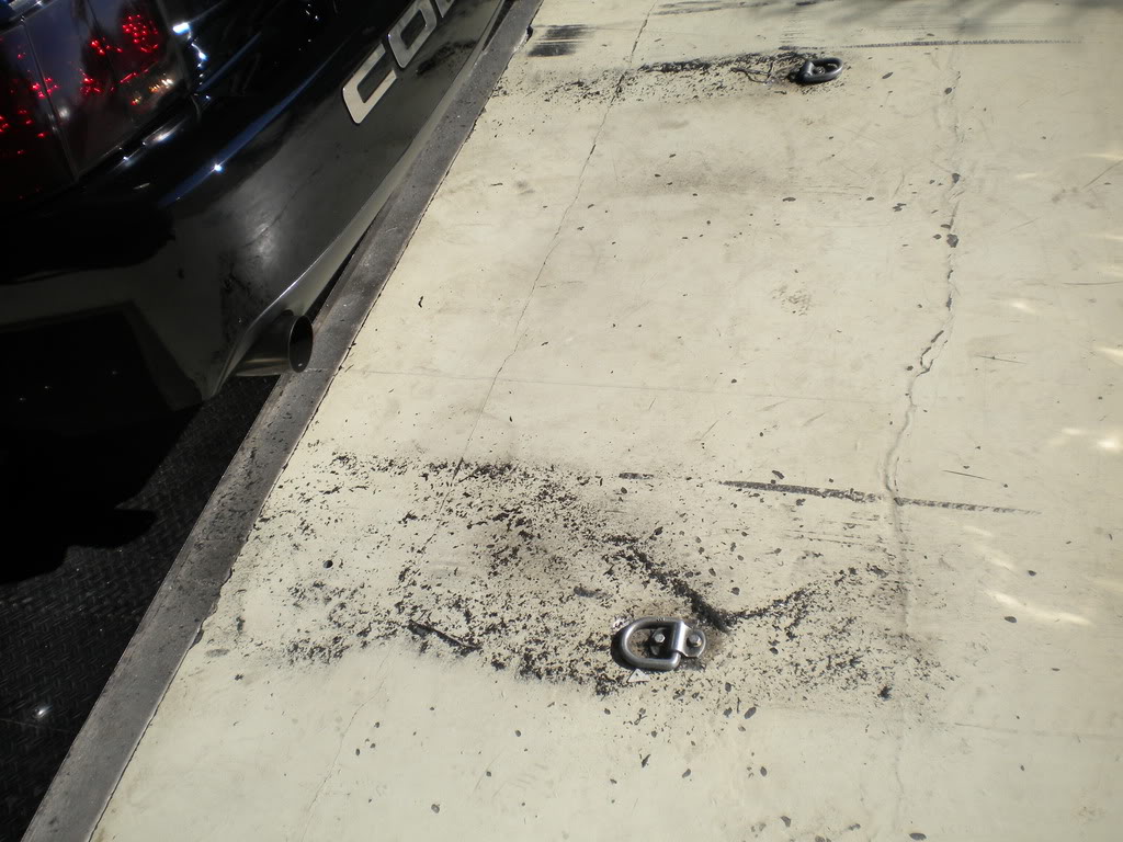

Race gas tune (gotta love needing guys on the back just to keep it from spinning :banana: )
YouTube - 2003 Twin Turbo Cobra Dyno 19lbs.
And a picture of the aftermath from the tires:

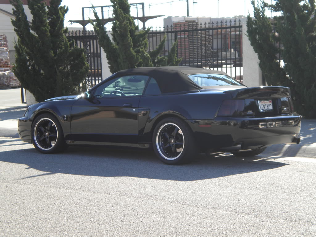

And one of the car sitting outside the shop....the stance if perfect to me Alsooooo...in about 2 weeks some True Forged wheels will be going on :dancenana:

Very very nice
A little sloppy on the shifting, but i guess it was hard to hold the camera and drive same time
