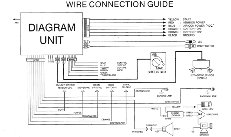

i dun see it in the Vehicle Wiring Database in here..
acturlly.. i gotta find out those wire:
START
IGNITON POWER
AIR CON POWER (ACC)
IGNITION "ON"
IGNITION "ON"
GROUND --- <Black>
OIL LIGHT OR HIGH TENSION COIL
STOPBRAKE
DOOR SWITCH (-) --- <White/Green>
DOOR SWITCH (+) --- <White/Blue>
TRUNK RELEASE
PARKING LAMP
ENGINE LOCKING --- <Ignition Harness>
LOCK KEY --- <Ignition Harness>
STARTER --- <Ignition Harness>

I don't think we have one. The trunks on most Honda's are not electric. It's a cable that runs from the release handle to the latch on the trunk.
EDIT: I'm assuming this is for a trunk popper switch on a remote? You have to install a new solenoid for that.

ummm. Our trunk isnt electric dude. When you pull the trunk release it's really just pulling up a cable that yanks the trunk latch so it opens. Some of the accords have electric trunk releases, but not civics. On a side note, when I read the title to this thread, I pictured someone trapped in their trunk on a lap top trying to find their way out.

if you're trying to wire it to your alarm, you'll have to get a remote opener from an Accord.

i put a DEI solenoid in my car for that. kinda pointless cuz the solenoid is so heavy, it hardly cracks it open. but im thinking it'll work better with trunk springs.

the ICE FORUM ON THIS SITE and all you need for the trunk pop is ONE wire that goes from your alarm to the trunk and a relay.

on the wiring dargram below, what is TRUNK/HATCH PIN?
Item Wire Color Polar. Wire Location
12V white + ignition harness
STARTER black/white + ignition harness
IGNITION black/yellow + ignition harness
ACCESSORY black/red + ignition harness
SECOND ACCESSORY none
TACHOMETER blue test connector *4
POWER LOCK white/blue - gray plug above drivers kick
POWER UNLOCK white/green - gray plug above drivers kick
PARKING LIGHTS + red/black back of the fusebox
PARKING LIGHTS - blue factory alarm plug *1
DOOR TRIGGER *2 - factory alarm plug *1
HEADLIGHTS blue/red - headlight switch
TRUNK/HATCH PIN red - factory alarm plug *1
HOOD PIN none
TRUNK/HATCH RELEASE none
FACTORY ALARM ARM none
FACTORY ALARM DISARM none
HORN TRIGGER orange - steering column
BRAKE WIRE white/black + brake pedal switch
LOCK MOTOR yellow/black back of the fusebox *3
UNLOCK MOTOR yellow/green back of the fusebox *3
DISARM DEFEAT yellow back of the fusebox *3
DISARM NO UNLOCK none
DOME SUPERVISION comes on with unlock
SPEED SENSE white/green PCM *5
SUN ROOF OPEN/CLOSE none
SUN ROOF LIMIT none
RADIO 12V white/red + radio
RADIO GROUND black - radio
RADIO SWITCH yellow/red + radio
RADIO ILLUMINATE red/black + radio
POWER ANTENNA
Notes: NOTE: This vehicle has an immobilizer system that needs to be bypassed when adding remote start. *1 The factory alarm plug is a green plug above the drivers kick panel. *2 The drivers door trigger is green, front passenger door trigger is lt. green/red, and the rear door trigger is green/white. *3 In the top left plug. *4 It is a 2 pin plug to the passenger side of the battery. *5 The PCM is behind the glove box. The vss is in a connector A (31 pins), pin 18. The vss is also blue/white at the cruise control module to the left of the steering column.
Old Aug 25, 2003
skipbarber's Avatar
Posts: 4,248
From: Rockville, Maryland
Rep Power: 333
its the wire that senses when the trunk is open. in other words, its a sensor, the same wire that triggers your trunk light to turn on when you open your trunk. when you tap into this wire with a door trigger wire, if someone opens your trunk, it sets off the alarm. get over it, we dont have trunk release!
