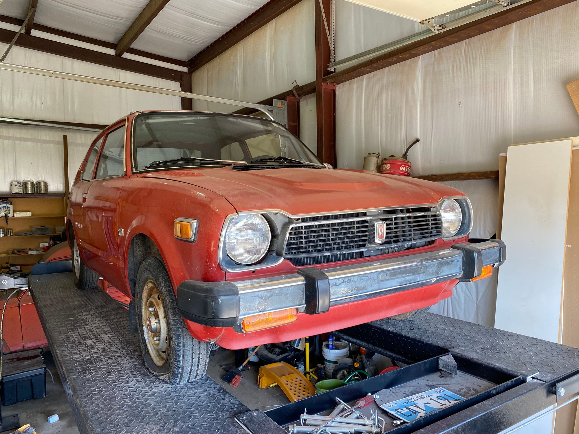

Hello guys!
im looking at buying a 1978 Honda Civic 1200 in clean original condition with 80,000 miles on it. Needs a general refurbish, but runs great and everything works. Still has original books and sales paperwork.
I understand these have a timing belt and possibly an interference engine?
should the timing belt and tensioner be changed right away? And how big of a job is it? How often should it be changed in these engines?
Any help or info on these cars is greatly appreciated!
thank you!
