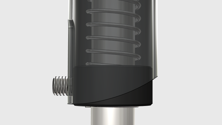

Fab of the sleeve
  1. Take your tube and cut it down to 60-70mm length. If you aim for the 70mm length, you run the risk of the bottom of the tube catching the forward part of the shifter assembly, but literally nothing filing on the backside (forward end with reference to the car) can't fix. It'll kinda prevent you from shifting into park.
  2. Insert the Raceseng adapter into the tube to make sure it fits. Pray it's kinda snug. Remove the adapter and place alongside the tube. Line the top of the tube higher than the bottom set of set screw holes and mark the centerline of the set screw holes. You're going to be drilling holes there (if you hadn't figured that out yet), so make sure you have clearance above the hole you're about to drill so you're not ripping the edge of the tube. I set these adapter mounting holes approximately 6mm down from the edge of the tube. Take that one point and make another mark 180° from this hole. Basically marking the other endpoint of the diameter of the tube, 6mm (or so) down.
  3. On the opposite end of the tube, make a similar marking. Again, I used 6mm from this mark to the end of the tube. Make another mark 0.7"/17.8mm above that. this mark doesn't have to be super accurate.
  4. Now, the marks from step 2, you're going to be drilling straight through both walls of the tube with a 1/4" drill bit. The drill bit going through should be riding an imaginary diameter line perpendicular to the tube. These two holes should line up with the lower 2 setscrew holes on the **** adapter. This side will be referred to as the top of the tube
  5. Drill out the 2 marks from step 3 with a 1/4" drill bit. You're gonna end up "milling" the space between the drilled holes to create an oval channel. The elongated set screw from the shaft collar will be sliding up and down in this channel, so make sure it allows that to happen. If you make the channel too wide, you'll end up with excess rotational play in the completed assembly. Try and keep this channel as tight as possible with respect to the set screw OD, but still allowing it to move within that channel. What this accomplishes is limiting up and down movement of the assembly. Upward movement limitation -- the bottom of the channel -- is more important than downward, since that's what's gonna prevent your shift **** from launching into space.
