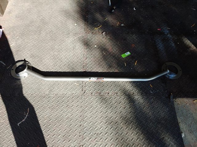

  1. Meet your bar. Here, we have the DC Sports CSB3352. Make sure you have everything included in the box. In this case, it was the bar itself, a length of split wire loom, and 6 nuts.

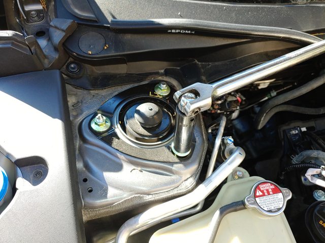

  2. Pop your hood. Duh. Take that 14mm socket and take off the nuts holding the strut on. Work with one strut at a time, by the way. Put the nuts aside for safe keeping.

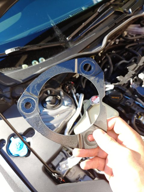

  3. Your car may or may not have this thing
  4. Take it and put it somewhere safe.

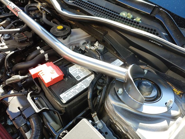

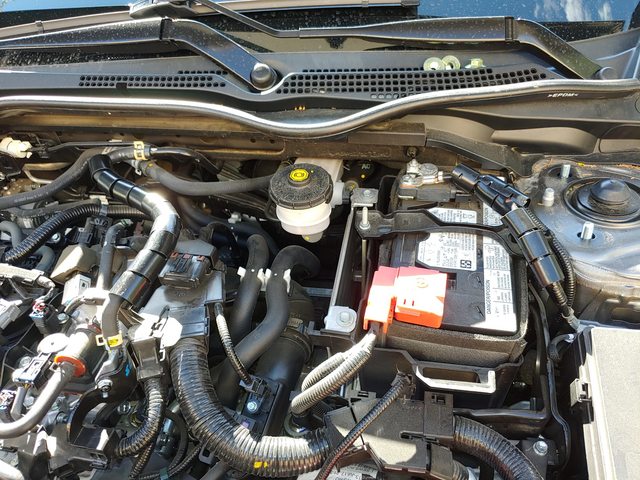

  6. Take this time to dry fit your strut bar. Jack up one side of your car if necessary for the strut bar to fall into place. Find out where the bar hits hoses or wires. In my case, it was battery negative wires
    and this.. vacuum hose (?).. thing.

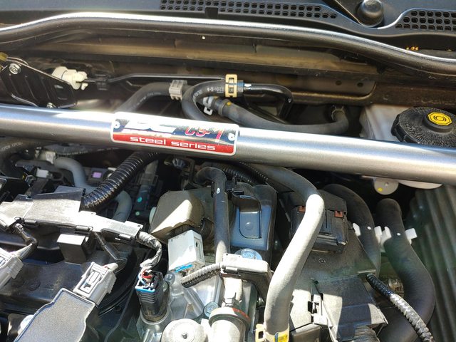

  7. Measure and cut the split wire look as you see fit. Remove the bar and wrap the wire loom around the vacuum tube (idk what it is at the moment, so I'm just gonna go with that) fuel purge line and negative battery wires. It's not pretty, but it's functional. Go ahead and drop the bar back onto the strut studs.

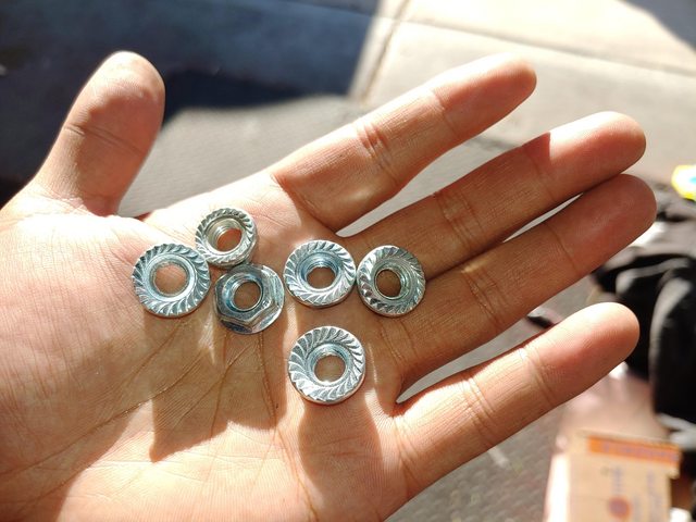

  8. Now, grab those 6 nuts the bar came with. If it's anything like mine, scratch your head and wonder where they go, since they were clearly too small to fit on the strut stud threads. Toss them in your spare fasteners drawer.

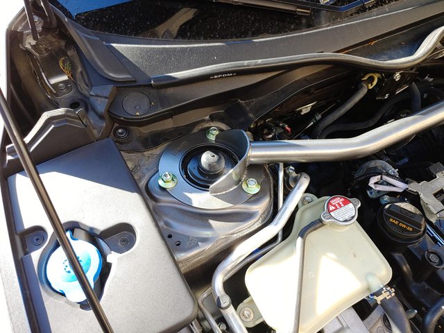

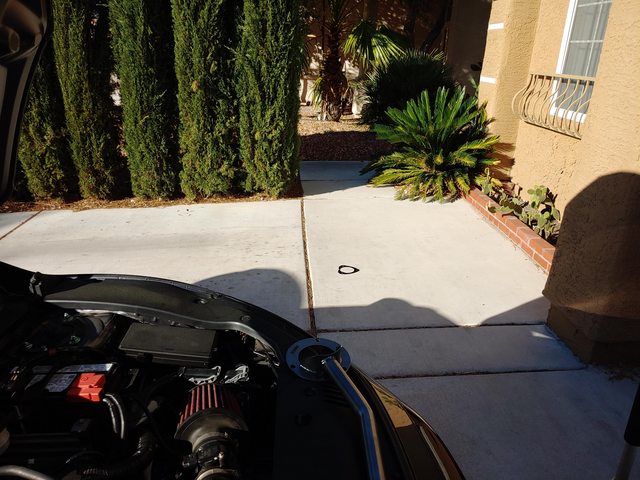

  11. Stand back and enjoy the fruits of your labor
