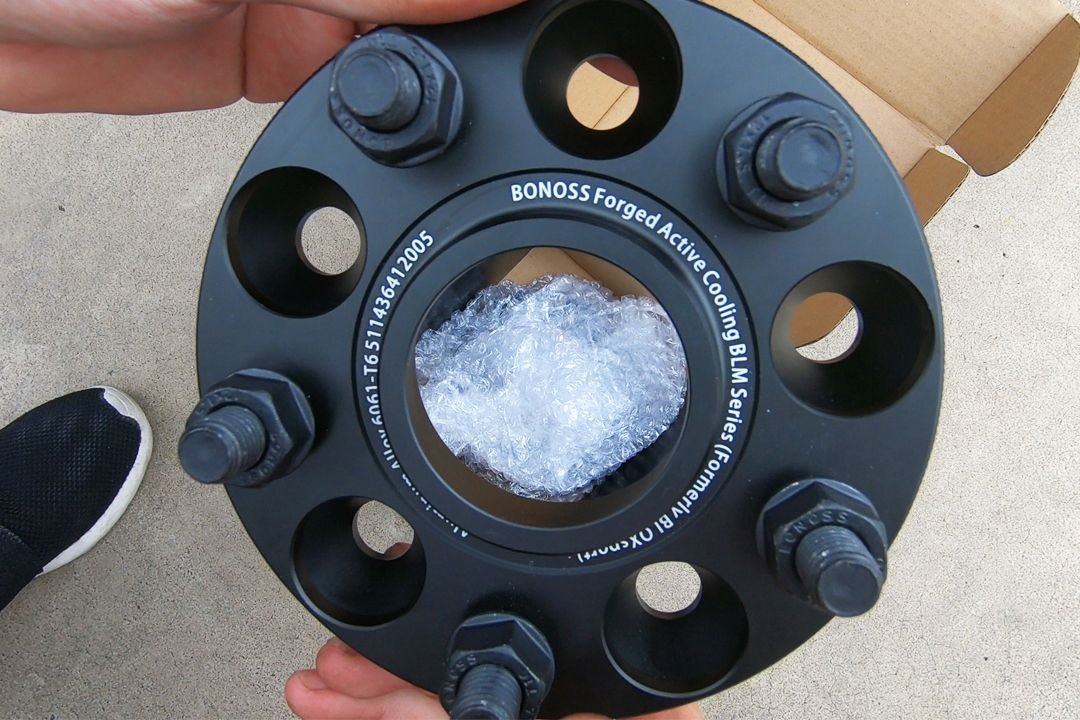

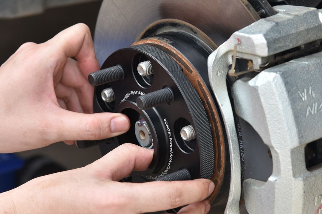

Today I would like to share something about installing 15mm+20mm BONOSS Forged Active Cooling Wheel Spacers for my Honda Civic 10th Gen(FC) with you.
My Honda Civic 10th Gen(FC):
Chassis model: X (FC)
PCD: 5*114.3 mm
CB: 64.1 mm
Thread: M12*1.5 mm
I got them on eBay, took me several days to receive them. I can't wait to install them on my vehicle.

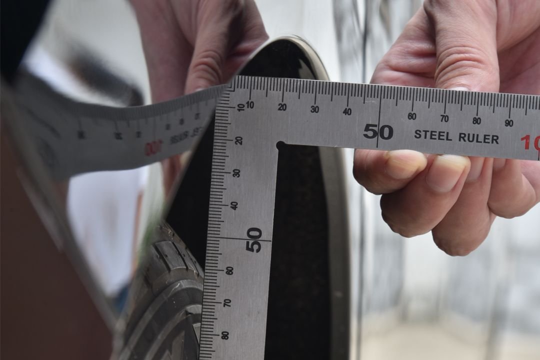

But before you choose the right spacers, you need to measure the thickness data that fit the wheels:

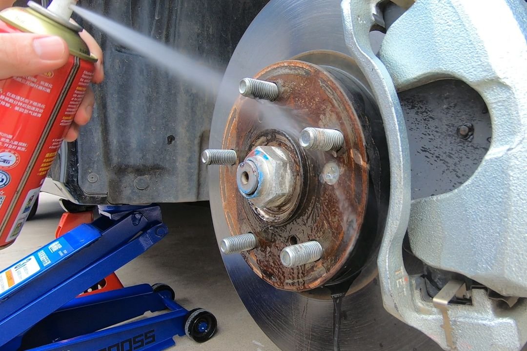

Cleaning the wheel hub:

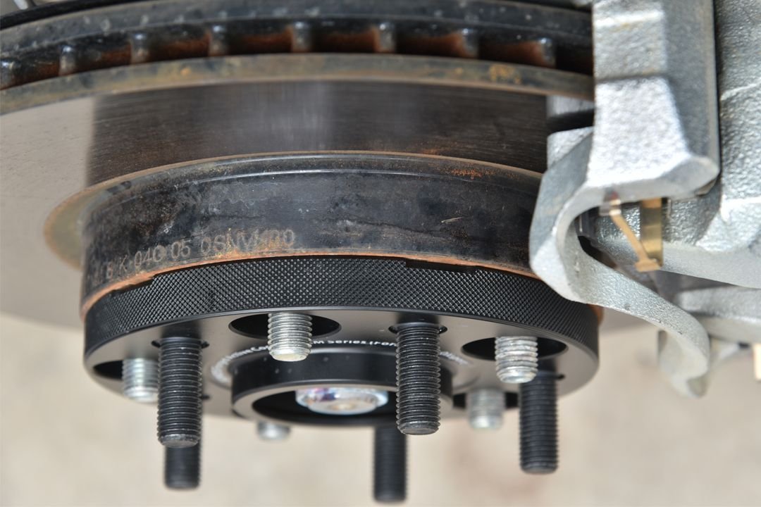

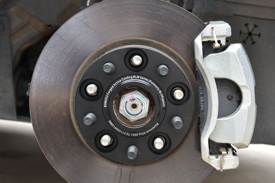

Much better after cleaning. Now let's get to the installation part:
Since I get the right data, I can install them easily!
Let's take a look:
Fit perfectly, right?
As you guys can see, compared with the original car, it has been greatly improved in appearance and stability.
Thanks for reading!

The "active cooling" part is probably bogus but they look good and hopefully they're made well

Anyway, they fit perfectly and perform well. I like them!
