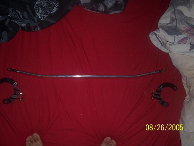

ok here are the pics. the 2 little silver screws are in the end of it. it came disaseembled. so like i said. sorry for the apc part. what can i do? anyways, one of those silver screws goes in clockwise and the other counterclockwise. and then the left and right attachment that goes on the sruts. ok so i know how the attachment is going to take place and where. i think my clutch cylinder was a little in the way so im going to have to adjust it. if i unscrew the 3 bolts won't the whole setup under the car just collapse??? sorry if im asking a dumb q.
any ways here is the pic.
sorry for the hairy feet. i needed an eagle eye shot. and why does it matter if a strut bar is 3 point or one? and do you really think this thing will break under tension?

The difference between 3 peice and one peice. Is basically the rigidity it gives to the car. The 3 peice allows the bar to flex alot more, thus not doing its job too well. THe one peice is much better at providing all it can.
THe difference between your bar, also the one peice bar, which are two point mounting bars, when compared to the 3 point mounting bar, is that they only mount to the struts obvously (sp?). Where as the 3 point mounting bar mounts to the fire wall as well... providing much more support to the bar, keeping it much more solid, and less flexing, thus allowing the bar to work to the full extent...

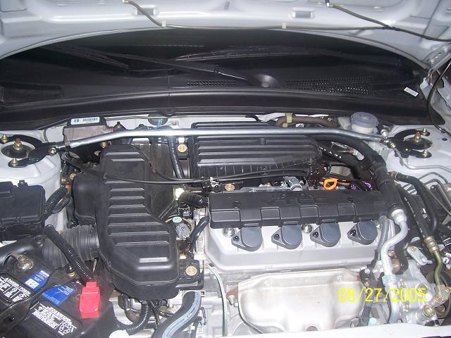

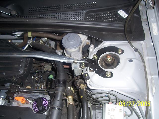

ok, here are the strut bar pics installed, the second one shows my resevior stuck between the strut bar and the brake resevior. it don't move so its ok. thanx for the help again.
this thing was rattling until i tightened the hell out of it. its tense now.
heres the resevior

I just bent my little res forward, like the neuspeed strut bar directions recommended.

Yeah that way the bar is between

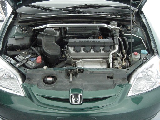

There's also another hole like 1 inch below it where you can screw the reservoir and the bar will pass over it. That way the reservoir won't contact the bar and cause unnecessary stresses to the plastic cap and will be leveled and look stock.

for the reseivior um acsually you don't have to bent it theres like a second hole litlle bit down and the same bolt will fit and you still have acsess to your reseivior...
