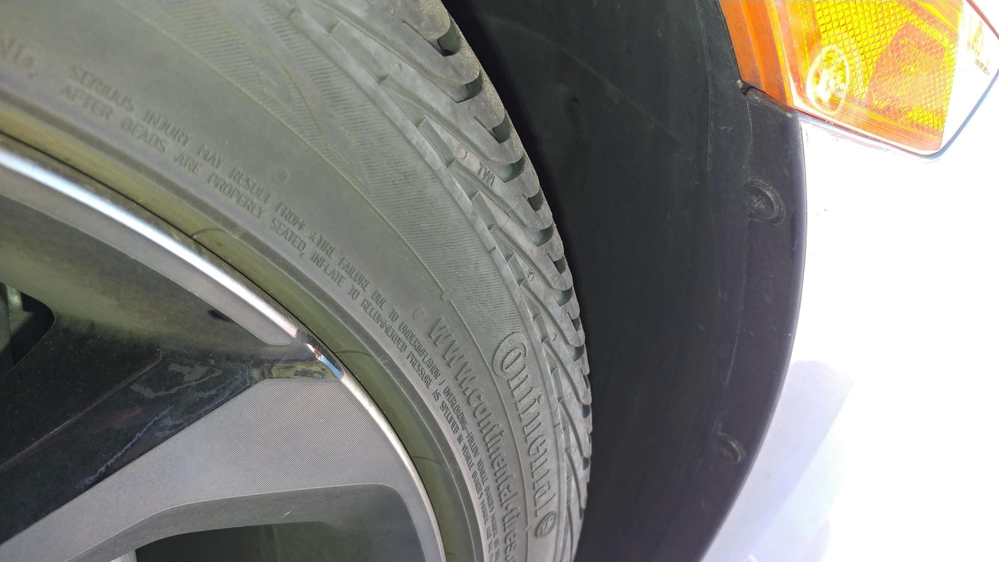

  2. Locate the two screws holding the bumper to the fenderwell lining below the sidemarker. Take those out. In hindsight, you probably only need to take out the top one, but since they're easy access and a phillips head screw, why the hell not?

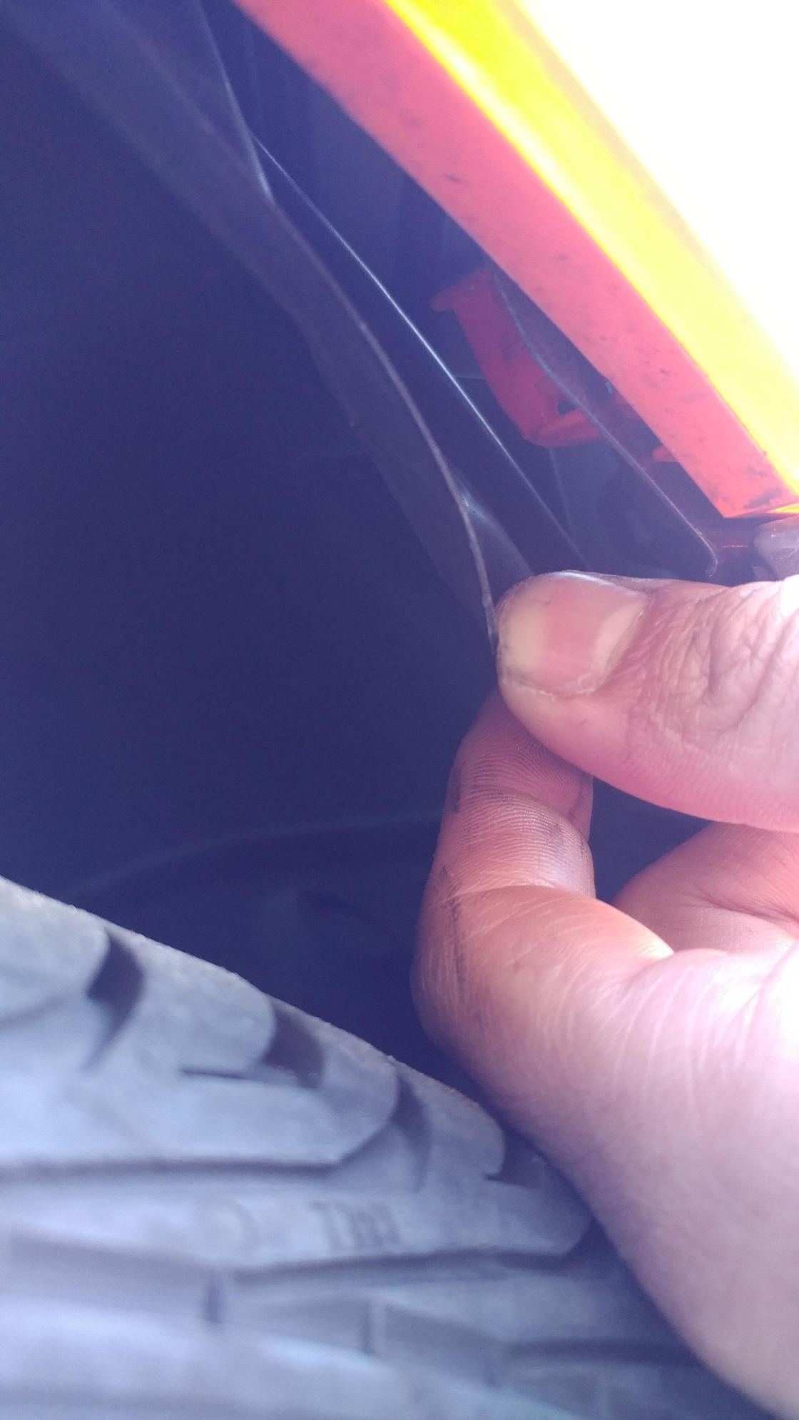

  3. Pull back the fenderwell lining adjacent to the sidemarker. You should see a little orange tab. This holds the sidemarker to the fender. Push inwards (towards the front of the car) to release the clip then push the clip through the hole in which it sits. The sidemarker should pop right out. It takes a small amount of force, but very doable by hand. Another DIY I read, the dude insisted on using a screwdriver to pop that clip. It's not that serious.

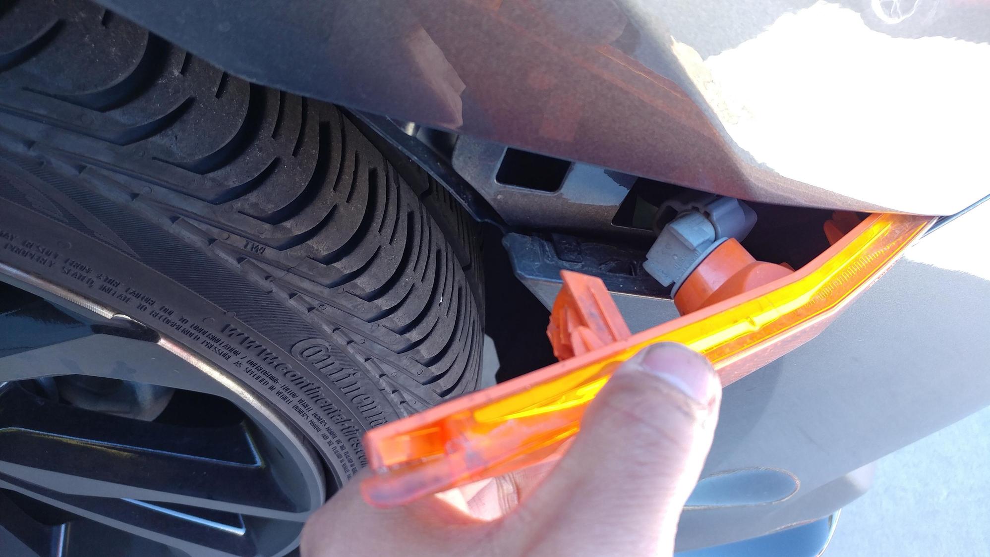

  4. Now, careful here. The harness to connect the light is very short. Pretty much just enough room to swing the sidemarker out with a quarter inch to spare. Disconnect the light by pushing the tab on the pigtail (or twist it out of socket -- that's what I did) which should let your remove the sidemarker completely. If you look at the factory sidemarker, you'll see 3 main protrusions on the backside. From left to right, here's what they are: clip that holds the sidemarker to the fender, the bulb socket, and the third that you can kinda see is a little hook, or sorts. This hooks into the fender and secures the front of the sidemarker down. The sidemarker is swinging out like this for a reason, and that's because the direction the hook faces to hold it in place.

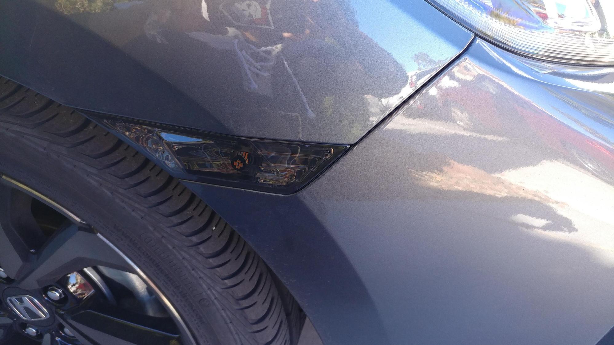

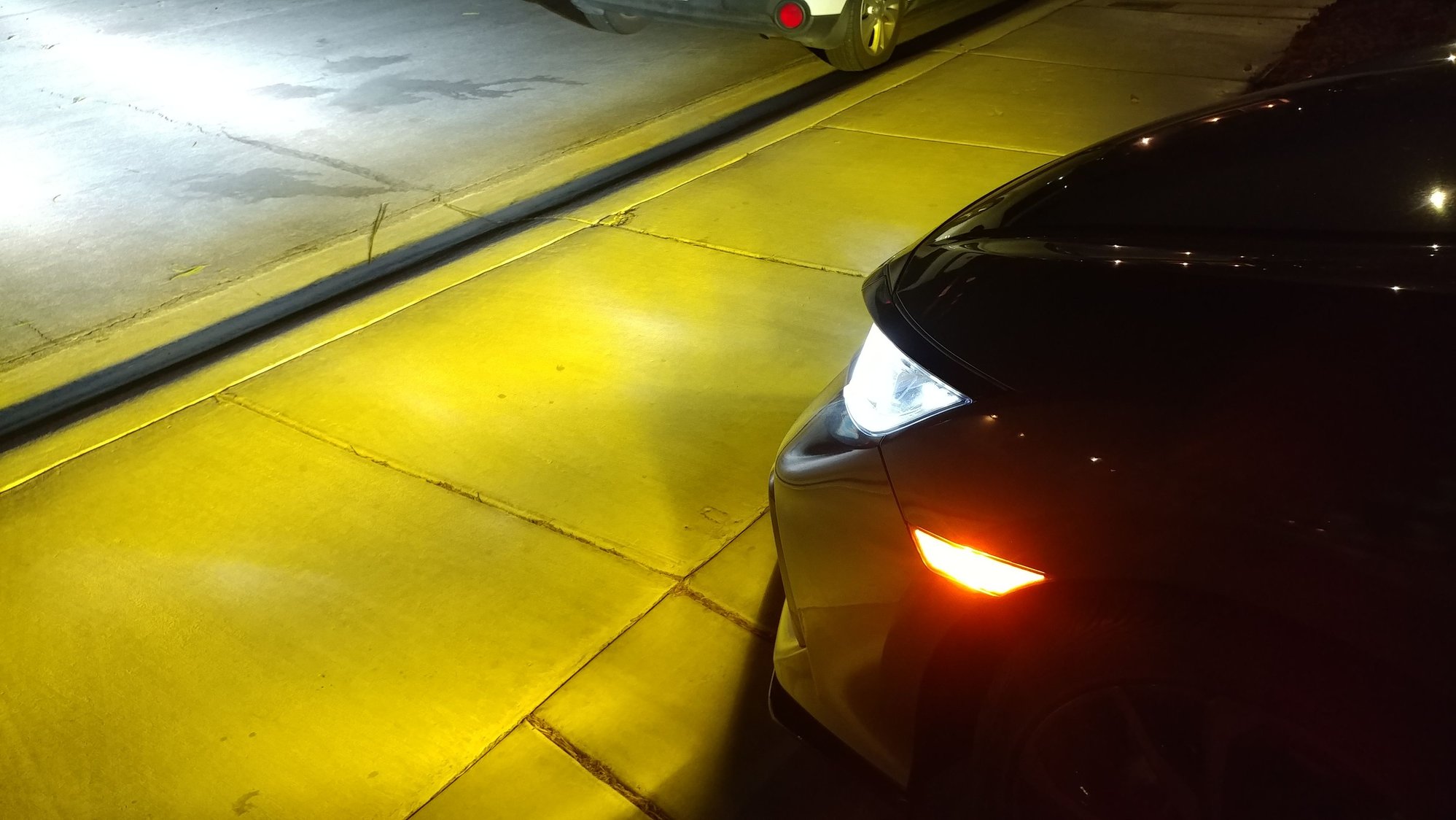

That looks better, now, doesn't it? Especially on the polished metal metallic paint, the smoked sidemarkers don't disrupt the color scheme I have going Like I said before, the amber LED bulbs are bright enough to see in the daytime (granted, in the shade, but bright enough anyways, and these things are only illuminated when my parking lights are on). My only gripe with these sidemarkers vs. the OEM ones is that diamond refractive texture on the inside of the OEM ones that these clear ones lack. It is what it is, and I didn't wanna spend more than $30 on a pair of sidemarkers, so these'll do the trick.
New sidemarkers installed, lights off
And with the lights on
Edit: bonus night time illuminated shot
