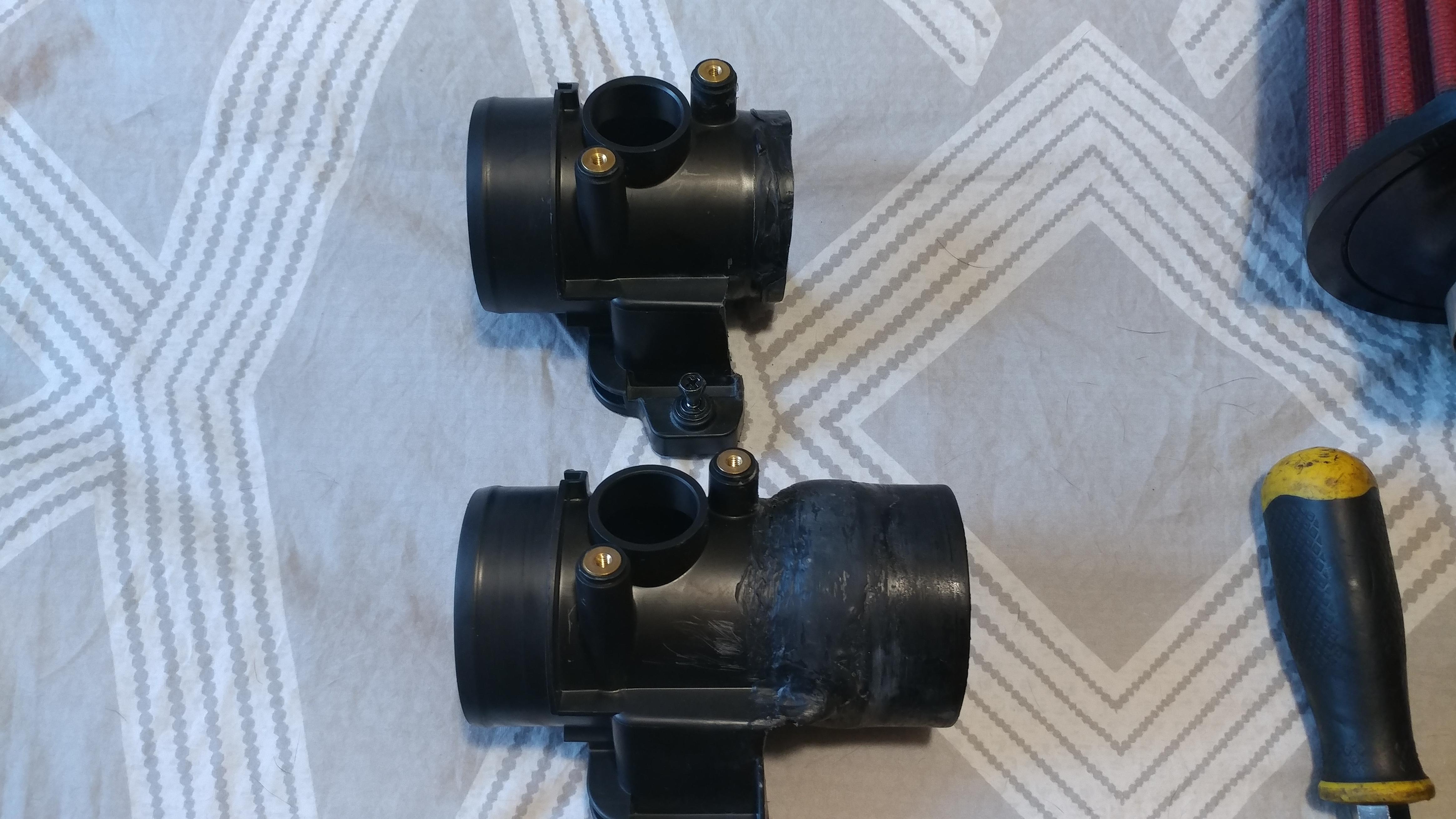

Alright, decided to change it up a bit, really because I was bored and one of my friends (he drives a 16 ex-t) showed interest in a DIY SRI. I decided to make me a new one from my original air cleaner cover, but decided a slightly different approach. For the most part, the DIY is the same, but here, I will explain the different approach I took with regards to modding the MAF housing to accept a filter.
This time, I took my time cutting it out. Didn't use a dremel this time because that melted a lot of plastic and I used a razor blade, instead. I also left a lot more of the supporting structure that connected to the mounting bolt (I still retained the single mounting bolt setup).
I also took a trip to Home Depot and purchased a 2" ABS pipe coupler for $1.08+tax. Carefully "welded" it onto the hacked up MAF housing to create a pipe extension for the filter to grab onto.
But Josh... you welded.. plastic...?
Yes, it's a thing. I, however, did not have access to a plastic welder. Instead, I used a soldering iron, melted the plastic pieces together, and it ended up making an air-tight seal around the coupler/MAF interface. A few things I learned/tested/observed, for those that decide to take this venture
So, why 2" coupler? The OD of the coupler was 2.7". I have a new filter on the way that has a flange diameter of 2.75 (AEM P/N 21-202DK). I'm not worried about being able to make up that 50 thou with clamping down on it. Also, the ID of the coupler was larger than that of the MAF housing by about 3mm.

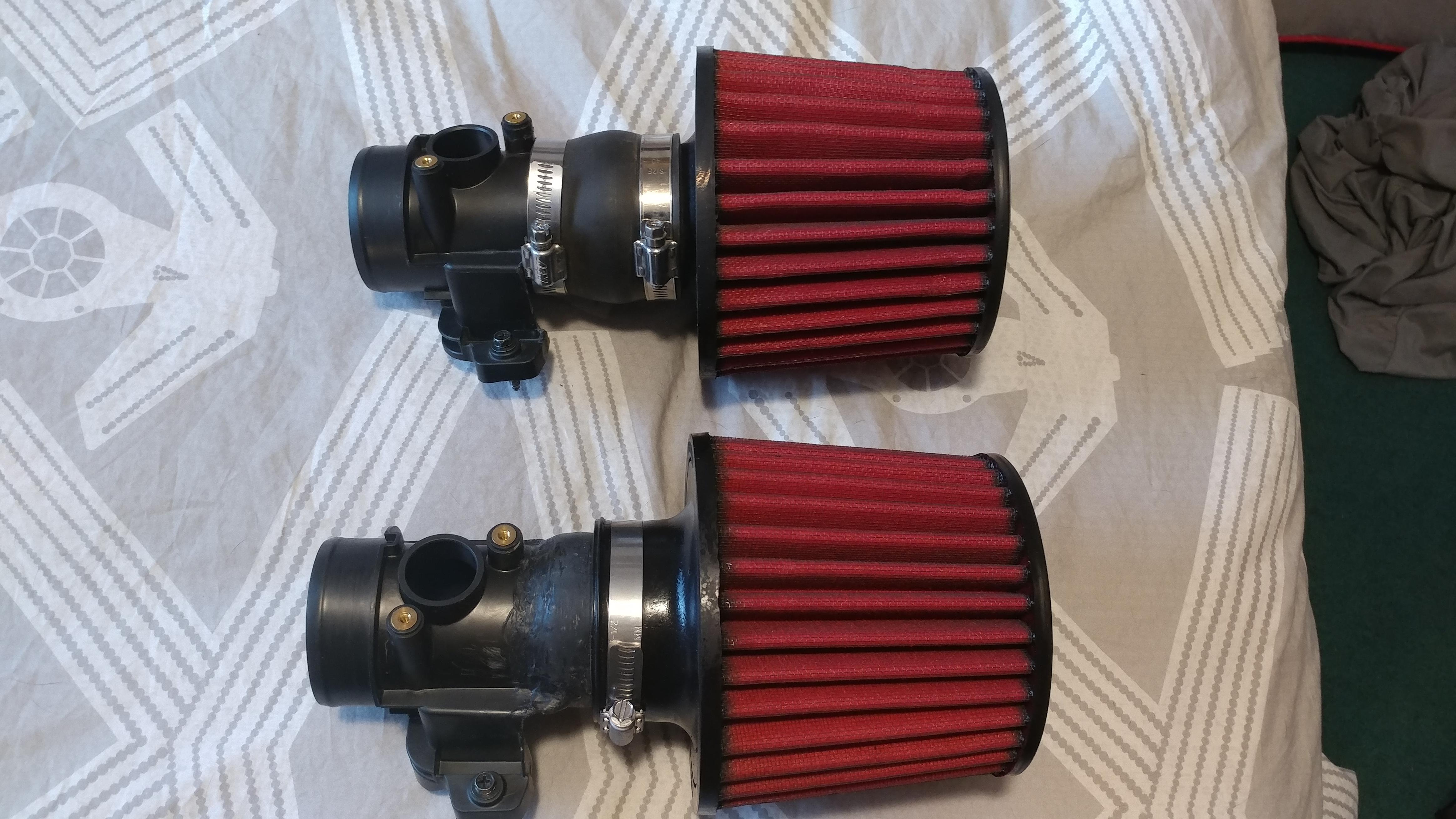

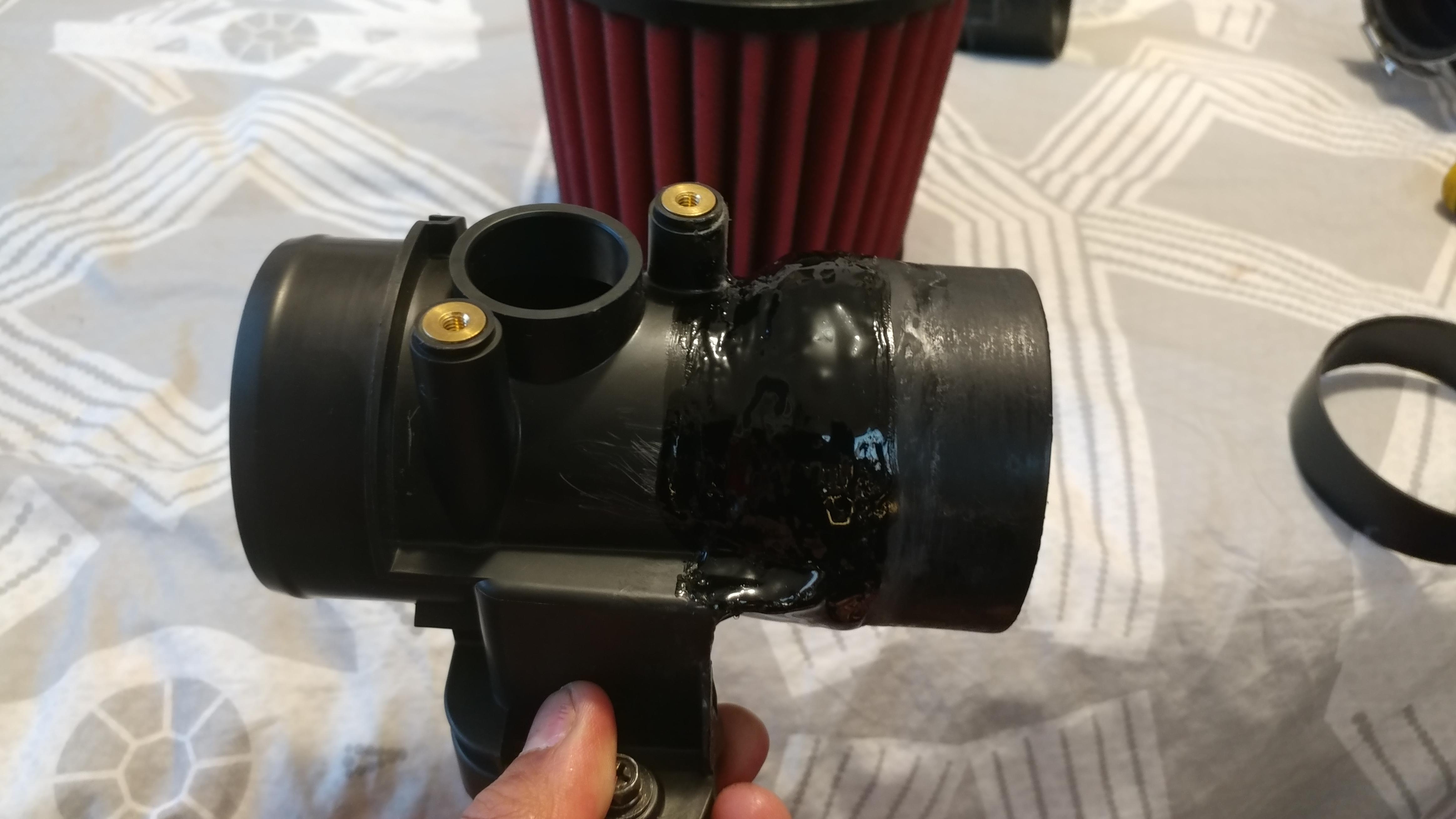

Comparison of V1 (top) and V2 (bottom). V1 is about half an inch overall longer than V2.
Comparison of V1 (top) and V2 (bottom) sans filters. Note that V1 is immensely shorter than V2, due to the extra added ABS coupler.
And V2 with the ABS glue painted on. She’s not the prettiest, but even without the ABS glue, she’s held great. I can only assume with the extra plastic, it’ll hold that much better.
And a look at the inside. You can see the area where the coupler was added onto the MAF housing, and I took some extra Permatex plastic welder and made it a smoother transition to help airflow be smoother. It’s not the smoothest surface, however, but I highly doubt minor imperfections in the surface finish will be of any concern.

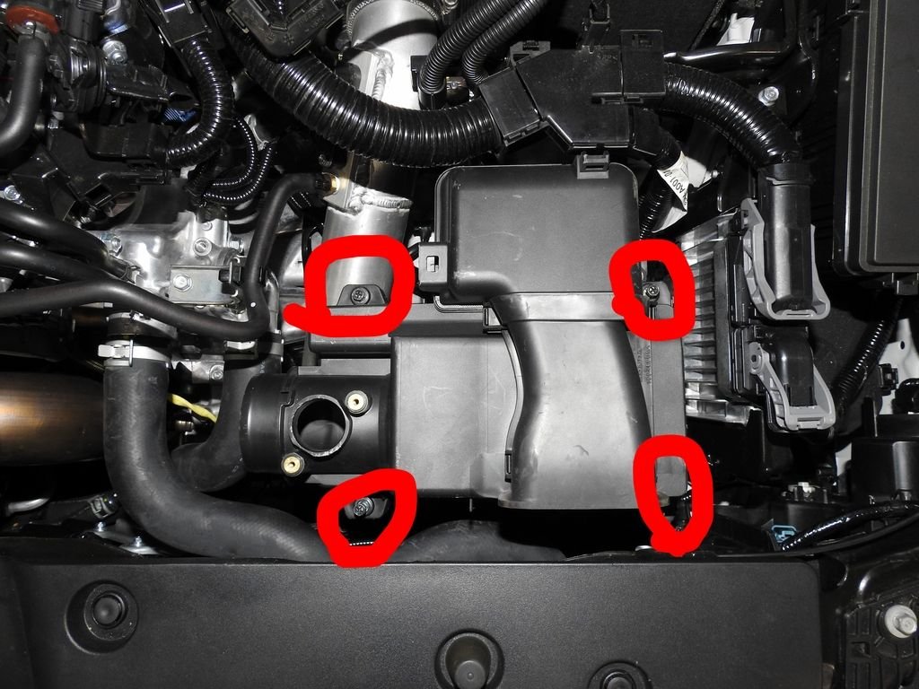

Image source: PRL Motorsports - 4 bolts hold the air cleaner cover onto the casing. Use an 8mm socket or philips head screwdriver to remove those. This is the same procedure you'd use to remove the OEM air filter. That said, once the cover is off, take the filter and put it.. somewhere. You don't need it anymore.

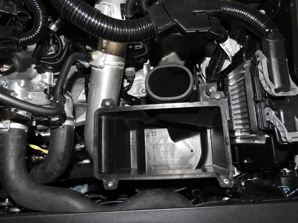

Image source: PRL Motorsports - Next up is the air cleaner case.
Remove the 2 bolts on the right side (while facing the engine bay) using a 10mm socket and a 12" extension. Now, the case is gonna feel loose like you can pull it out, but something on the front left is holding it down. It's only a rubber grommet piece. Pull upwards with some force and it'll pull right out. PRL states that you can push the box toward the front of the car to separate it from the rubber dampener nipple.

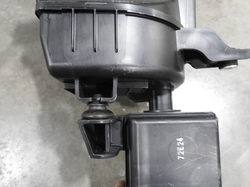

And here's what the rubber dampener nipple-air cleaner case interface looks like from the front:
Image source: PRL Motorsports - Now the pain in the *** one: the resonator box. It's held on by 2 bolts that use a 10mm socket/wrench, but they thread in from the bottom. The rear-most bolt is easy to get to, as is the bracket that is bolted to the chassis. Remove that bolt and the bolt holding the bracket on, and remove the bracket. The forward-most bolt, however, is a pain.
You have a few options here:- Jack up the car, take the bumper and floor pan out, wiggle your way down there unbolt, and drop it out the bottom. I didn't do it this way because it's a short ram, and I didn't feel like jacking up the car to install a short ram. (Instructions are laid out on PRL's install guide to perform it this way)
- Leave it in there. It will likely rattle around unless you fab up a bracket to keep it still. I didn't do it this way either.
- Wrestle the damn thing out. I did it this way. Ended up breaking a not-very-important tab to release it from the mount. That's only half the battle, though, if you go this route. In order to take the resonator out from the top, I unplugged 2 plugs (just to avoid any potential damage to wiring), and disconnected the intercooler flex piping. From there, channel your inner contortionist and finagle the thing out. It's not easy to do, but it's still very doable.
After all that is said and done, you should have all 3 pieces out. Here's what it looks like assembled, out of the car:
The tab I broke is the bottom-most part pictured (just above the word "body" on my power tower thingy). It still holds the rubber grommet/bolt thingy, just not as securely as it did before. - Unplug the MAF sensor and use a pair of pliers to release the bracket from the intake top cover and swing the wiring harness out of the way.

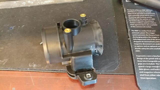

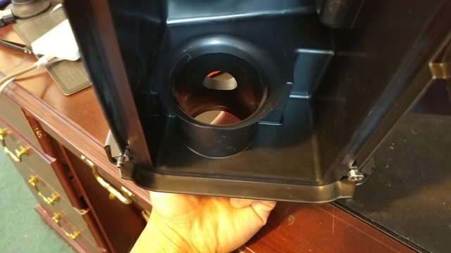

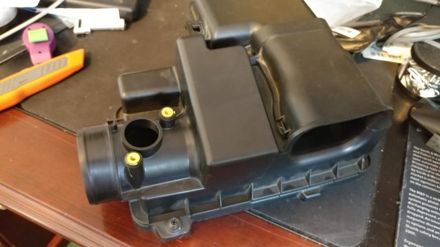

- Now it's time to meet the piece in question, the air cleaner top cover:
This is the part that needs to be hacked to pieces. Note that the MAF sensor is removed. Keep that sucker in a safe place. This car bases the AFR on that MAF sensor, and that thing has a list price of $200. Don't mess it up. lol
If you look on the inside, there's a flared part where air enters the MAF housing.
- Carefully cut to complete the circle. Take your time with it, don't mess up the MAF housing. Do yourself a favor and leave at least one of the bolt holes (that secures the cover to the casing) attached to the MAF housing. When all is said and done, you end up with something like this:
The flared end is kinda... warped.. on mine because I tried melting it down with boiling water to reshape it down to a 2.25" OD (so I could fit my filter over it). That didn't work too well, but a non-issue the way I have mine set up. You'll also notice I left the bolt hole on the front in tact, since that's what I planned on using to support it all. From all this hacking crap up, this is why I opted to have a spare on hand, in case I f'd up. - Take this time to clean out any plastic shavings. Dunk in water, rub down with a paper towel, repeat as you feel necessary, and allow to dry.
From here, the only pic I have is the installed pic. Use your mind's eye to figure out what I'm talking about. ˢᵒʳʳʸ ᵍᵘʸˢ ᴵ ˢᵘᶜᵏ

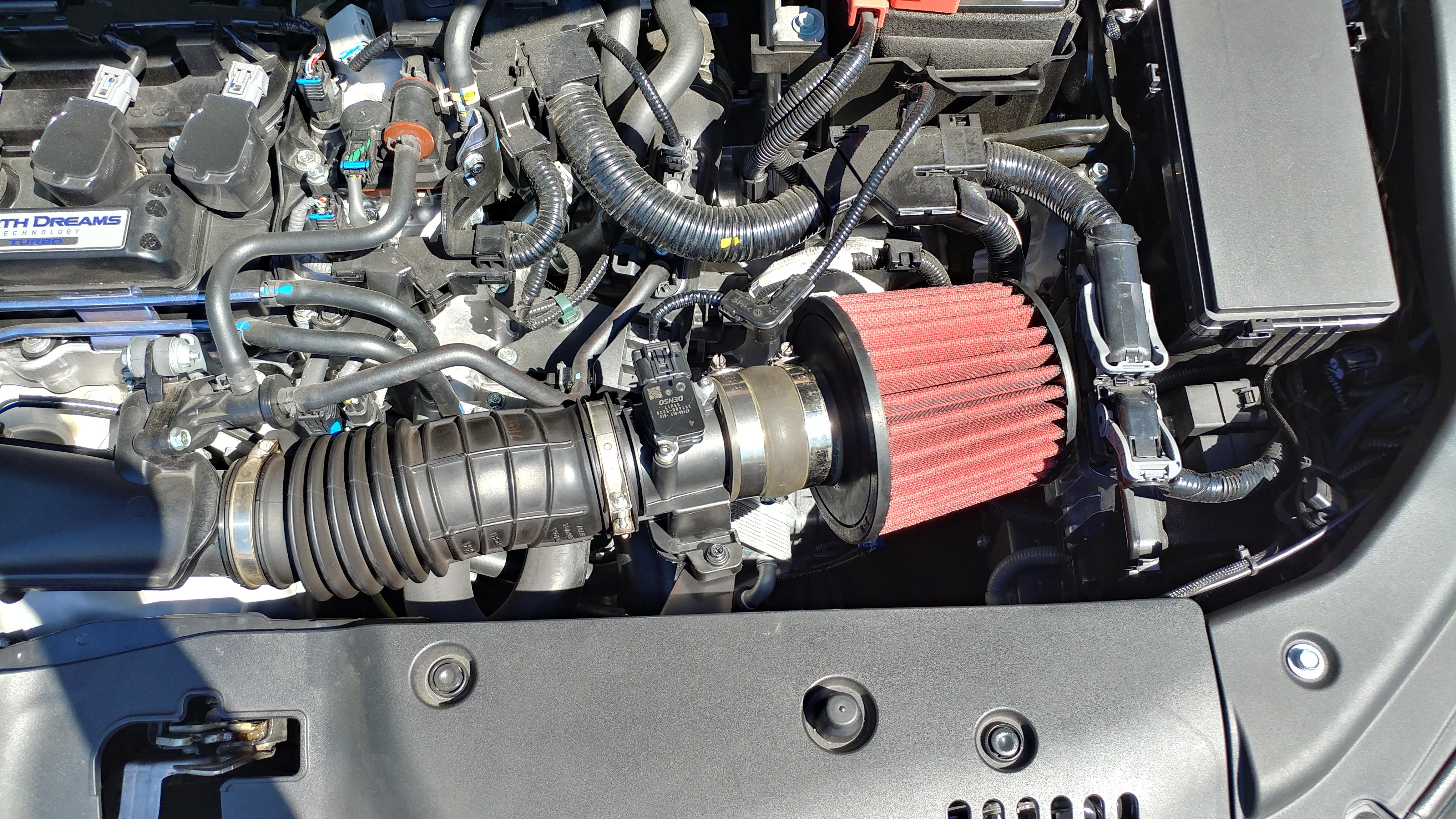

- Fire 'er up and enjoy! This is what my DIY intake looks like
My thoughts and observations on the mod after doing it.
- Definitely a difference in sound. I can hear air suction and turbo spool a lot more, which is exactly what I wanted. There's also a slight change in engine tone. Makes it sound like a subtly louder exhaust tone. I've let friends drive my car, so I have been able to notice that my car was creepily quiet while driving away. My buddy drove my car today and it sounded like I had a nice, subtle exhaust system on my car. It made me happy in my pants.
- I thought it was placebo effect until today, but I feel like my car pushed me back in my seat more than normal, thus equating to a bit more power. Same buddy that drove my car (he drives a '16 EX-T), and when we got on the highway, he exclaimed, "holy ****, this thing pulls way harder than my car." Granted, my car is rated at 6 more horsepower than his, and he knows this, but the power difference, he said, felt like far more than 6 horsepower. My other friend that I've let drive my car (she's not a car person) said my car sounds cooler, and she exclaimed, "what the hell? This car has never pushed me back in my seat like that before!" I'm still banking on maybe a few horses freed up in the peak torque band (4250-5500RPM) with some loss down low, but if I need it, I can always "downshift" using my paddle shifters to kick me into the boost range and closer to -- if not in -- the aforementioned RPM band.
- The OEM intake takes up a metric crap ton of real estate. I could probably fit a baby below the DIY intake. Holy crap. I may try and fab up a housing that forces it to take a suction from down low later (google 27won intake and you'll see what I mean), but that would take some doing, and maybe access to someone with a 3D printer.

DIY SRI V2.0 Edit
- The intake housing is not made of ABS plastic like I initially thought. That's the reason I bought ABS pipe fittings, so I could use acetone and scrap plastic to make ABS glue. Turns out, it's made of some sort of polyethylene (likely polyethylene terephthalate [PET] or high density polyethylene [HDPE]) or polypropylene (most likely scenario) and does not react with acetone.. At all. Google searching told me that it's nearly impossible to weld poly and ABS, but what I did was melt-mix-smooth, and it seemed to hold just fine. I also stabbed into the ABS coupler a bit to give the molten goo mix something to grab onto. Not enough to pierce, just enough to make a nice sized divot.
- After the welding was done, I took some acetone and painted on the goo-abs interface. A bit of the surface layer of ABS melted enough to grab onto the goo mix. I was worried about strength of the ABS-PE/PP interface since google told me it couldn't be welded. I've dropped this thing, smacked it against my desk, held the MAF housing while punching the ABS side, and it didn’t show any signs of budging. However, test fitting a silicone coupler broke it apart, so I had to try a different route.
- Tested out 3 different plastic glues: JB Weld plastic bonder, Permatex black plastic welder, and Loctite plastic bonder. Also tested out Loctite superglue for ***** and giggles. Nothing really seemed to bond very well to the PE/PP, but all of the above did well with the ABS coupling. The only one that said it bonded to PE/PP was the JB Weld variety, and with my tests, it held up a hair poorer than the Permatex black plastic welder. I mixed [the Permatex stuff] up, ran a bead on both the ABS and PE/PP surfaces and allowed it to cure for an hour. Then I mixed up more black goo and beefed up the thinnest layer (the PE/PP-ABS interface) both inside and out and let it cure for about an hour. Then, for good measure, mixed up some JB Weld plastic bonder and spread a semi-thick layer inside and out, allowed to cure for about an hour, as well. Then one more semi-thick layer of Permatex both inside and out, same hour deal. Then, to make it prettier, took a file to knock down high spots, then some 320grit sandpaper to smoothen, then wet sanded with 800 grit to smoothen some more. Test fit with the same coupler, and it held.
- So, for extra added security, decided to make some ABS glue. We know up to this point the MAF housing is not ABS, but extra plastic in the ABS-PE/PP interface is not a bad idea. Basically, to make ABS glue, I bought a spare ABS coupler from home depot (a 1.5” one, this time, since it was all of 84 cents), shredded it using a razor blade, and put it in a mason jar. In said jar, added enough acetone to cover the pile of ABS with a little bit to spare, and let it sit for 24 hours covered. From there, I literally painted it onto the ABS-PE/PP interface to smoothen out the appearance and add plastic to the area. I mean, as a test piece, I bonded a popsicle stick (used for stirring the glue) to a spare piece of ABS and after a day, it held solidly. Enough to give me peace of mind.
Enough talking about it, here are the pics
