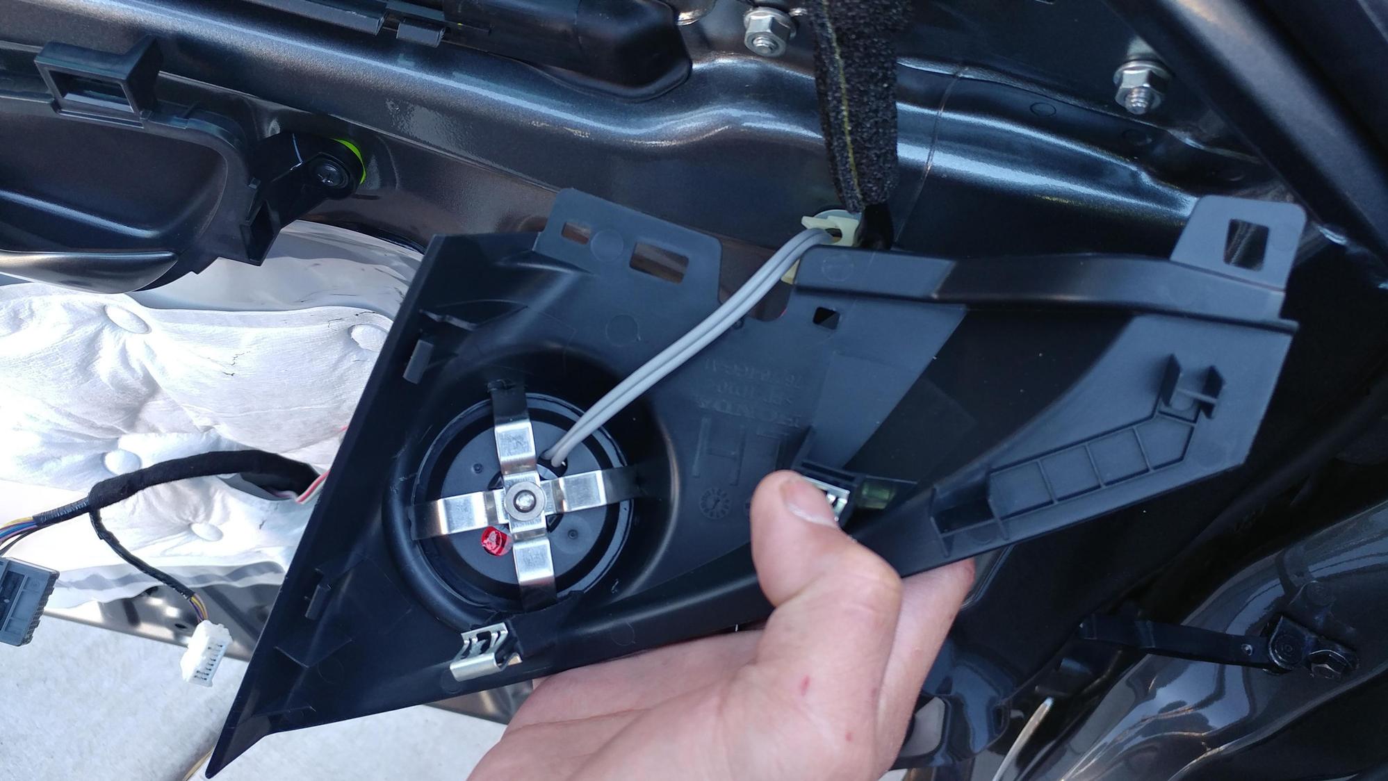

Here's how the Polk DB1001's mounted in the sail panels, from the rear. This is after trimming the opening by a little bit. The metal brackets just kinda sit on whatever they could to pull the lip of the assembly to the panel. This required a minor bit of bending to make sure all 4 made contact with plastic.

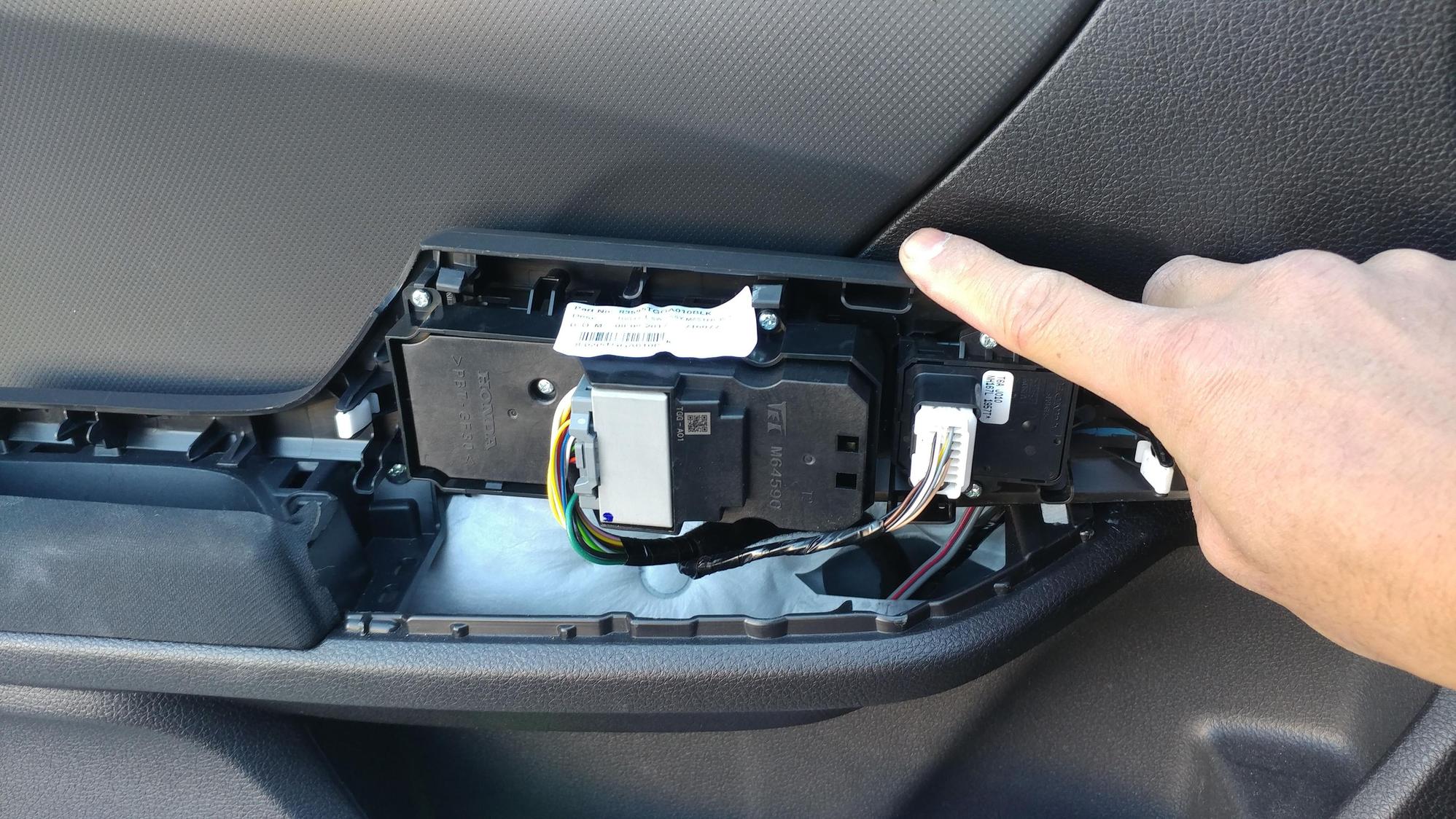

  1. Remove the arm panel that has window controls. The easiest point of access to get a pry bar/screw driver under it is on the front end. The first time you break it loose, it's gonna be a bitch. Pull with gentle force.
  2. Once you got that separated from the door panel, you'll see that there are 2 electrical plugs on the driver's side, and one on the passenger's side. Remove those, and set the arm rest panel aside.

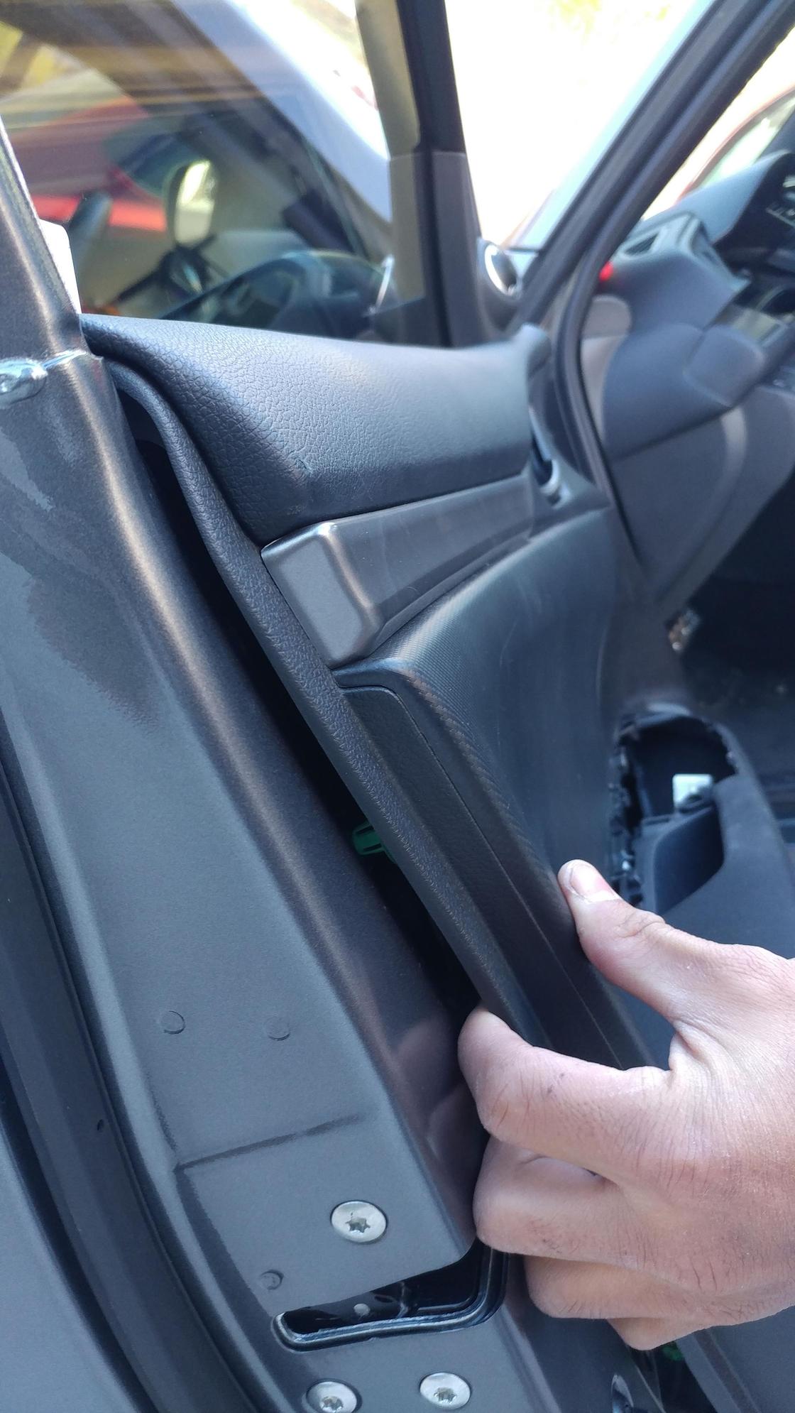

  4. Find a spot to pull the door panel off. There are 9 green clips holding it in place. Easiest place I found to start pulling from was the front bottom corner. Once you pop one off, the rest follow pretty easily.

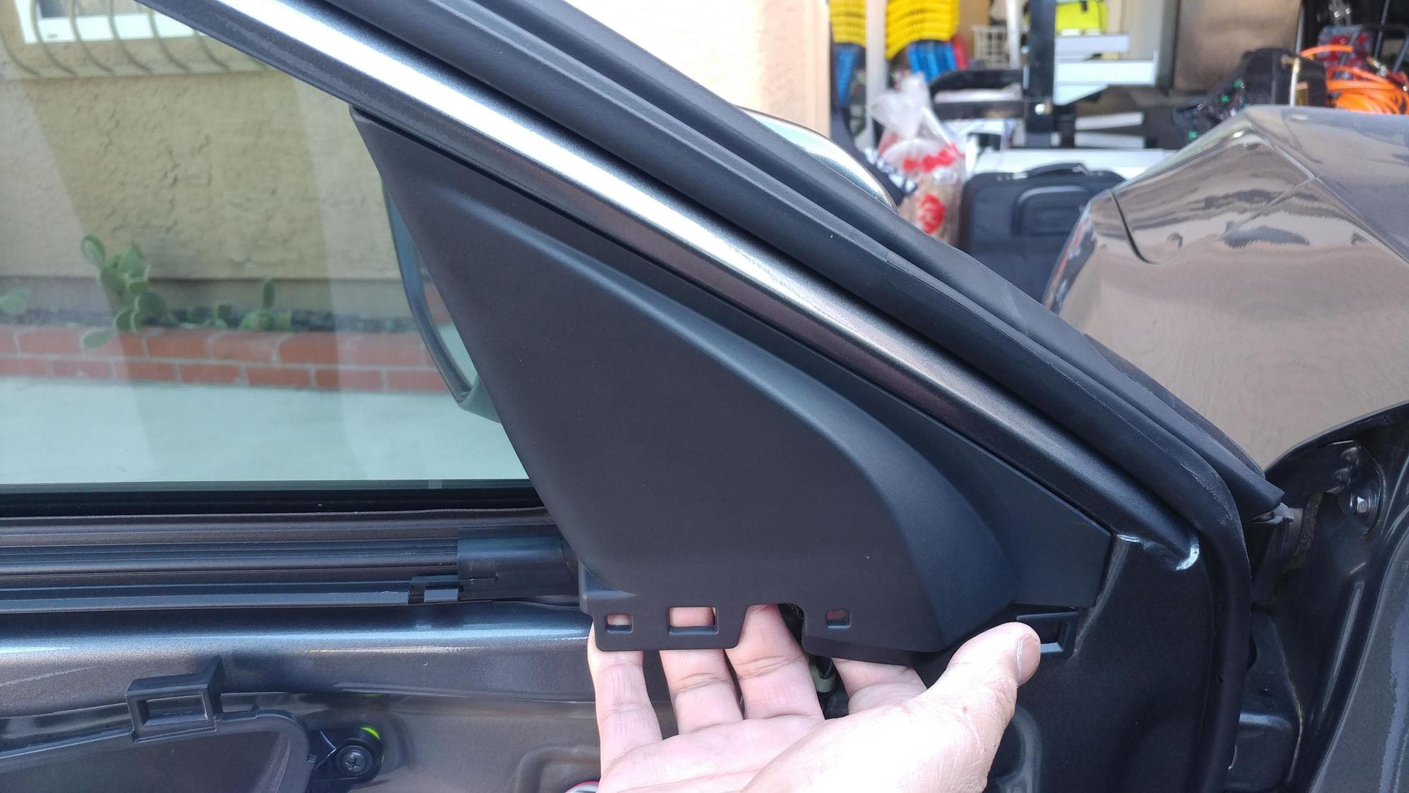

  5. Grab the underside of the sail panel. Gently yank it off the door. I actually broke my passenger side on by pulling too hard. Be gentle, but it's gonna take some muscle.

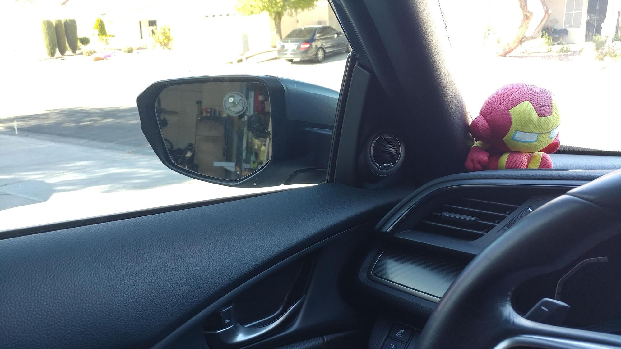

  8. At this point, install the tweeter-mounted sail panel into the door.
    If you wish to have a clean look, do as I did and have the tweeter wiring follow the power mirror wiring harness to the center of the door, through the vapor barrier, then reach into the speaker hole and grab the loose tweeter leads. Secure the wires along with way, if you desire. I used zip ties to secure the wiring to the OEM mirror wire harness.
  9. This is the part that takes some creative finagling -- connecting the tweeter wires to the OEM speaker. For those of you that wish to add tweeters to a car that's not equipped with factory tweeters (kind of the point of this thread), you're just going to connect the tweeter wires to the factory speaker. For the electrical term savvy, what you're going to end up doing is wiring these tweeters in parallel with the factory door speaker. I opted to do option 3 in my list below.

All put back together
View of the driver's side, from the driver's seat
View of the passenger's side, from the driver's seat
