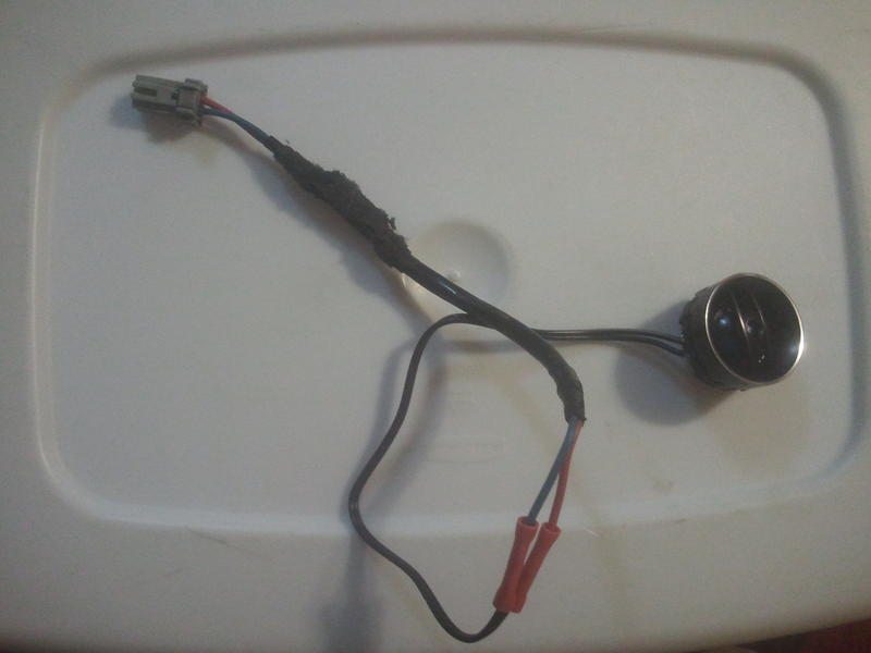

Problem 1 : The door already has wiring for components so I'd begun by using the existing wiring. I chopped the tweeter end wires off and mated these leads to the factory harness. See attachment "tweeter and harness.jpg". I assumed this post is correct as per the wiring colors. Additionally, you may notice on the factory side of the wiring there is a bulge a few cm from the harness. It's covered with foam and shrink tape. I am working under the impression this is a HPF. Am I on the right page with all of this so far? As a test, I plugged in the Tweeter using the factory harness. The sound is almost non-existent. It's faint, much quieter than the rear deck. Even close to my ears, I can barely hear much coming out. Is it possible that the oem HPF is shot? The reason I was replacing the front speakers is that they had problems including being unable to hear them. Could this be the HPF?

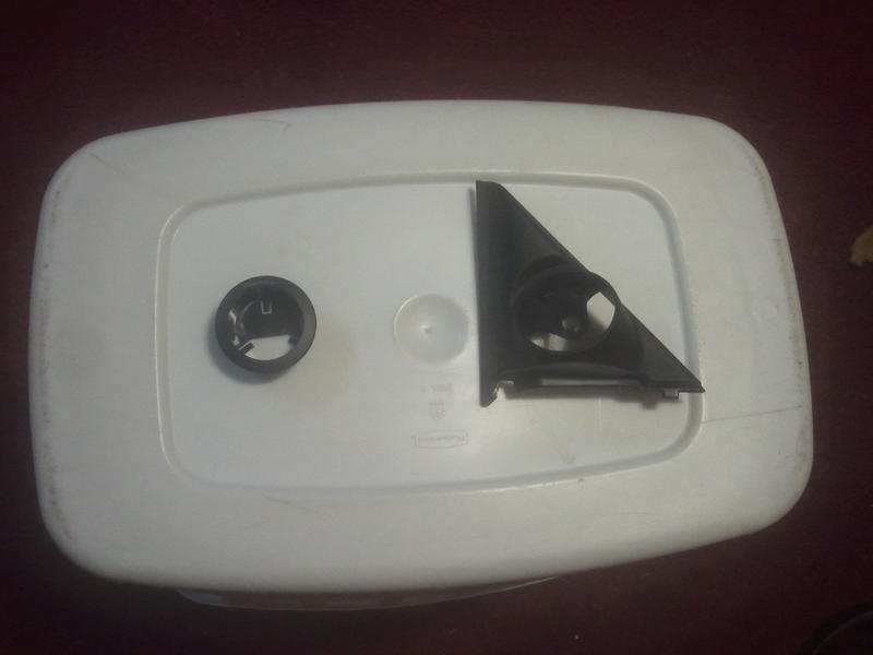

Problem 3 : The new tweeter is smaller than the original. The original tweeter was mounted by a rear screw through the center of the sail panel. The new tweeter did come with a flat housing and an angled housing. It seems the flat housing will fit in the sail panel, but it's barely big enough. Since re-screwing it is out of the question, how is the best way to mount it? I'm thinking I could glue the new housing to the sail panel. The lip of the Pioneer trim ring would just cover the original location of the tweeter. Would E6000 or some kind of Epoxy work for this? I'll have to cut out part of the back of the sail panel where the screw was mounted through. See picture "sail panel and tweeter housing.jpg"

Yes my post was correct, I took the tape off and the bulge you saw is a capacitor (at least it was on my car). I used the factory wiring on my tweeters and theyre fine but they are a little on the loud side. I used hot glue on mine and it worked fine but something stronger would be of better use

Your new crossover is attached to the back of the mid-bass driver. I would run new wiring to the tweeter as it is very possible the HPF is damaged and even if it's not it probably isn't the proper crossover frequency for the new tweeter.
Sorry, you were looking for wiring, not the crossover. It's just standard wire with spade clips on the ends. You can easily make a set for a few dollars. I never use the included wire as it's crap.

Was able to cut out / remove the back screw plate from sail panel easily. I should be able to glue the Flush Mount Spacer in easily now.
Anybody have suggestions on a glue for plastic to plastic bonding? I'm thinking All-Seal or E-6000.

I have same speakers in front
went in nicely
used plasric ring from cruchfield drilled holes
where speaker holes are then positioned on door drilled out
4 holes and used screws sent with speakers.
mine came with wirez that went to tweets with a
cap inline
and i just crazy glued my tweeters in pods had to cut a bit out
behind to make em fit
all looks stock
