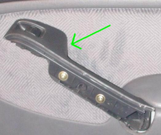

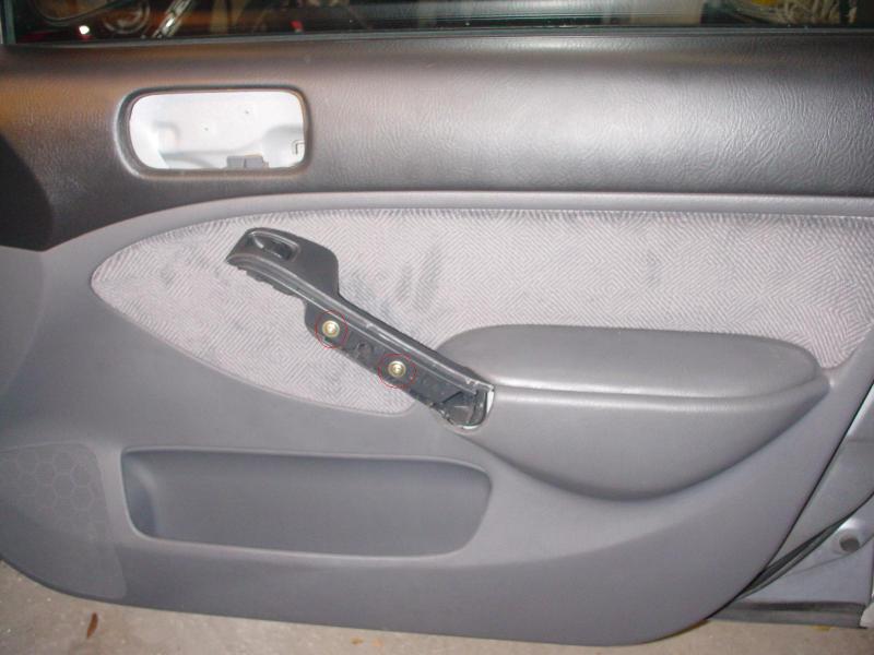

5). This part I found difficult. You have to remove the front cover on the door handle. I found the best way to remove this is to start at the bottom of the handle. Then insert you prying device into a seam behind the power window switch. If you cannot find this location, follow the seam all the way around untill you at the actual door panel behind the power window switch.
6). Once this is off you will be able to easily see two (2) gold phillips head screws. These are flush with the part that you just took off. DO NOT REMOVE THESE (red circles). This will remove the handle from the door, not good. Look for two (2) recessed screws that look the same. They will have there own channels to reach them. Just look along the bare part of the panel that you have just removed.

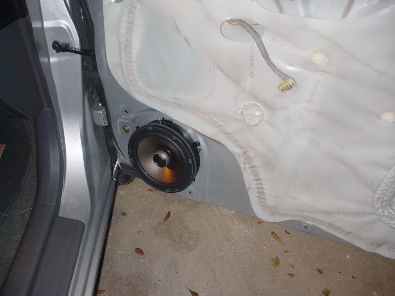

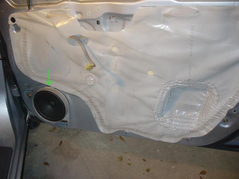

9). Now this is a nice little quirk from Honda. With the panel off the speaker can be easily removed...right
. Locate the top of the speaker and insert a flat head screw driver at the top of the speaker. You should feel a metalic clip depresss it and pull the speaker towards you. Easier said than done. Now that you have released this clip DO NOT continue to pull towards you. Push upwards, gently, and the speaker should be free from the panel.
10). Now just remove the harness clip from the speaker and its finally free.
Now I used a speaker adapter plate to install the after market speakers. This will require marking points and drilling them through. Installing your speakers may differ from mine depending on your parts. Also I used speaker "wiring harnesses." These simple plug on your speakers coaxial tabs and then plug into the existing factory harness that you have unpluged from the stock speaker. This makes the install or future removal very easy, because there is no soldering involved.
