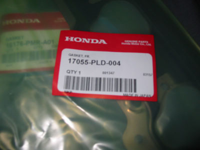

For those of you who installed it already.. are these the right gaskets?

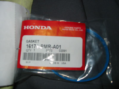

the other one

Hey Robb...Those are the correct gaskets. You didn't need the blue ones but it's ok...Don't install it until I or someone else can dyno tune.

Boo! ok... thanks... i guess.
