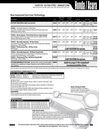

I’m currently running a D15y4 1.5L ex VTec-e, and am looking at doing a cam swap. I’ve read a lot on the Crower Stage 1 cam, although I’m not sure if it will fit/what modifications will need to be done.
Any info on this subject would be much appreciated!

crower discontinued that cam

Hmm, yeah it looks that way. Is a regrind the only decent solution then?

yes, but you will need to send your cam.
not sure if they have the profile in NZ.

A Google search says they use the same head and cam but I'm not sure.

Yeah, theyre virtually the same head. I read that the cams are the same for the D17 &D15. If I were to get a regrind, would these be the correct specs? 🧐

yep
since you seem to have read the sticky thread, be aware they might not be able to get full specs
