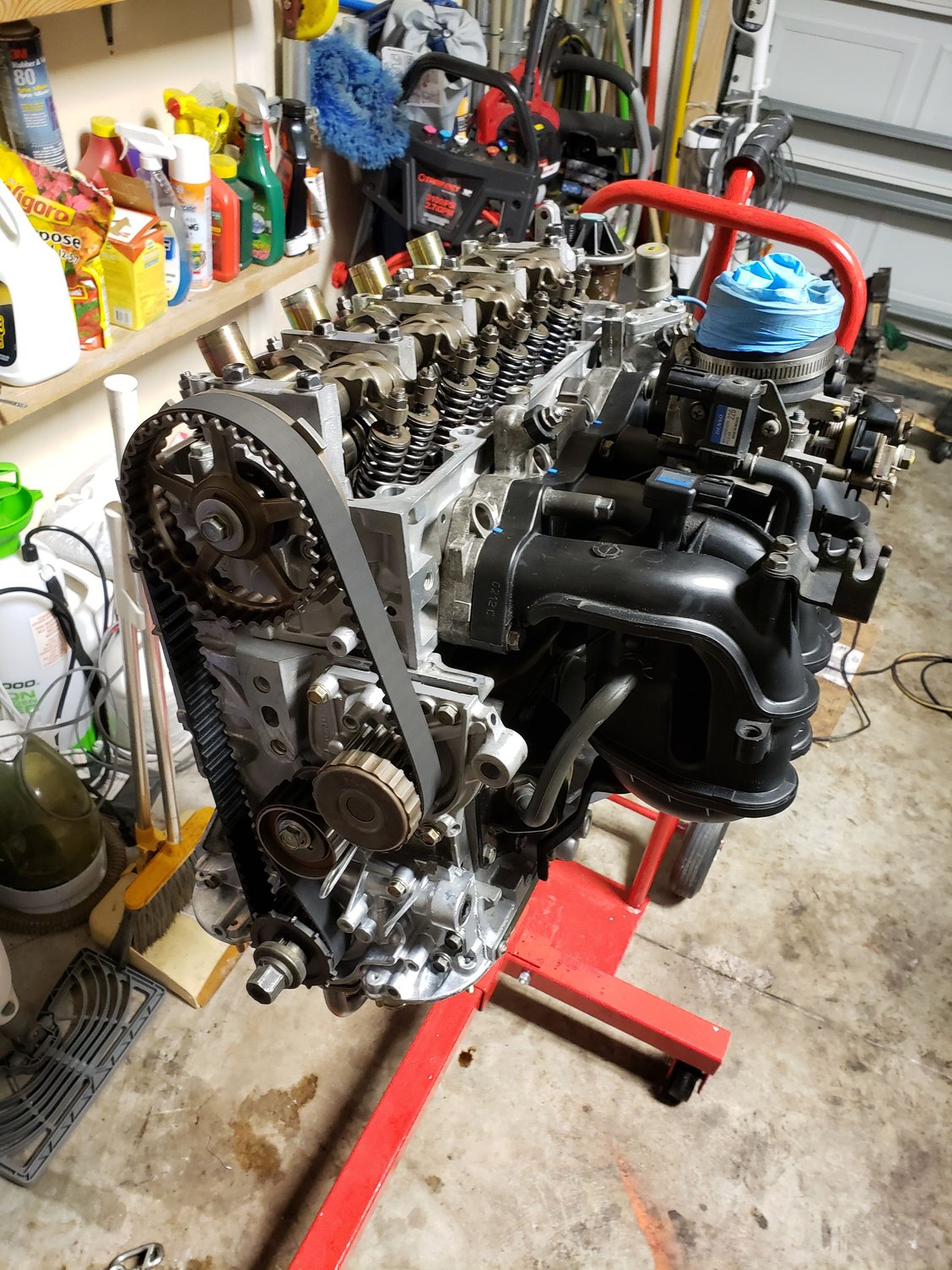

I've now got everything together minus a few odds and ends. This weekend is the one!
Here's some photos. I have many more lol but this is what's on my phone at the moment.

Re: D17A2 Stock Rebuild - Seeking Advice
looks good.
I would throw some lucas assembly lube on any moving part.
Also, you may want to add some water to the engine to make sure your "o" rings( located on the tube from the water pump to the thermostat area) are not leaking.
It's a PIA to fix if the engine is back in the car fully assembled and leaks from the backside.....a friend told me this once....

Well, yes I put assembly lube on the main and rod bearings, as well as camshaft journals and bearings. I rubbed oil in the cylinder bores and piston rings. New O-rings, gaskets, and seals (yes the 2 O-rings on the metal tubes you mentioned as well). I will fill up the fluids before starting the car.
Really my only concern with the build is the crazy ****. Like bearing tolerances, crank balancing with the new pistons, and ring gap. Other than that, the build is coming along like a dream!
