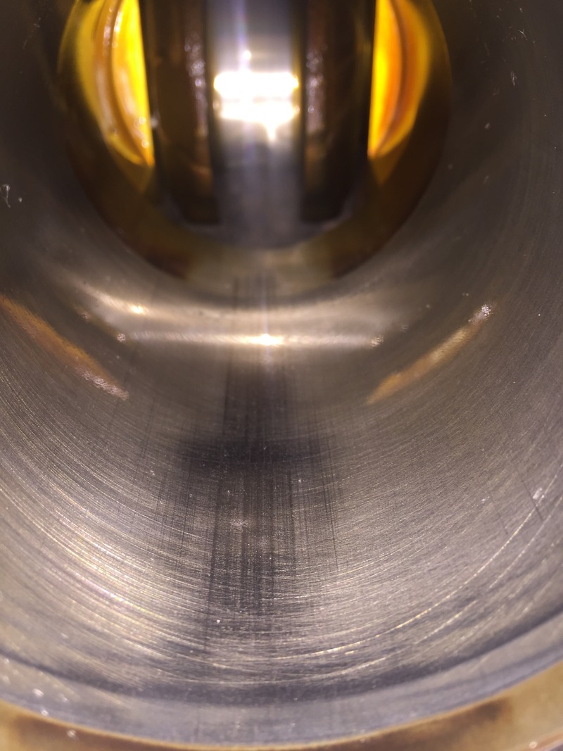

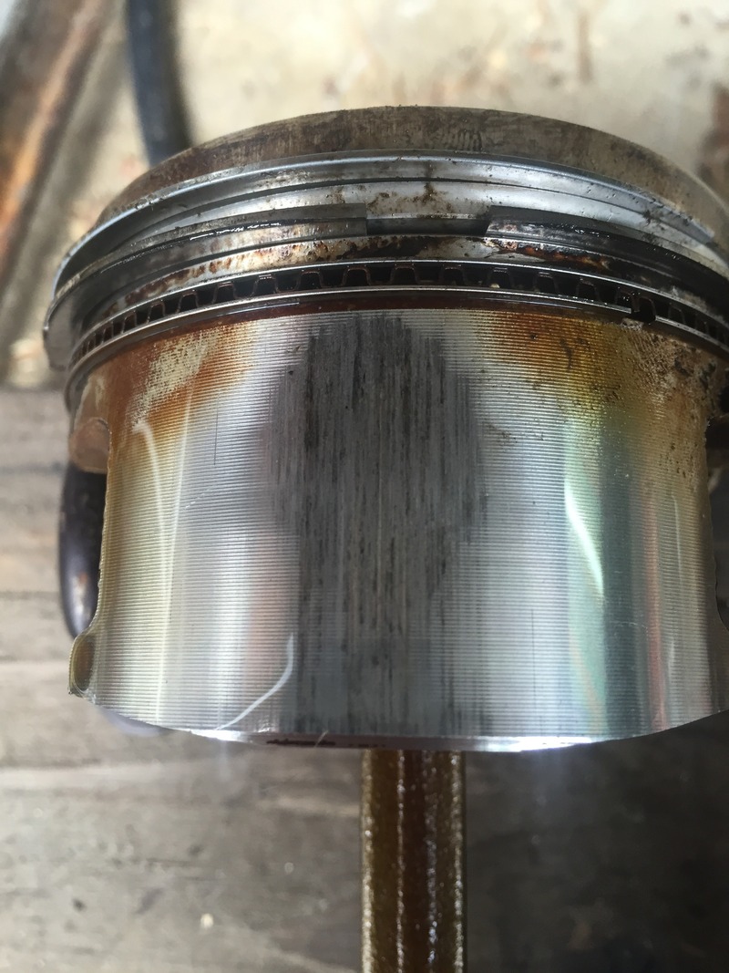

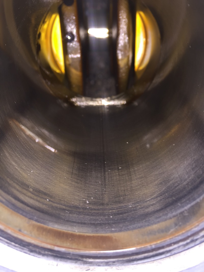

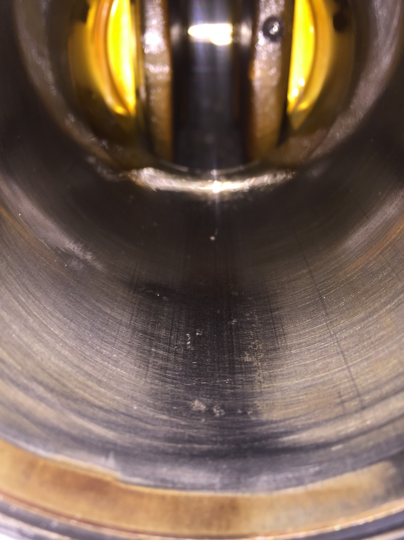

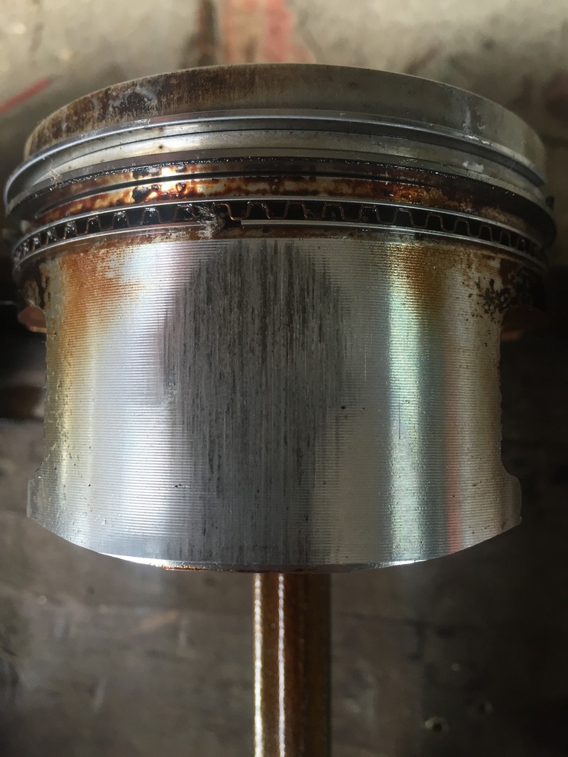

With the amount of leakage bumped up to 35% in cylinder 4 and 15-20% in the other 3 I decided to pull the engine apart this morning (only took 2 hours, not bad)
I see cylinder wall scoring on the exhaust side and also scoring on the pistons. Looks like normal wear for me on the engine that's had 130K miles on it now, but like always a second look never hurt anyone. Just a recap:
Car smoked out clouds of thick grey smoke on idle and throttle (if anyone says its coolant just leave the thread now, its not coolant), Leak down test showed 20,15,20,35 from cylinders 1-4. Changed out PCV, Stem seals, and checked the valves in the head. Compression range at last test was 178,175,178,175.

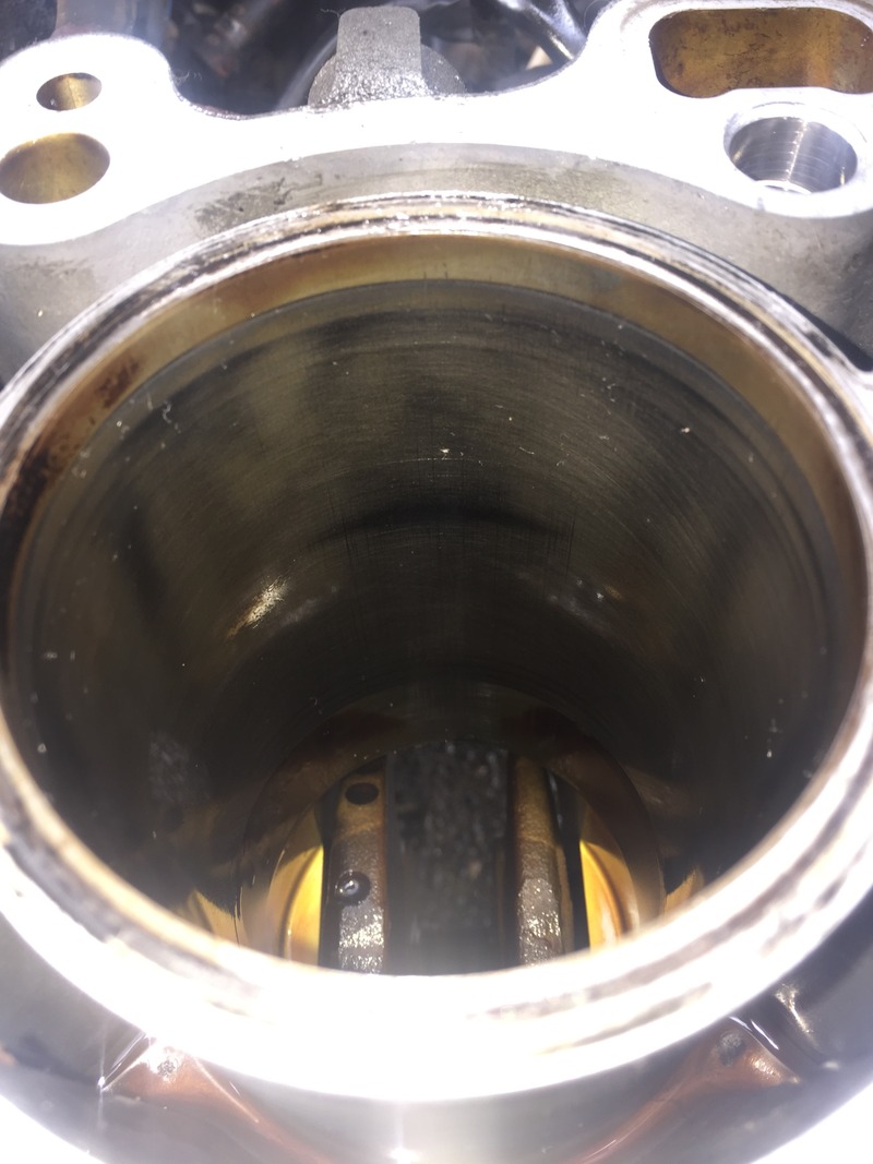

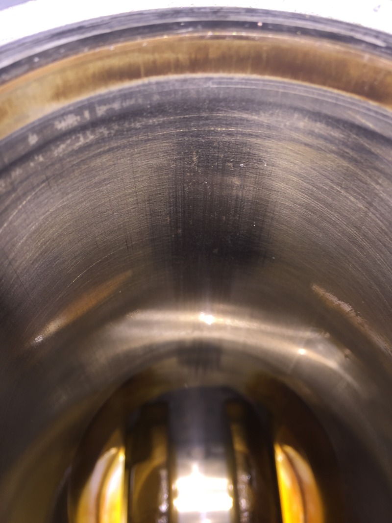

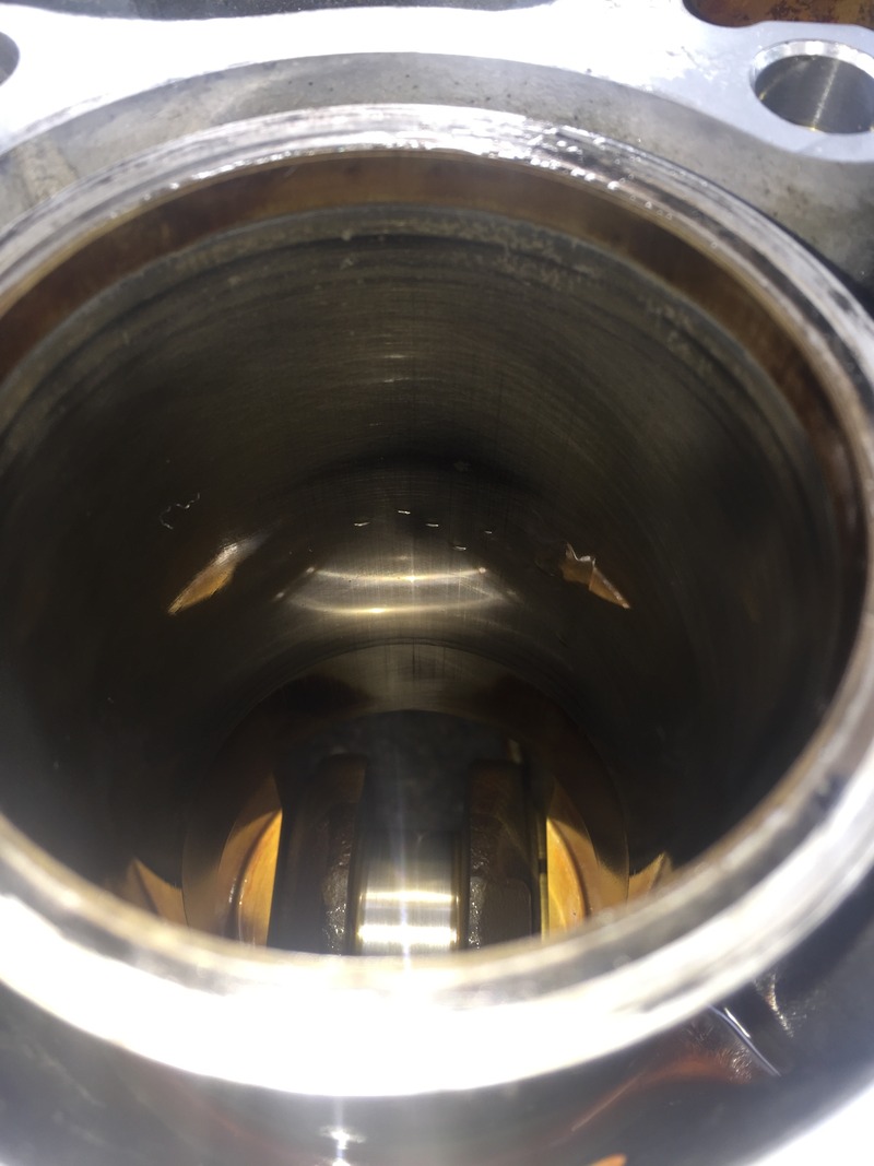

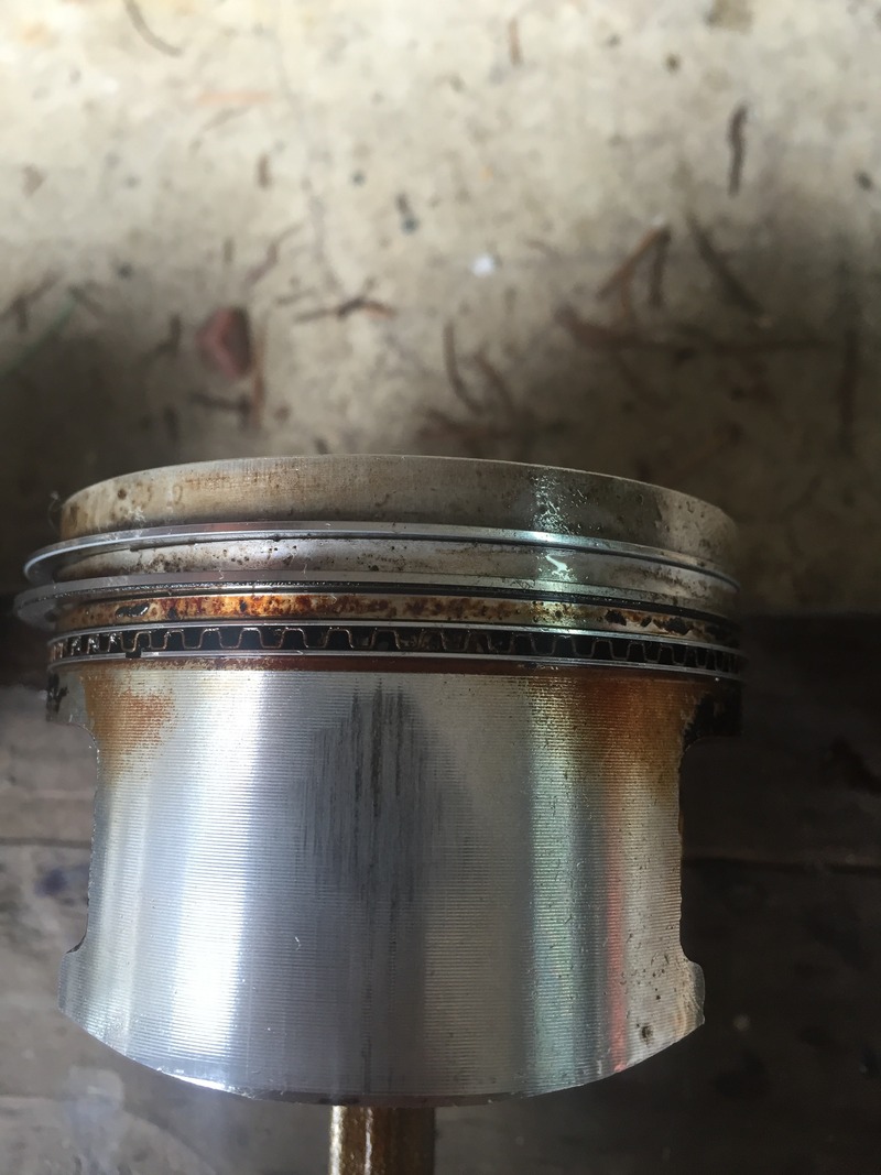

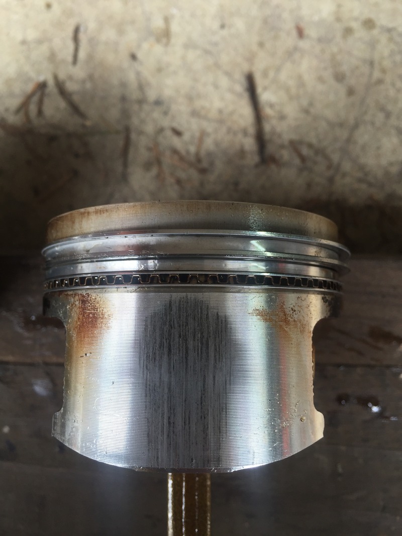

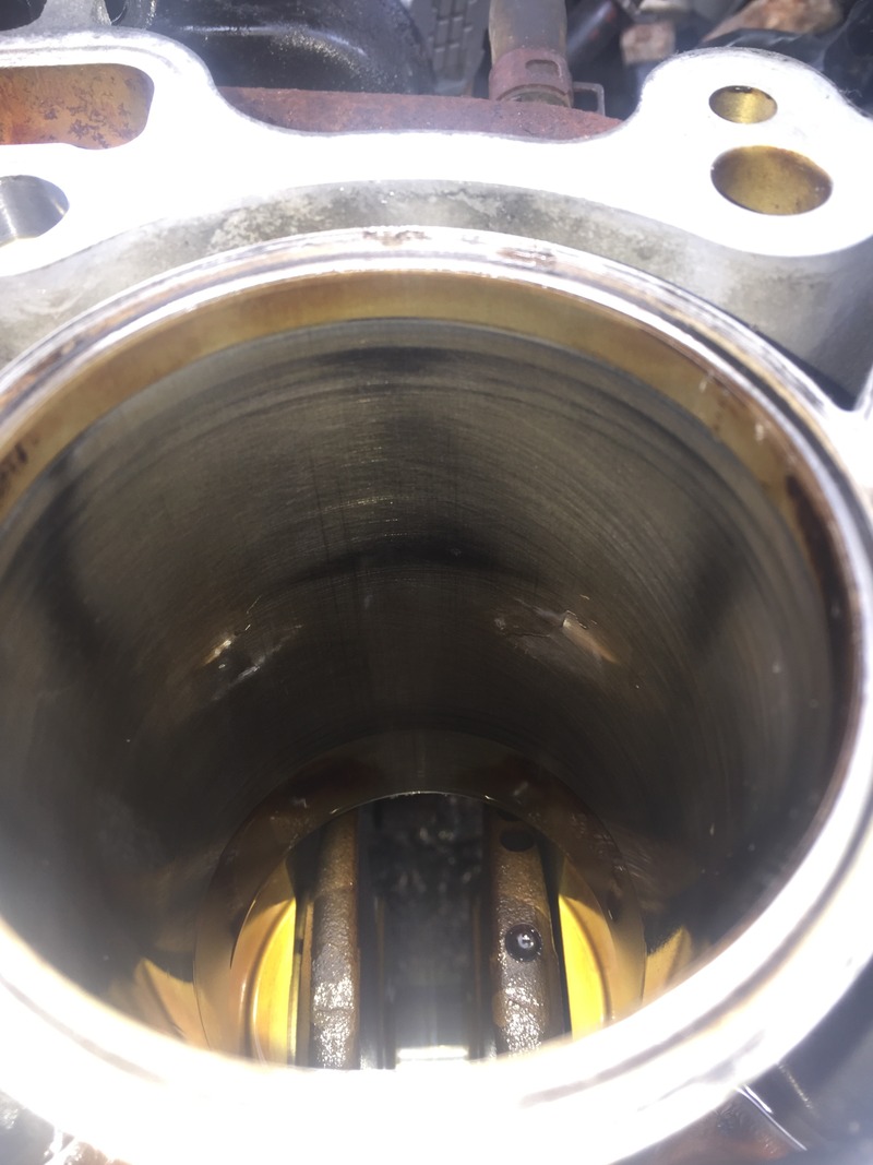

Question is, would you run these pistons again? I have the new rings and am ready to install and file them. Just coming from a 2 stroke world where this amount of rub would mean a new piston set. I am unsure if this is normal for a 4 stroke engine.
Also I have a hone that attaches to the drill. My cylinder walls are well within spec still, do these cylinders look like a hone is needed? The scoring on the exhaust side is light enough that my fingernails do not catch.

If you can't hang a fingernail in the scratches on the cylinder walls, that's supposed to be acceptable.
Scratches in the piston skirts won't pass oil, but deep scratches in the cylinder walls can.
Skirts look scored like it may have been run low on oil and/or run hot with swelled pistons.
This is the engine that was run severely overheated?
Maybe it's got a a manual trans and the engine has been 'lugged' at too low RPM?
Some scoring is average, but to what extent I can't say. Second piston pic looks typical but the other 3 are iffy IMO.
Most of the pistons I see these days are teflon coated on the skirts and still have some wear on them.
Measure clearance of skirt to cylinder wall. If clearance is too big they may piston slap all the time (piston slap while cold is typical and expected though).
Did it do this (piston slap) before you took it apart? If noise wasn't a problem I would reuse them?
Were the oil control rings stuck in their grooves?
If this was a severe overheat, they may have just lost their spring tension and can't seal well.
I would sure hope that filing ring gaps should not be necessary if you got standard bore size rings and standard bore block.
