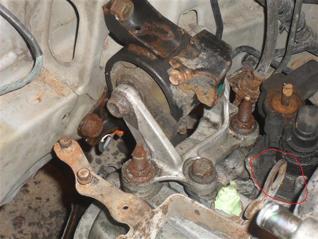

I have a feeling you were reading a recent thread on dropping the transmission, we discussed clearance issues with pulling the transmission from the top, when separated from the block.
The engine with the transmission attached can be pulled from the top, no need to mess with the subframe.
see..

Awsome!!! I noticed you dont seem to have abs, i do. Will i have to remove it? That is another dread of mine.

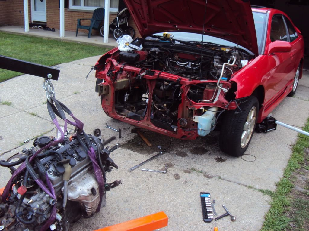

I actually stole that pic from the auto-to-manual diy, fortunately I haven't needed to pull my engine yet, although I hear the beginnings of what I'm trying to convince myself isn't a rod knock.
You won't need to remove the abs module, here's another picture. It's a bit small, but if you look closely you can see the abs module is still at home in the bay after the engine was pulled.

Both these pictures are of autos it appears. Still no word on a manual!!!

The second pic is of a manual. It's from Brobo's build thread, it's on the first page in member rides, check it out.

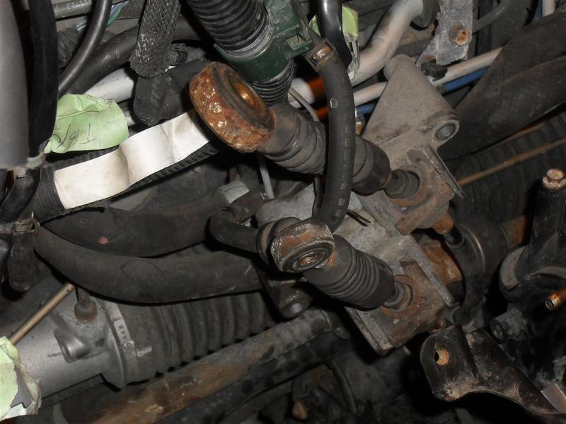

Name:	SDC10897 (Small).JPG
Sad!!
Name:	SDC10900 (Small).JPG
Is this a safe place to hook a chain to?

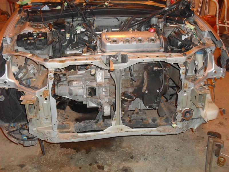

Name:	SDC10901 (Medium).jpg
New used motor. Been sitting awhile apparently!!

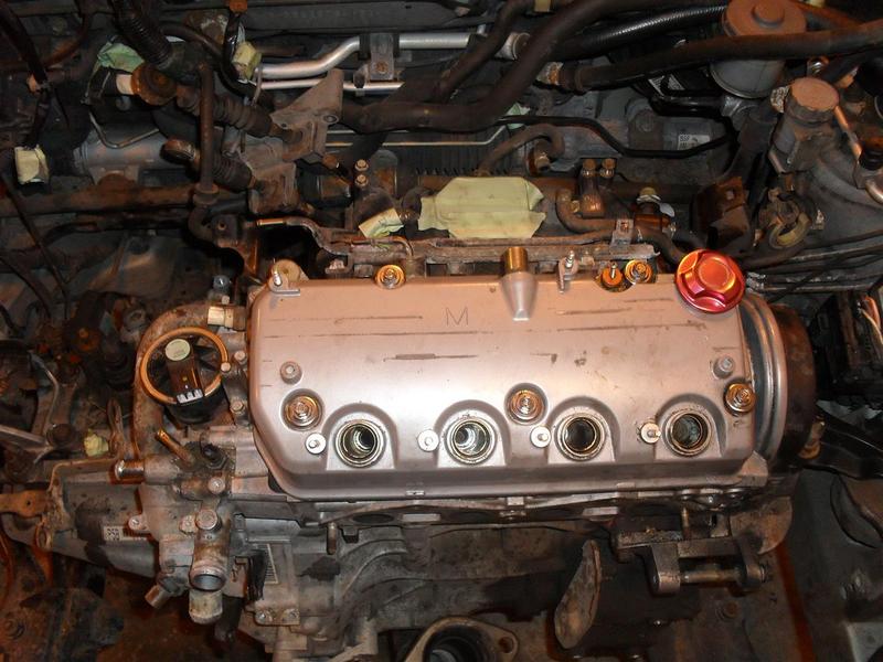

Name:	SDC10902 (Medium).jpg
Freaking broken pulley on 03 motor. More work. Just ordered the tool to pull it.

Yeah that motor looks like it's been sitting for awhile. I'd at least change the timing belt, if you have the funds change the water pump and tensioner as well. Since it only has 55k on the motor I assume the belt is original and is 10 years old now....and hasn't been run in years. The crank pulley removal tool is a big help...sucks waiting for parts though.
In my Mustang days I picked up a 5.0L from the junk yard that had been sitting for awhile. The motor was fine but I had to re-tap all the threads where the transmission mounts to the block because they were badly rusted. Just something to watch out for.

Yeah i just had my water pump timing service done in february so im just gonna swap it all over when i can get the damn thing out thursday hopefully. As far as the tapping part i should be good because they removed it from the car a day before I bought it. Then removed trans and tb. That part should be ok. I hope!!

Some more pics. The crank pulley tool is being overnighted. 15$ on Amazon, 35 to overnight!! Oh well it's gotta get done

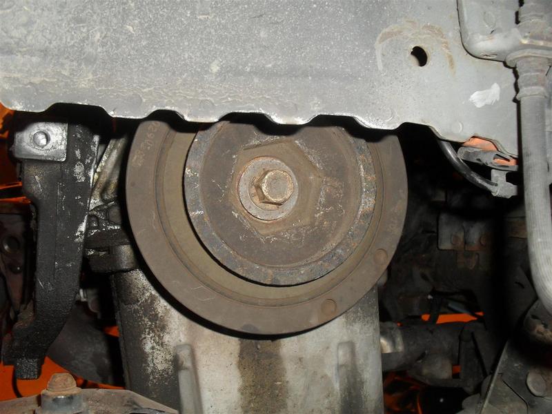

Should of pulled from ecu, but was not aware you could do that
Name:	SDC10904 (Large).jpg
Name:	SDC10905 (Large).jpg
Damn pulley!! Should of bought it years ago. My homemade tool just wont cut it!!
