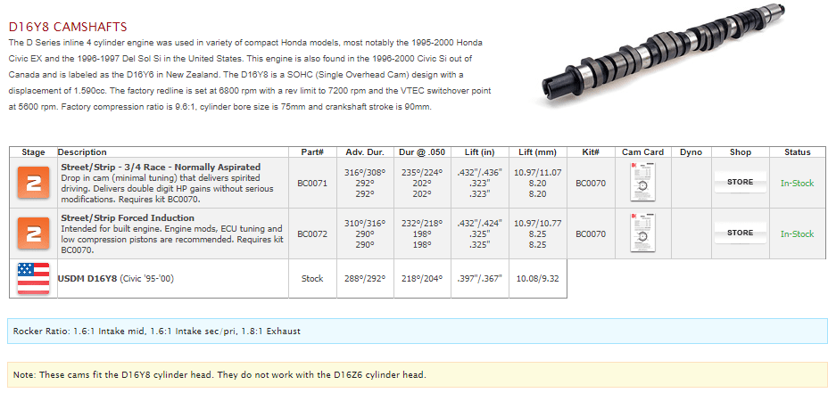

What are your thoughts about the regrind? How has the build held up with the test of time?
I started this rebuild before doing the research that everything is still available to create a close to stock dependable DD with some pep. Therefore, contemplating my next moves if going that far on the regrind isn't worth it or how to achieve desired results.
Does anyone know if a D16Y8 stock camshaft ground down would work since it has more meat to play with?
For you crazy cats that wanna get custom grinds done, here's the specs for crower's D17A2 cams (had to google fu the crap out of this)
All else fails, you can order a custom ground cam to the stage 3 specs from crower. lol
I know it’s been done; I’m not super familiar with the process but there’s a channel on YT that did it but it did require a few modifications. That was with a stock Y8 cam, but I can’t imagine it’d be any different. It also gives you the 3-lobe VTEC, which probably is why it’s more popular.
