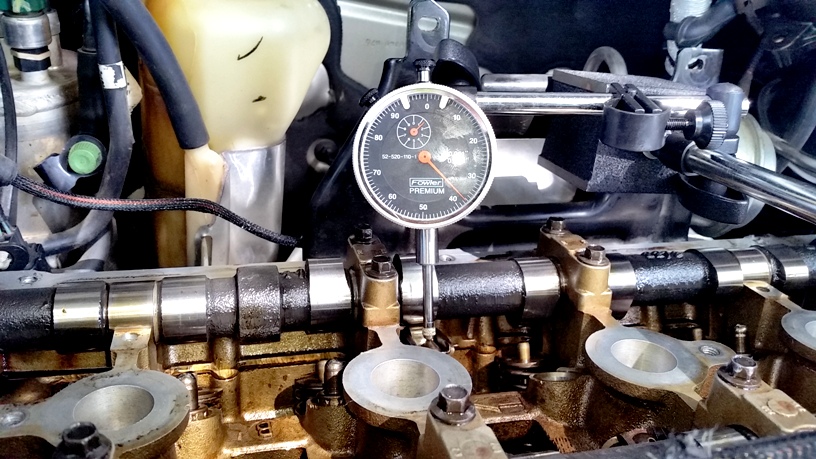

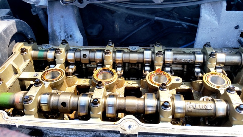

i personally have never liked the regrind idea because there's too much room for error. it's easier to keep the geometry right without having to make up .020 or .040 or whatever ends up being removed. i have a friend that is much smarter than myself and he loves regrinds. has been developing cams for eons and has crower regrind oem cams to his specs all the time. recently (about a year ago) he had one regrind for a mopar 2.4 where the base circle was cut too small and the lash adjusters could not extend far enough to have proper lash. only in one case though, all the other cams cut and sold with the same specs were fine. he ended up getting bad mouthed, had people blaming the cam he designed, etc, because the guy at the grinder made a simple mistake and took too much off the base to safely hit his specs. this is likely why they want to see and measure your cam first. i would call crower and see how confident they feel about regrinding it.
this is the actual regrind in question, and below it stock cams. you can see how much smaller the base circle becomes. if they need to grind it too small to get it where you want it.... well they'll know better than us how far they can cut without making the valvetrain geometry fubar.

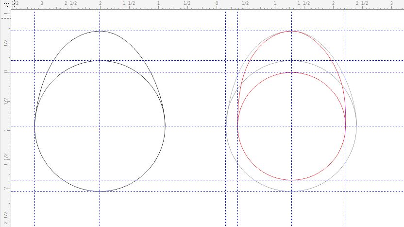

they do not add material, they remove it from the sides and bottom, which makes the base smaller and the lobes act taller/wider/etc.

depending how much is removed, you can run into unforeseen issues: lash adjusters no longer centered on the valve stem causing valve guides to wear or valve tips to mushroom, rollers lower causing the pressure to exert more sideways than vertical, etc.. which is why they will always want the cam in hand to measure before deciding if there's enough meat on it to do what you want.
pic is just a BS pic i made where the center was made smaller so you can see how i illustrated it making the lobe 1/3 taller

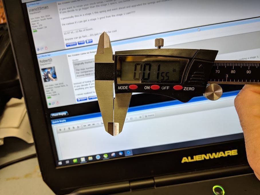

instead of losing shipping money you might have them cut it, try it. the stage 1 duration is there, you may love it.
if you decide if you want something bigger, you'll at least have something worth some $$ to sell. i imagine in an ad that would be found by someone seeking a stage 1, your cam would resell pretty quickly and would cover anything you spend on the shipping, grinding, vc gasket, etc
i never realized how tiny honda cams are. mine's In:222 / Ex:230 with .512/.512 lift, which is on the small side for a v8.

this is how much that 0.015 missing EXH lift is, the Intake lift missing is 1/3 or that. i doubt you or the engine would notice the missing lift.
