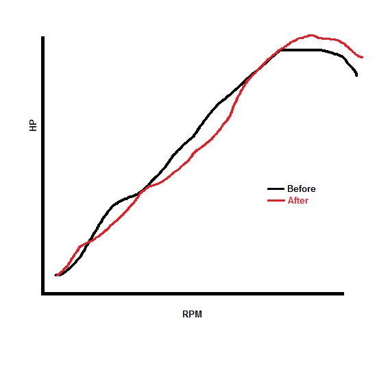

Old Dec 13, 2014
Rep Power: 513
Re: How to Increase my stock Automatic HP?
buy them and bolt them on.
Forewarning, though.. They don't necessarily give you horsepower, per se, they really just shift the power band. You'll often lose some mid-range power, but you'll gain high end power. Usually by 1-3HP both ways.
edit: Awesome MS Paint drawing for visual illustration

Old Dec 13, 2014
Rep Power: 520
OOoooh that reminds me of posting a dyno chart
in this thread (LOL)
