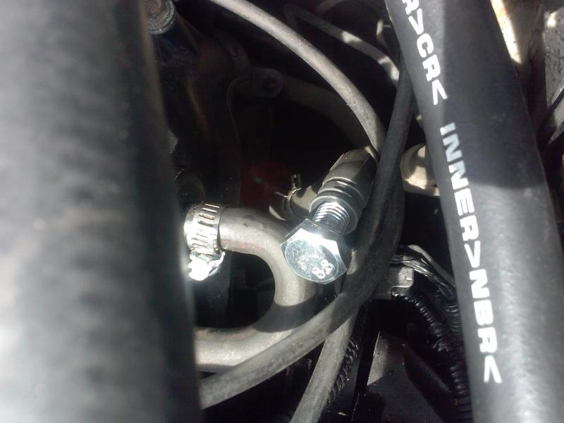

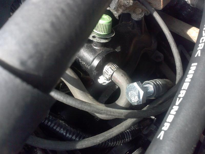

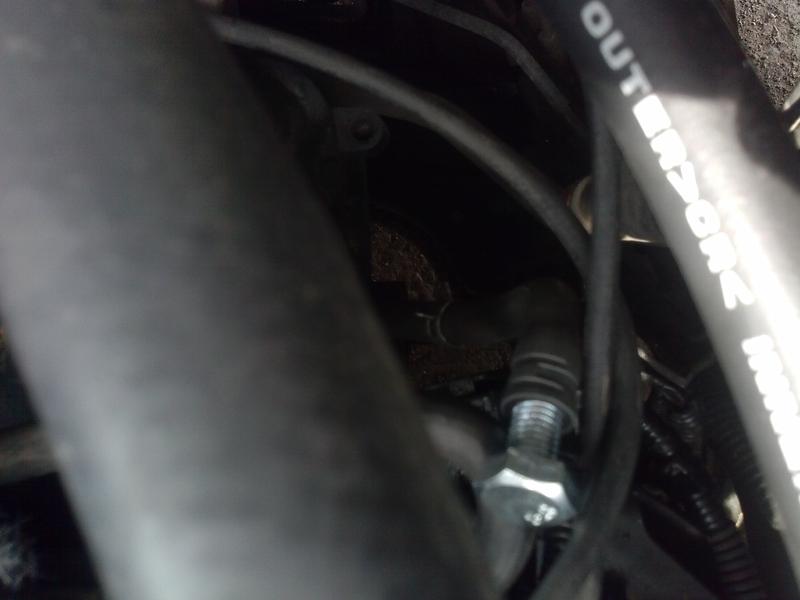

Had daughter go take some pics at shop and attach one on here. The hose with the bolt stuck in the end of it is the one I can't find a place for. Any help would be appreciated as Hondas are new to me.

Hard to tell where that comes from.
Seems like it may go to the PCV valve on the side of the block....See an earlier pic.
Here's some more
I don't have a real 7th gen car here to look at.
