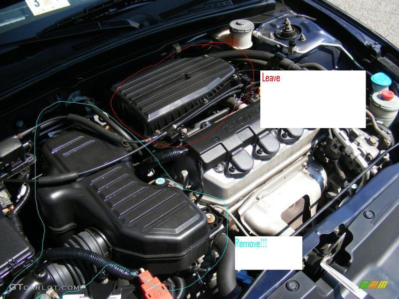

Do some research on intake turbulence. You will learn why the OEM intake is far superior to any aftermarket.

Gonna throw in my pennies and get back to the original question, no not worth the money. SRIs and CAI on our cars really only make them louder and breath a little better. In five minutes you can remove the stock air box and tube and just leave the filter box on the throttle body and get the same effect as a SRI for free. You are then left with a 2.5" opening for air to enter the engine and the engine has a little more noise. Don't believe me? Try it!!

When I did that it droned really loud at highway speeds but it does do the trick!

It'll also have the same flaws as a SRI -- that it draws hot, dirty air from right next to the head. The heat is a good thing when driven in winter... but not where it gets warmer than 70-75 degF.
One of the benefits of the stock resonator setup is that it draws cooler, cleaner air from the front corner, generally away from hot parts and hot air drawn thru the rad... not to mention a bit of extra volume (why it's called a resonator) to help with filling in flat spots in the torque curve, and quieting intake honk. More restrictive, but also more drivable. Less restriction won't get you a lot of power with a speed-density MAP FI system anyway (though it will on the MAF-equipped DOHC Hondas, like the K20s).
I'm wondering why no aftermarket intake maker's taken advantage of the room the missing resonator leaves, to make a larger flat-panel filter box, then running a much larger tube to the same place the stock intake starts, so there's less total intake resistance. Having the filter at the far end of the tube seems like it's the worst place for it... in the stock filter box setup it serves to not only filter, but also to reduce turbulence before entering the TB, just as similar setups do on sportbikes. Probably because it's a lot easier to overprice a cone filter and a bent aluminum tube with some tacked tabs.
Actually... the D17 filter box is setup very much like the old VFR750F and CBR954RR sportbike airboxes, except with one big TB instead of 4 smaller carbs... and a lot less filter area/cc.
