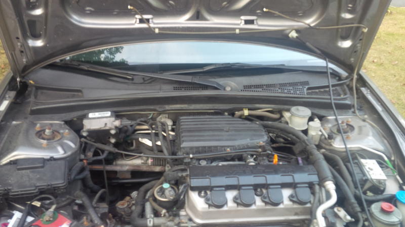

Do you just mean risers to keep the hood open a little? Technically what I have is the equivalent to an sri. I modified the stock intake so it is more like the old muscle car intake. I really am on a tight budget so I am trying to go with effective low budget fixes, not cheap redneckery just inexpensive. Do fender vents work at all or are they just for show really? I took my grill out, and I know it looks bad, but it has cooled down so much. I drove last night and it was like 68 outside and 20 miles later the fender and hood were still cold to the touch, and today 20 miles 75f outside, the hood and fender were cooler then it was outside. Thoughts?
ID:	85671   Click image for larger version

You basically ruined the design of the OEM intake, and now cannot draw any cold air into the engine. You will just suck up hot air. Muscle car filters are designed like that because the engines were carbureted, and many muscle cars had ram air hoods which supplied air directly to the filter.
Your problem is not letting out air.....its that the engine is only sucking in hot air, instead of the cooler air that the OEM intake supplied. I would either re-install the OEM intake, or just buy a cheap eBay cold air intake, and throw on a AEM Dryflow filter.
