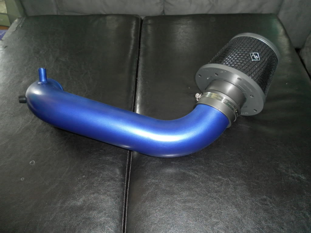

Here is a picture of an intake that I bought in pieces and assembled for around 70 bucks:
Keep your eyes peeled on ebay and this forum. This stuff can be had for cheap: Oh yea it was gray when I bought i ... 8 dollars in paint fixed that up.

I live in northeastern Vermont for the most part it's pretty lax up here but I honestly didn't know the difference between a test pipe and high flow cat now that I have educated myself that's not really an option im interisted in I am no tree hugger either but that just sounds unresponsible. As for the intake that is a nice looking unit you put togather blue! I'll go check prices on that apxei world sport thanks guys I'll keep you posted

Hey blue, please share what you did to get the ram air intake for 70 bucks. I also noticed that you have the weapon R type filter!~~~~ SWEET!~ Please share again how you put your intake together for $70.

It went kind of like this.
I bought the tube off a member on here for around 40 bucks
I bought the filter off another member for 20 bucks
I spent about 5 dollars on a can of paint
I had to buy the rubber couplings to connect it to my throttle body, about 20 bucks on ebay.
Thats it, intake complete.. Then I went to the auto parts store and bought K&N Oil for it for around 11 dollars. I don't count this towards the purchase of the intake because it essentially keeps me from replacing the stock filter all the time
Oops I guess it adds up to 77!
