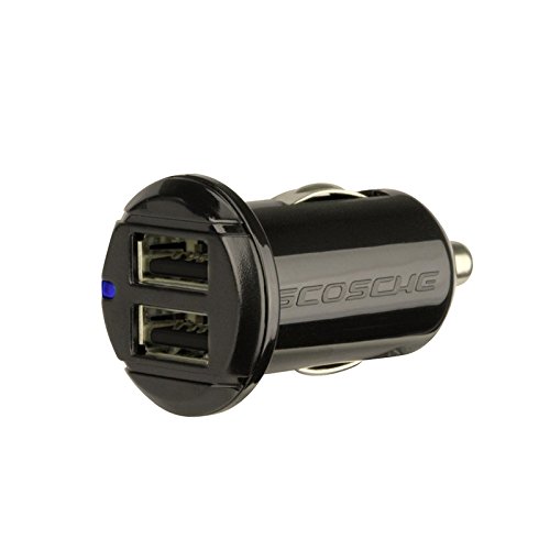

Very clever. I'm wondering if I can just drill a hole and permanently install something like this:
Amazon.com: SCOSCHE USBC242M 12 Watts per port (24W/4.8A total output) USB Car Charger - the FASTEST CHARGE RATE for Apple and Android Devices -  Retail Packaging - Black: Cell Phones & Accessories Amazon.com: SCOSCHE USBC242M 12 Watts per port (24W/4.8A total output) USB Car Charger - the FASTEST CHARGE RATE for Apple and Android Devices - Retail Packaging - Black: Cell Phones & Accessories
