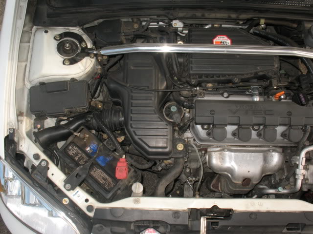

Stock air box. Air inlet is behind battery. really tiny...

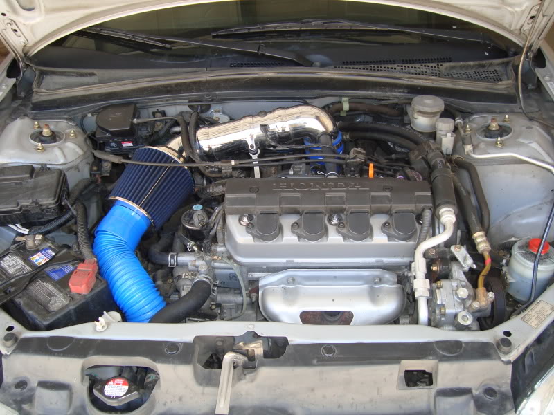

modular Spectre short ram with a duct hose that goes AAAALLLLL the way down to the frame

i honestly forgot what the stock exhaust manifold looked like, thanks. lol

So the tube that's behind and to the left of the battery is where the air goes in?
I don't really get how a SRI would get air if it's inside the engine bay, same for the stock air inlet (at least this one is slightly towards the front, where air can go through).

Yes, the tube behind the battery is where the air goes in. The engine compartment isn't sealed, so there is plenty of air to draw from. You're just not getting the coolest air as the engine get hot. Most of the air comes from under the car anyway. SRI gets it's air the same way, again, just not the coolest air available. CAI just puts the inlet lower to the ground to draw air before it heats up in the engine bay.
