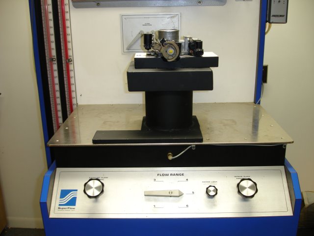

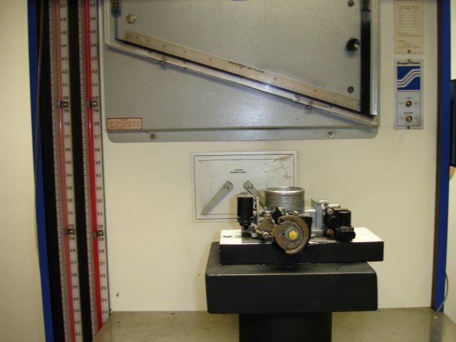

Ok. Figured you guys would like some pics of what we are doing right now. This is a flow bench and we are flow testing the D17's flow capabilities at stock bore.
Base line Flow Test: 28" H2o-502 CFM.
10" H2o-310 CFM
