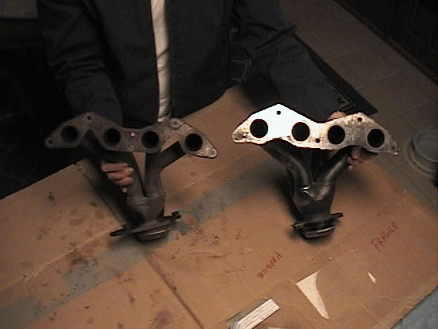

Here are some pictures comparing the HP header with the stock header.
Top view:
Name:	hp header vs stock 1.jpg

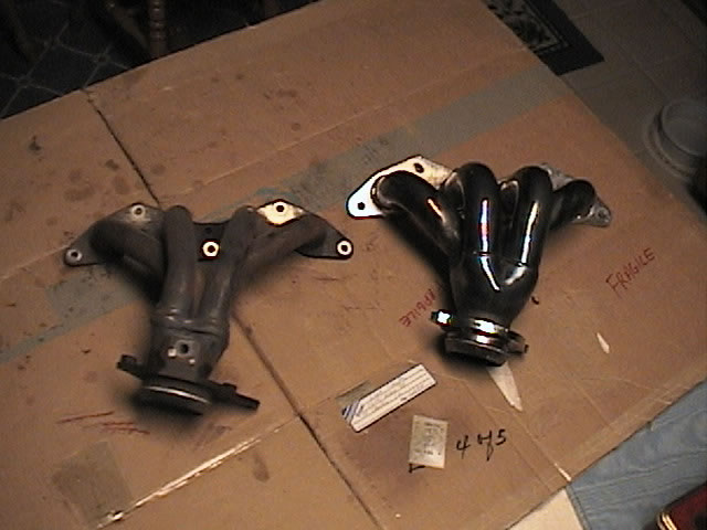

View of the inlets:
Name:	hp header vs stock 2.jpg

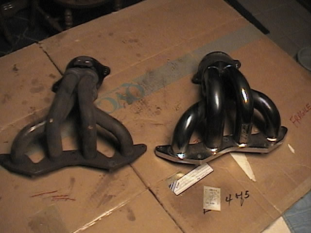

Side view:
(notice how much smoother the bends in the HP header are)
Name:	hp header vs stock 3.jpg

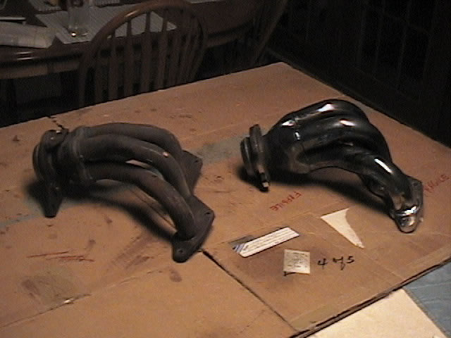

Front view:
(By now you've noticed how much larger the HP tubes are)
Name:	hp header vs stock 4.jpg

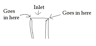

Three more points:
1. The header was used when I got it, that's why it's not all shiny. Not like I care, though... pretty does not equal power.
2. The inlets on the stock header, while smaller than the HP ones, also went in a little bit so the inner diameter of the tubes is smaller than the inlet diameter. See the attached pic for a better explanation. The HP header does not go in like this. Just an observation I thought I'd point out.
3. The HP header is a bit heavier than the stock one.
