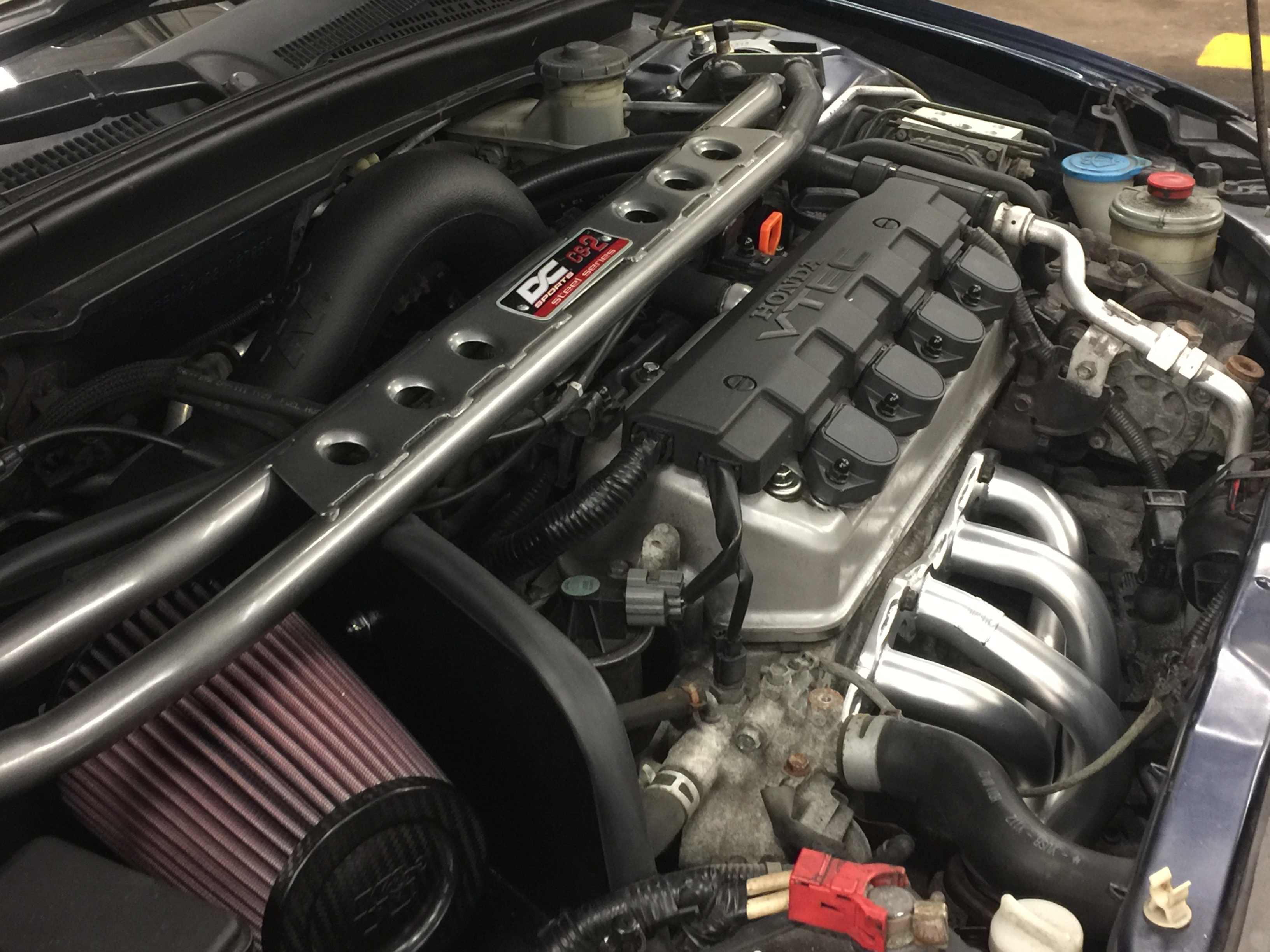

DC Sports 4-1 ceramic header on 2002 EM2 EX.
Name:	DC sports 4-1 ceramic header.png
ID:	89393   Click image for larger version
Name:	DC header installed 2.jpg
