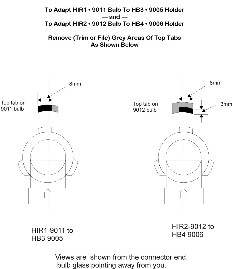

HiR (halogen infrared reflecting) @sdaidoji , not HID
Amazon would probably be your best bet. You'll have to slightly modify the tabs to get them to fit. 9011 if you want them in your high beam, 9012 for your low beam

so then I still have to modify these to make them fit yes?
also I'm having a hard time finding the exact ones i need from amazon...any help would be appreciated.
