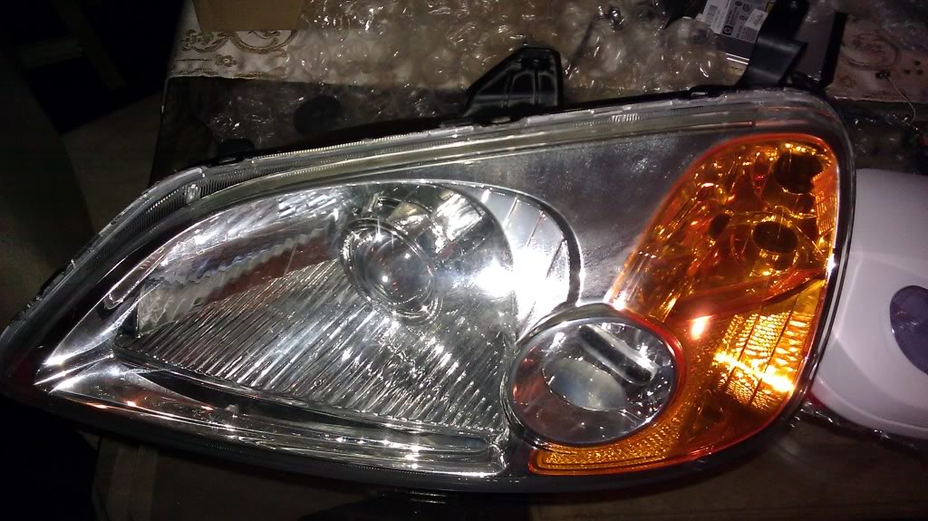

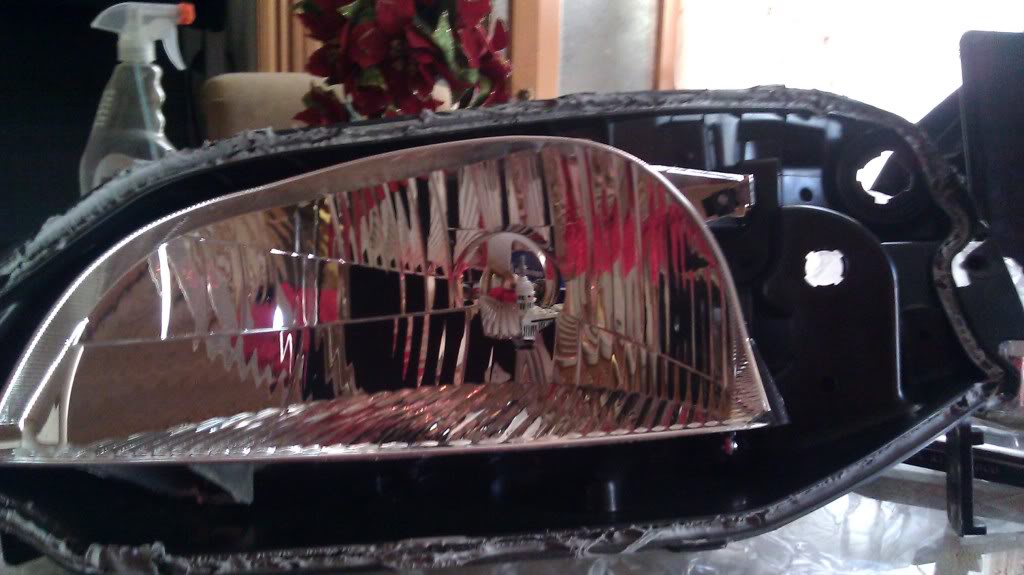

once you have removed that it should look like this
There is two of everything in this pic

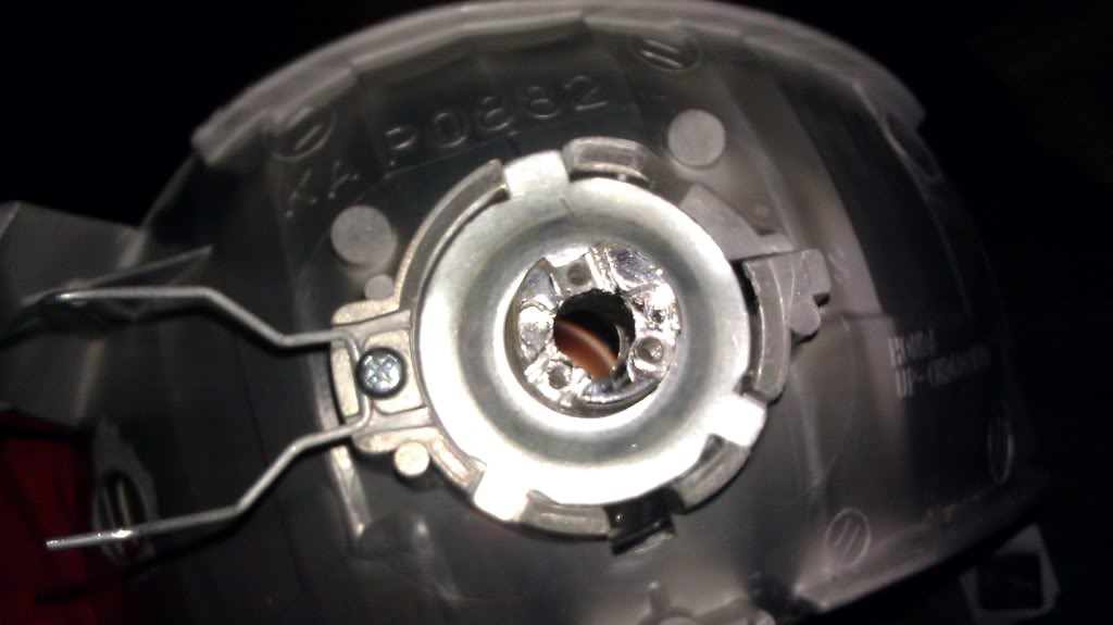

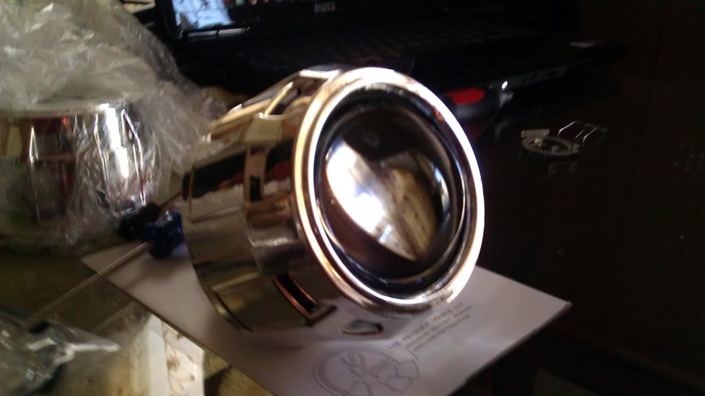

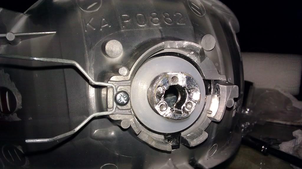

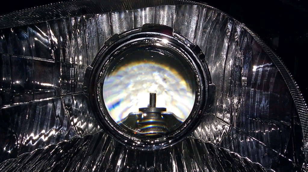

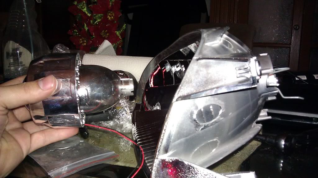

Ok let get started after you take your reflector out of the housing take your projector(this is a good time to put the rubber that came in the package) and insert it in to the h4 opening
remember to make sure the projector is in there right position there are makings on the back to help you out.

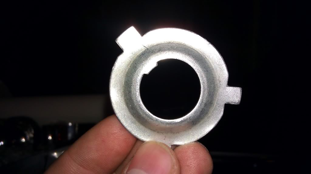

Once you have that come the part i had wrong and took me a bit of time to figure out. You now have to insert the h4 adapter that looks like this.
now again be careful because i you insert this the wrong way its going to be loose and you projector is going to wobble around like mines did. I need to look like this with the little hump facing out
Now your ready to apply the nut that came with the kit. Make sure its tight but do not strip the treating. Make your projector does not move or wobble around. know your projectors should be in the reflector and ready to be put into the housing.

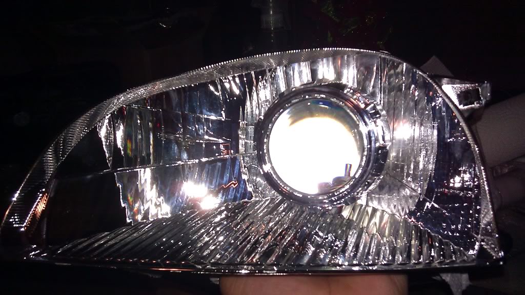

Now put the lens back on the headlight and tight it up and do the oven thing again when you pull it out i should be soft again and then you can push it back in place with ease.

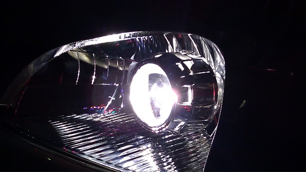

and the light show by just one headlight

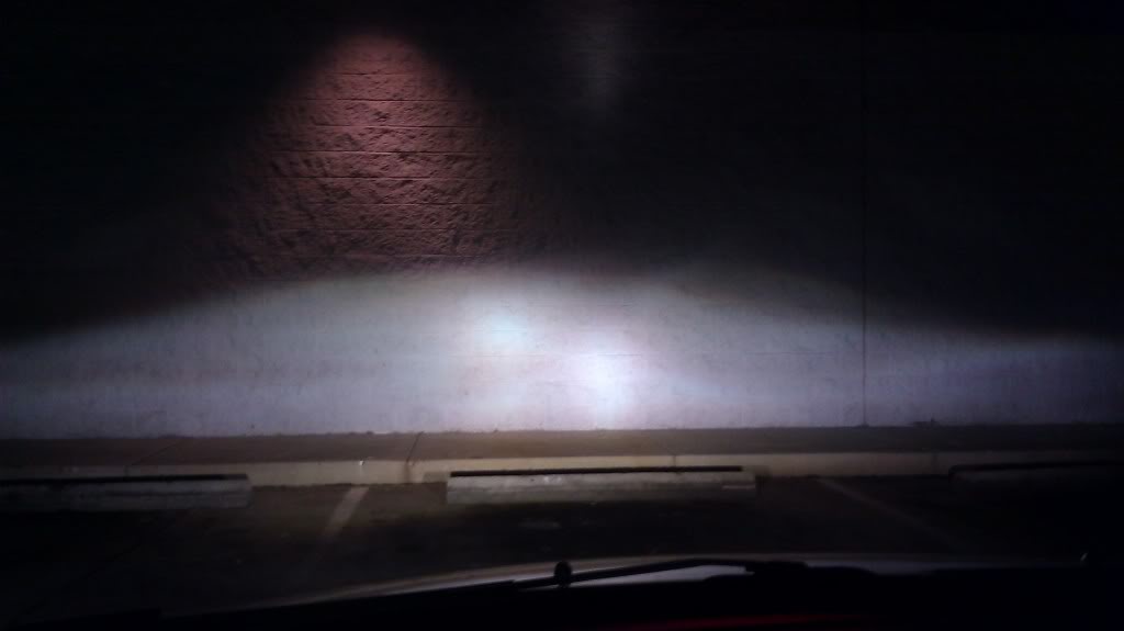

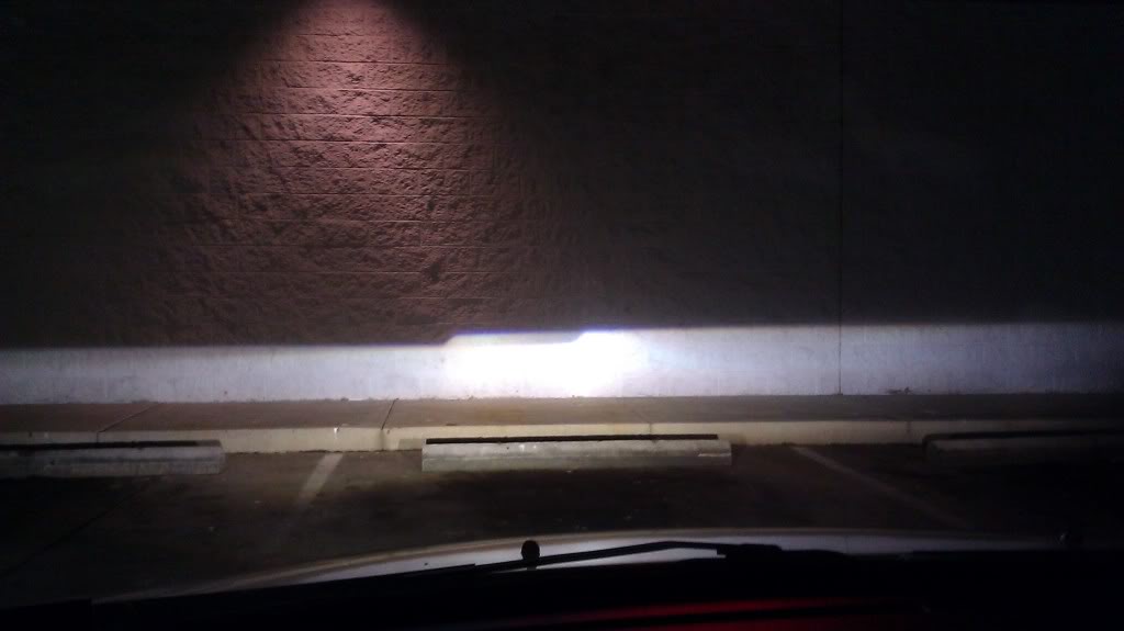

I got to aim the head lights today first time doing it so let me now took measurement like i was suppose to

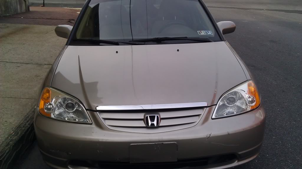

here is how they look on my car
I know need new bumper will do that next week and i was able to get highs just by plug in it in the ddm high ballast with out losing low so don't know but it worked

very nice. aiming looks good but the road test will tell you for sure. if they are shining in ppls mirrors too much on flat road, you may need to lower a bit. the proper aim is a 2 inch drop of the left beam at 25ft. you can use 55w ballasts with these and the projectors will be fine, but the shrouds will most likely melt unless you find a different metal version instead. and to be honest, these are already one of the brightest projectors out there so 55w not really necessary.
Old Dec 11, 2010
Rep Power: 513
Re: Bi-Xenon Morimoto Mini H1 install
man, that looks real nice. Even more motivation to hook my sister's Fit up.
and lol, your car looks like it has some dilated pupils..

well actually i was coming from a hour away just now was able to see about three lanes on each side i was looking at the light off cars in front of me and it was in between most cars bumpers and license plates

i've seen a lot of people black out the reflector when they did retros, i assume so it doesn't glare upward from the bottom, do these not hit the reflector and produce glare? doesn't look like it in the wall pics
p.s. you need to add hid fogs to light up that area right in front of the car
