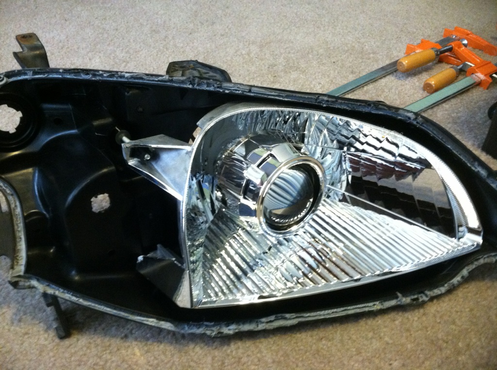

Also, just to show you the difference, the top beam is what you'd be getting with the link you posted (mind you, I bent the crap out of the beam cutoff shield and had to fab up something to pull the projector lens away from the bulb by about 1cm to get that cutoff), bottom beam is a true retrofit.

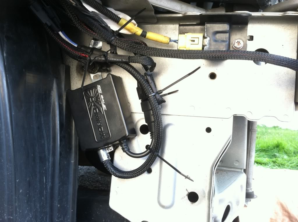

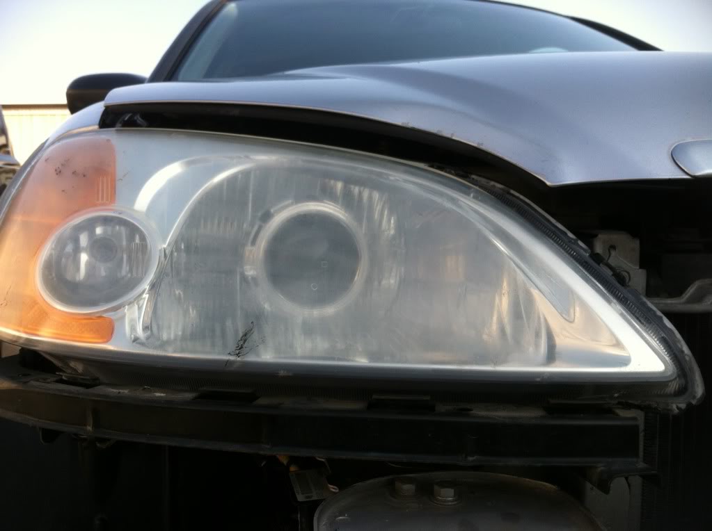

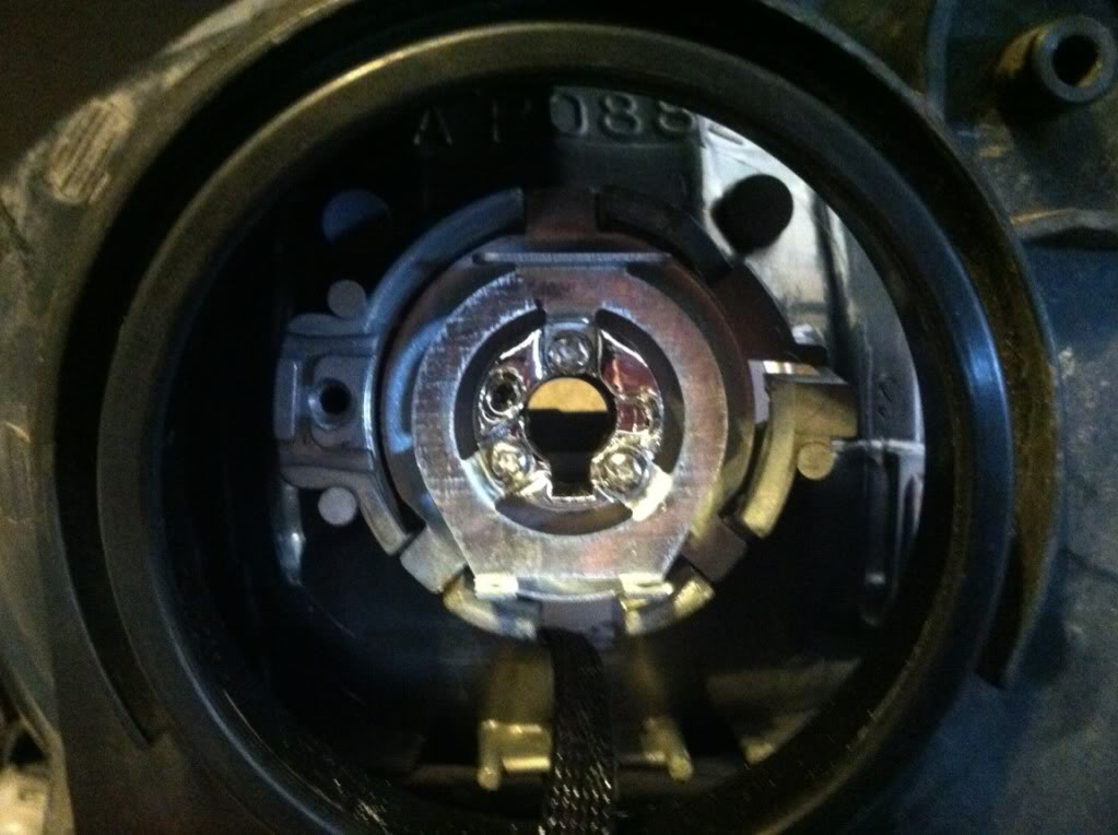

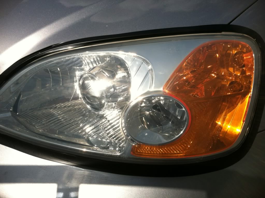

^ Morimoto Mini H1s are direct fit with the adapter rings that are provided. The harness is all plugs that are all labeled to tell you were everything goes. Longest part was finding somewhere to mount the ballasts and running the wires behind the bumper. No electrical skill required. The only thing that really tripped me out was putting the headlights in the oven for 7 minutes, but once you take them out they come apart like butter.
TRS has a complete retro setup, projectors, ballasts, bulbs, relay harness and headlight sealer for $280. You could even go cheaper if you got your HID kit from DDM Tuning and just did the Morimoto projectors. Save your money and research till you find what works best for you. Restoring the headlights and putting in some Sylvania Silver Stars might be all that you need.
Here are some pics from mine. I did a Mini H1 with mini gatling shroud in my OEM 01 headlights:
This was before doing headlight restoration
This is also before headlight restoration
After headlight restoration
Dont have a pic of the output after restoration but it is at least 30% brighter and the cutoff line is a lot better.

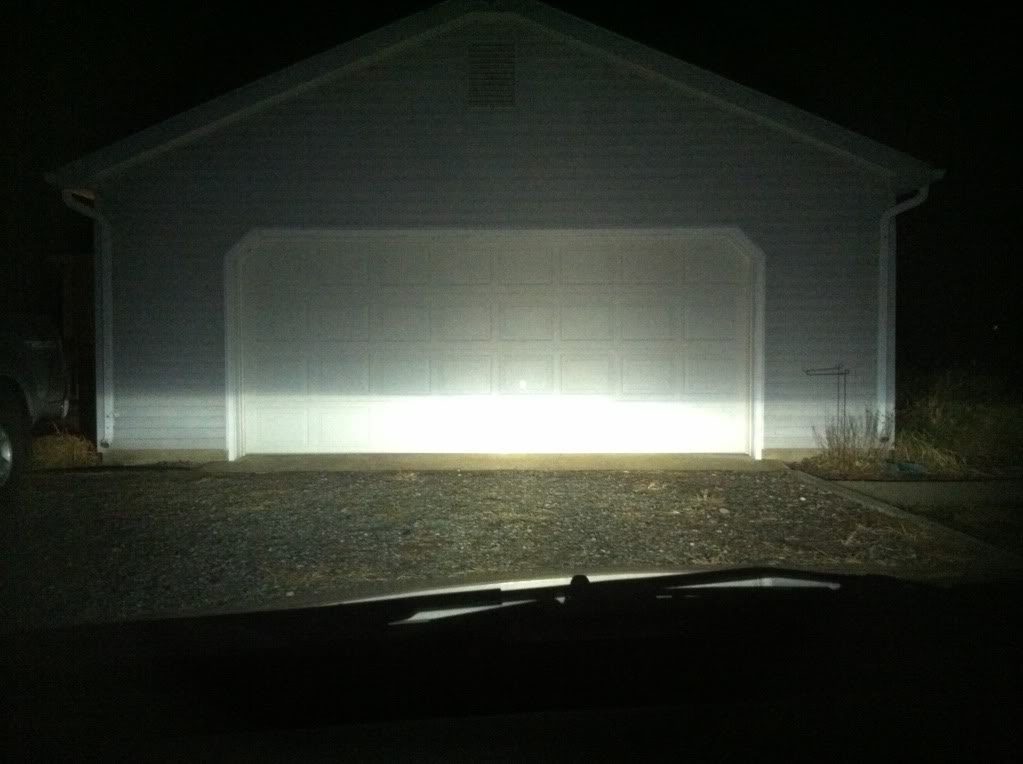

So this is my current light output. It's kinda funny how bad it is. So compared tho this how would the aftermarket headlights I posted compare? I really like the look of them and if they can greatly make the output better by a good amount I want them. Plus I want to order a cold air intake from them too.
So one two last questions. Do I need the canceled and how much light with 6000k compared to 4300k is there. As 6000k looks better
Old Apr 26, 2013
Rep Power: 513
Re: HID Projector headlights in 7th gen
eh.. projectors tend to have a crappier output than stock.. I had a pair of TYC projectors, mostly because I liked the look, and driving in the rain at night was a bit scary, to say the least.. That's just my experience with them though
