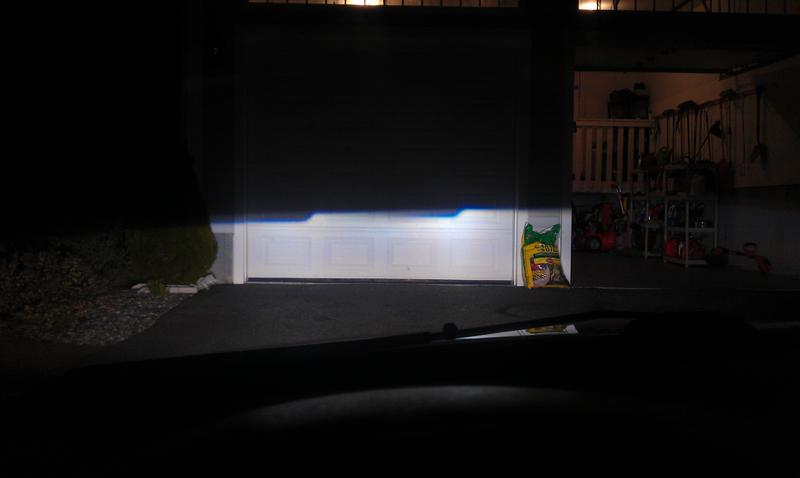

i actually did a retrofit with those same projectors on my 2004 civic. the beam is mint and i suggest 5000k, oci-butyl resealant to reseal the headlights and a relay harness to protect the whole hid assembly.
you need a heat gun and slowly pry off from one side until its all open. its hard and make sure not to pry too hard. once open, put in the projector and screw the shroud. you should get a mini gatling shroud. i tried the large one and it doesnt fit. then stretch the oci-butyl paste thing in the headlight sealant area and heat the part up. once the clear peice is placed back on, squeeze very hard with pliers so you dont get condensation.
im gonna try to get get some pics up

this is before i adjusted them.
Name:	2012-04-19 23.19.41.jpg
