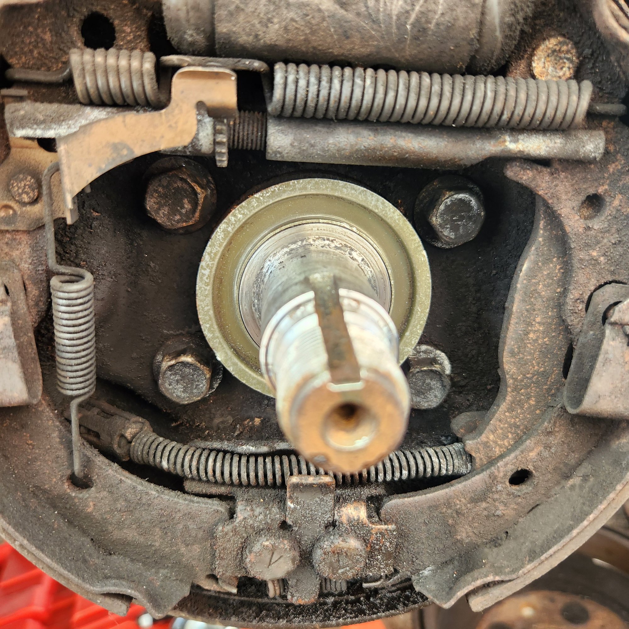

1995 honda civic del sol. Wondering what theTourqe specs on the 4 bolts are? They attach the rear drum brakes to the trailing arm.

The closest thing I have available is the 2000 Civic service manual. Those have a torque spec of 47 lb ft.
