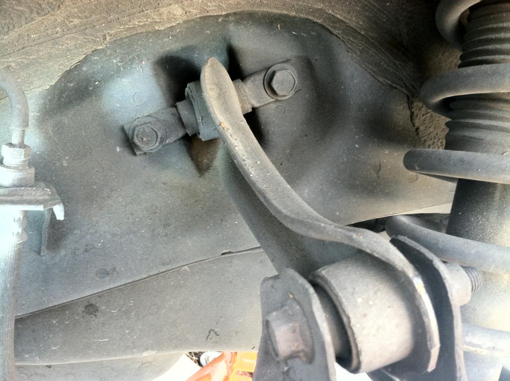

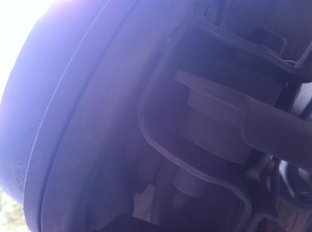

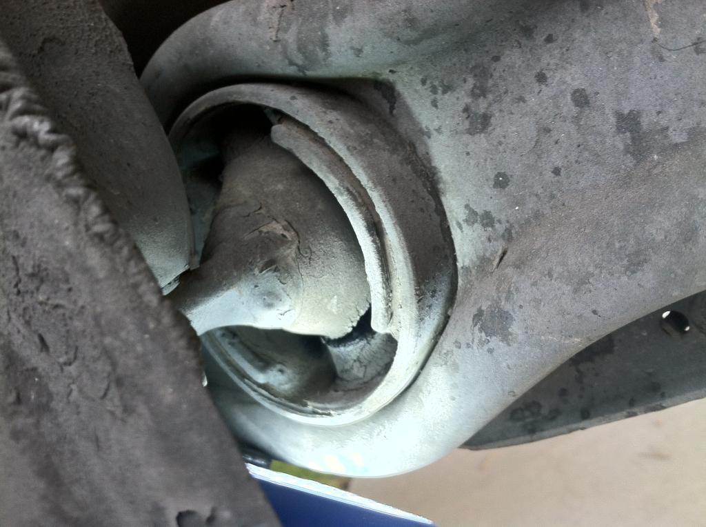

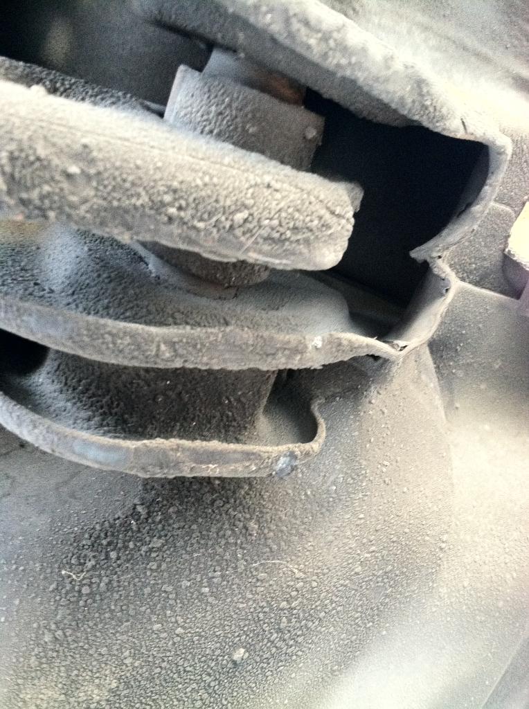

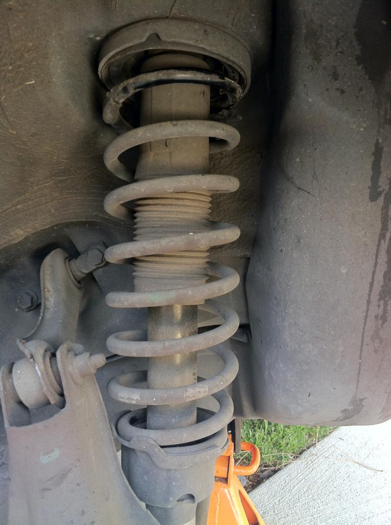

Hi, my 97 civic sits 1.5 inches lower on the left side rear than on the right. I first assumed it is the spring that is bad, but it seems to be intact. Somebody suggested it could be a bad bushing, so I have pictures of all the bushings on the left rear suspension assembly.any advice?

Bottom bushing near brake drum

Size:  148.3 KBbushing on control arm to chassis

Size:  98.6 KBleft rear spring

Size:  119.8 KBrear left camber

did you compare both sides for differences?
it seem you have only one side posted.

The only thing I can see as far as a difference is the upper rear trailing arm bushing, pictured in the last photo that I posted. If this bushing is bad like it looks ripped in the photo, could that be the culprit of my car sitting low? Or is it still the springs?
