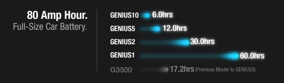

UPDATE: I purchased a battery charger a few days ago and it's still charging it. It may take a few days because it was probably completely dead. The charger recognized the battery though and I confirmed with the manufacturer that charge time can take a while. So stay tuned!

Re: Car Won't Start! - Seeking Advice!
It's a
NOCO NOCO
little charger you just plug into the wall and apparently it's a very slow, trickle charge type device? It's been on the batter five days and running. I disconnected it and hooked up the battery leads and the vehicle did respond. The ignition lights came on, but I didn't want to try and start it because it's probably not close to being done. I had no idea it took that long to charge a battery. Either the battery is jacked or the charger is very misleading how they market it, not sure. I'll test on another battery after a few more days just to be sure it's not a charger defect. I doubt it, I just think it's a trickle charger type device, not a full-scale, powerful charger. I remember those things being pretty big back in the day. Battery chargers I mean.
It doesn’t take 5 days to charge. On the outside, it may take 8-10 hours. That’s on the 12v setting.
From that products webpage....you linked to the Genius1. 1 amp charger would take a very long time, not 5 days though. If it's still hooked up to the car it may not charge at all. Not sure if you removed or unhooked the battery from the car before charging.
