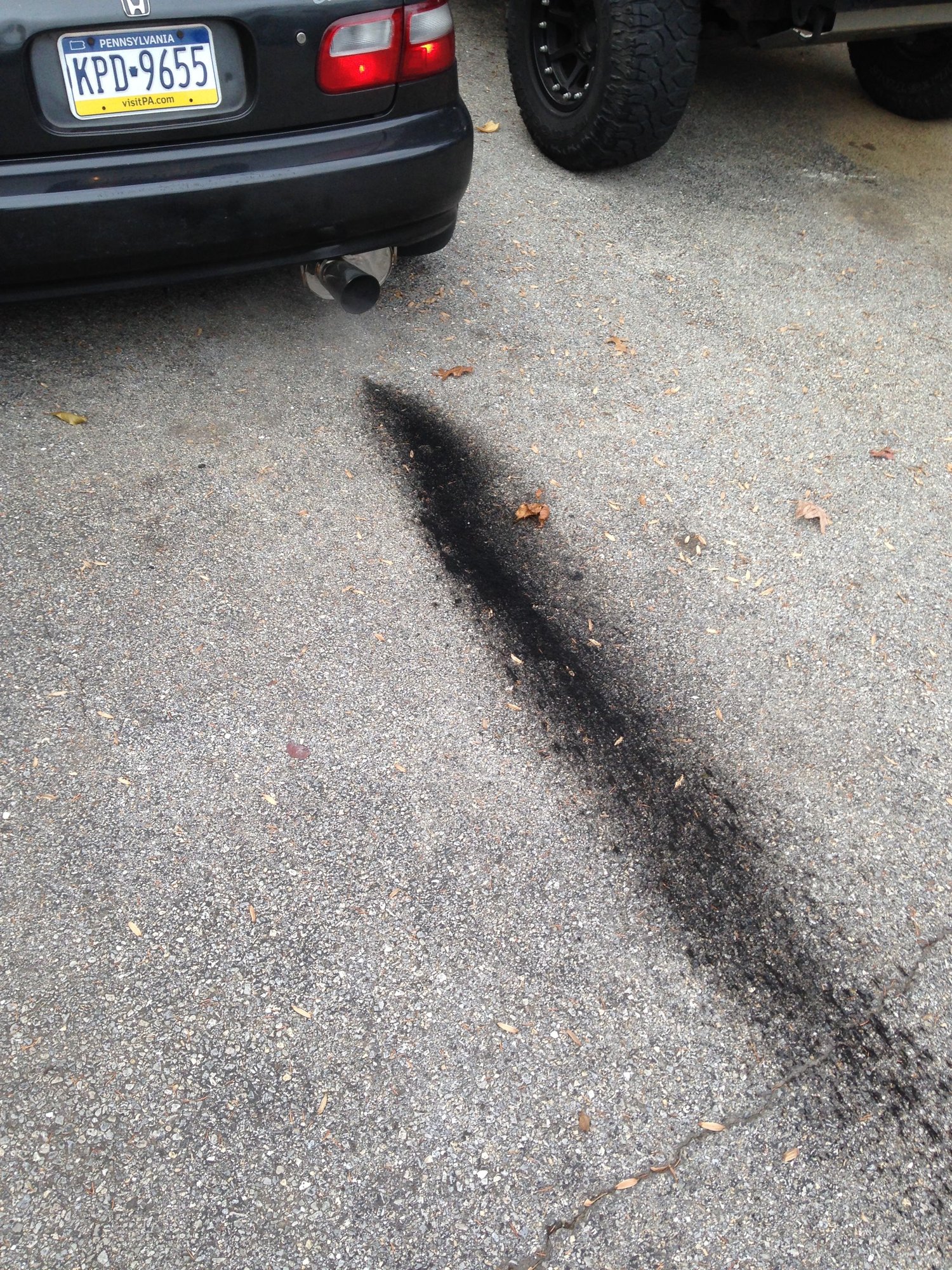

Unfortunately nothing yet, seems like the car wants to run like this more often, especially when im warming up the car from cold. I believe its something to do with the fuel system because the car is spitting black soot out of the exhaust when it runs like this.

That is running ridiculously rich
