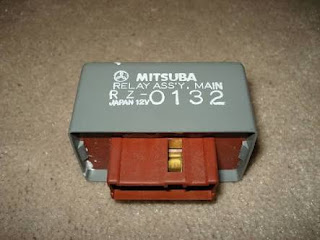

I checked the starter fuse. I checked the power to the starter solenoid. I took the main starter relay out from under the steering column and re soldered all the solder joints.

Also, I just now went to O'Reillys and replaced this RZ-0132
https://1.bp.blogspot.com/-tEe8RxFO5...20/images.jpeg
with this RZ-0159
https://i.ebayimg.com/images/g/o4QAA...3K/s-l1600.jpg
The guy said if the plug fits then it should just work. The car still does not start. I don't know if this new relay would even work.
