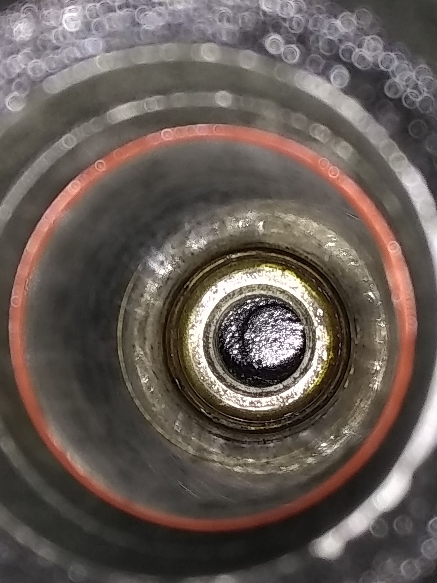

Cylinder 2 normal plug hole.
Cylinder 3 broken spark plug remains in hole.

Actually, it's better than what I initially thought it was: stripped cylinder threads. My dumbass didn't even notice the broken spark plug was still attached in the spark plug wire lead and I just assumed it was stripped head threads. I even purchased a Save-A-Thread kit on Amazon and some high temp red RTV but, I don't need either now. I might keep the thread insert kit though for potential future use. I'm having a bad run on automotive repair between my car and my mom's alignment/tire pull that I ended up putting my foot-in-mouth for.
I've been PM'ing Ezone about it but for some reason couldn't post pics via PM. I injected 150 psi into each cylinder at TDC and no bubbles seen. So, either I did the test wrong (no bubble seen) or I did it right and the headgasket is fine? The radiator cap I ordered online just arrived but I may have a flooding situation and the engine is not running so I have to sort that out first and then drive the car for a few days and see if reservoir overflowing persist.

It's been four days since getting my car back on the road (failed coil) and I no longer see overflow coolant on the ground and no longer see bubbles in coolant reservoir when revving. I may have lucked out with just a rad-cap replacement. I'll keep monitoring it.
