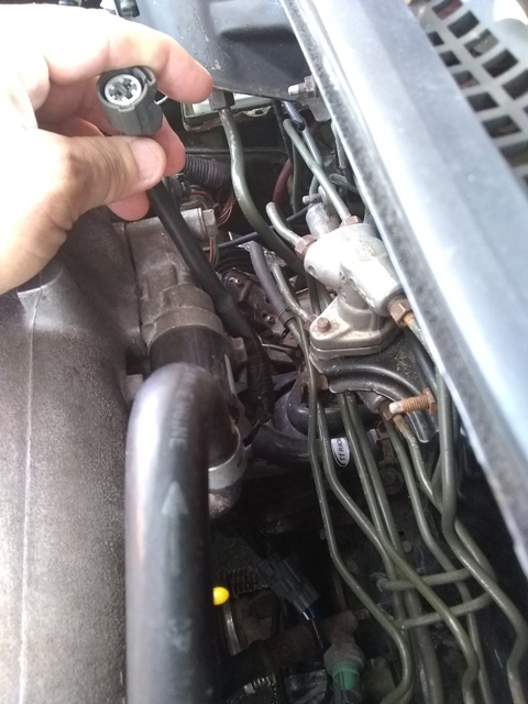

Pic of unused connector ('94-'01 Integra LS harness).
