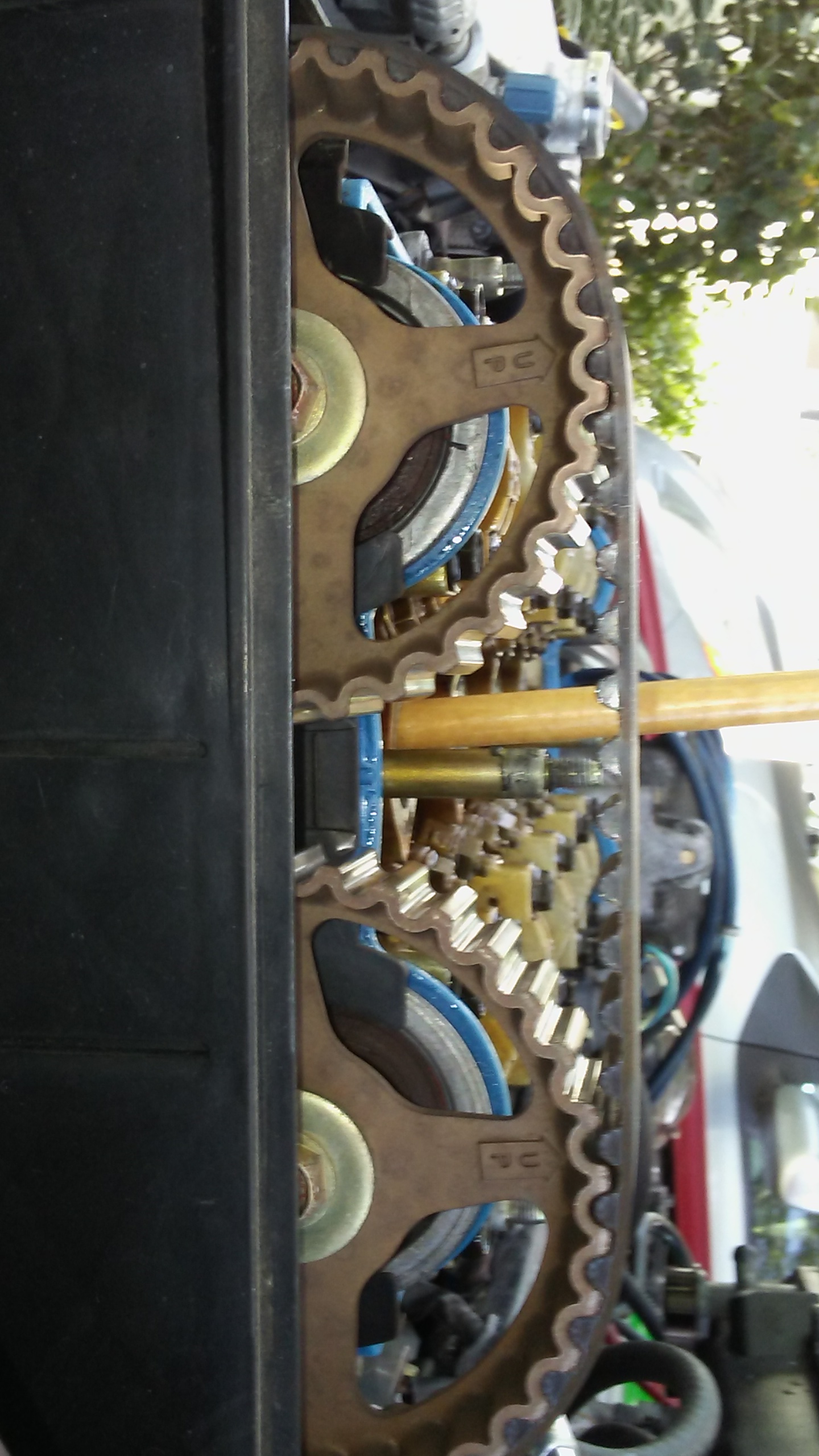

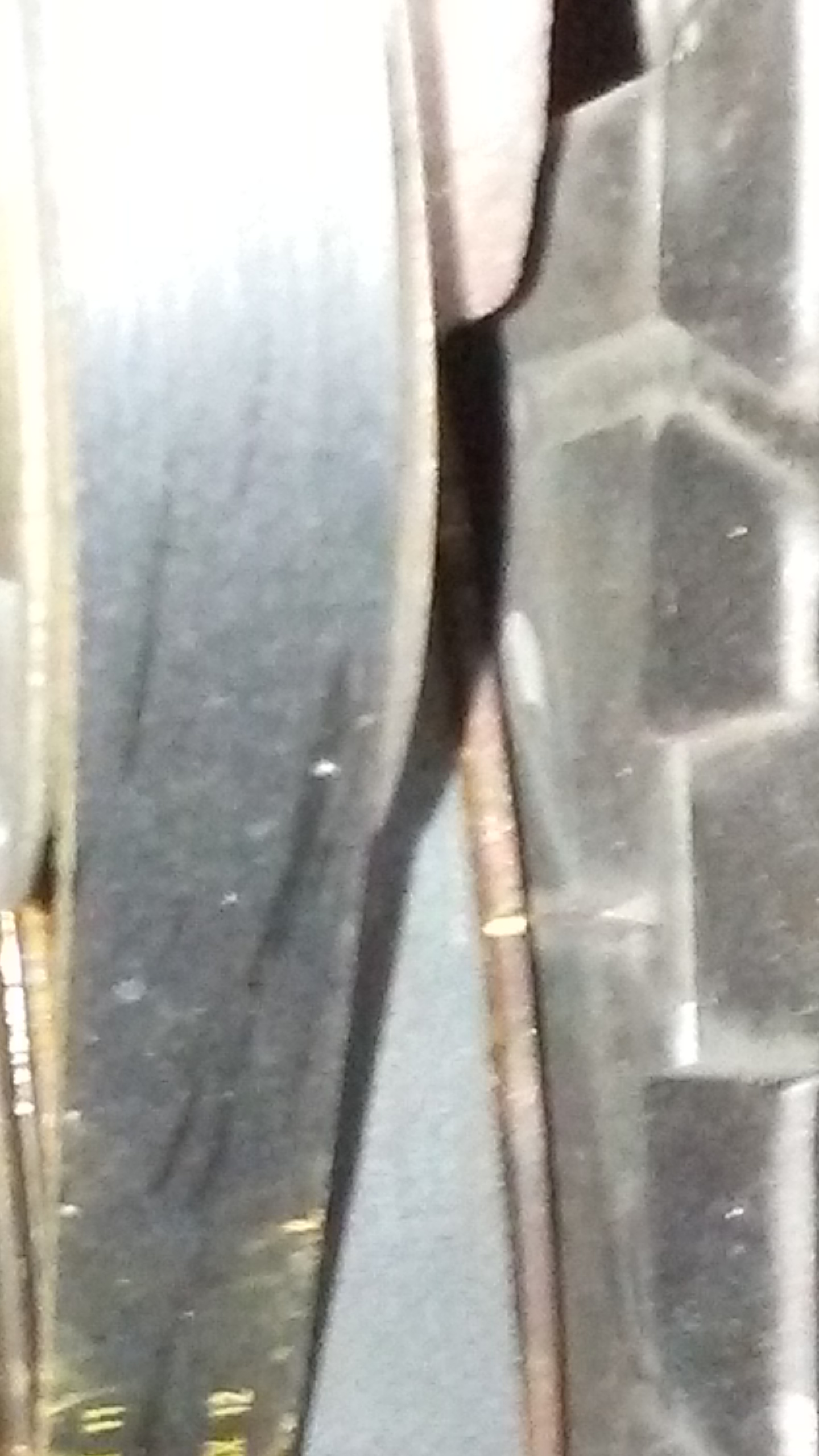

Do you know if there are timing marks on TB cover of a B20?
If I remove the valve cover, set first piston to TDC and both cams are at 12 o'clock position and cam marks face each other is that considered to be properly timed and can assume crank is timed correctly as well?
P.S. shown in video below at 21:00 minute mark:
Old Jul 7, 2017
Re: Oil Pressure Light On
does it require removing TB or just removed screw and use a pick to clean?
I dunno. I just mentioned it.
Crank pulley is normal TDC mark, to view cams marks you may need to remove the upper cover after you get the valve cover off. It's like 2 more bolts or something easy.
Look up how to time a 97-01 CRV engine
Marks should be like this
P.S. shown in video

Thanks for the diagram Ezone.
Mechanical timing seems to be good (pics attached). The exhaust cam may be very slightly off from 12 o'clock position and cam mark is maybe around one to three millimeters up from the top of cylinder head. Intake cam is dead on.
Did a valve lash check and all are in spec. all intakes at .005 All exhausts at .008
You can't adjust millimeters. As long as it's not a tooth out of whack, it's good.
