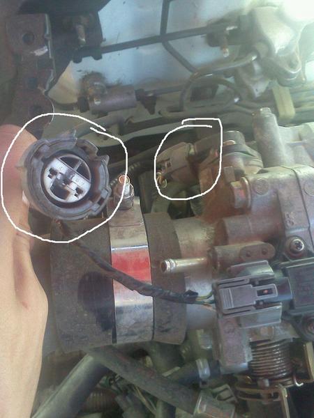

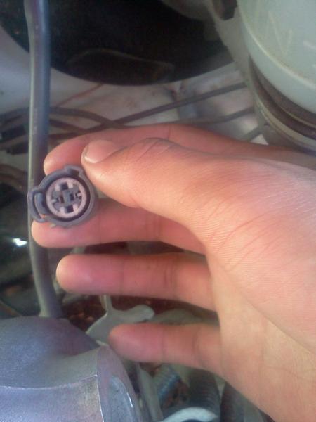

i also found 2 lose wires/connectors behind the air intake at the back of the motor?do you know what they are or where do they go connected to??
theres the picture of the first one it is connected right behind the intake but idk where it goes connected to? the second picture is under the intake ?

The 1st pic, the circle on the right is the TPS. Can't tell if you are holding the connector for that item or not.
2nd pic: The pic of the connector alone tells me nothing. I would need to find out the wire colors and match them up in a wiring diagram to some component.
