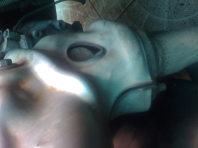

Yes it has one. It looks like a spark plug sticking out of the exhaust.
There wouldn't be a code for it if there was none.

my car is 1994 honda civic esi and i research the google and the engine code is d16z6
this is the photo of my exaust manifold.
