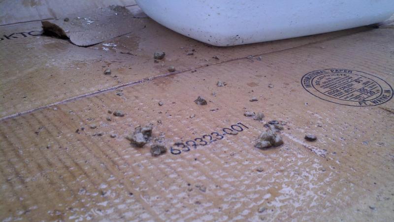

Took me two weeks, had some crap to do on my only days off but it SEEMS like it's resolved.
Ran a garden house out to the street, because it's cheaper to do it myself. Pulled both heater core hoses off, plugged up the holes on the block to stop leakage. I put the garden hose right on the heater control valve and unkinked the hose. Water shot back at me, it was awesome. Almost nothing but a very small drizzle from the other side. I made sure the door was open, seems clogged, yep.
Since I had the OEM jack out, I used one of the crank pieces to lightly insert into the heater control valve and felt a little of resistance at some point while still going in. Pulled it out, weird brown mud looking crap on the end...
I put the hose on the other side of the heater core, held on tight and let it rip. About a second later, brown *** water comes shooting out the valve and I let it go until it was clear (bout 20 seconds) and let it go some more after that. Connected everything up, refilled coolant with anything I might have lost and started it up.
As it gets to temperature, I'm refilling the coolant, heat on blast and I begin to feel the heavenly warmth of the HVAC system. I switched it to cold, hit AC, instantly switched to freezing air (didn't know my AC worked!), switched back to hot, warm air. I switched it back and forth from cabin air to outside air and noticed the cabin air was a little warmer as I've always seen.
Well after the car was running for a little while, cabin was pretty toasty, I noticed the lower radiator hose was still cold (both heater core hoses were warm) which means I need to get to Honda and get me a new thermostat, stat.
Thank you guys much for the help!
